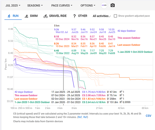

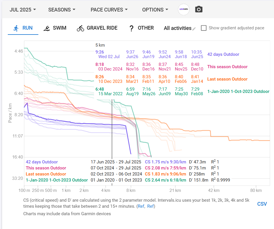

The only way I know how to is to go to the Pace-page and choose All-time for the ‘Pace curves’ and select ‘Show sub-maximal efforts’ under options.
Hope this helps
Here’s an example with Show Submaximal efforts enabled and custom date ranges.

Either do as @cvanklink said, and use the submaximal efforts option, you get to see the pace you held for a said duration, and all 5 best slower efforts for the same duration.

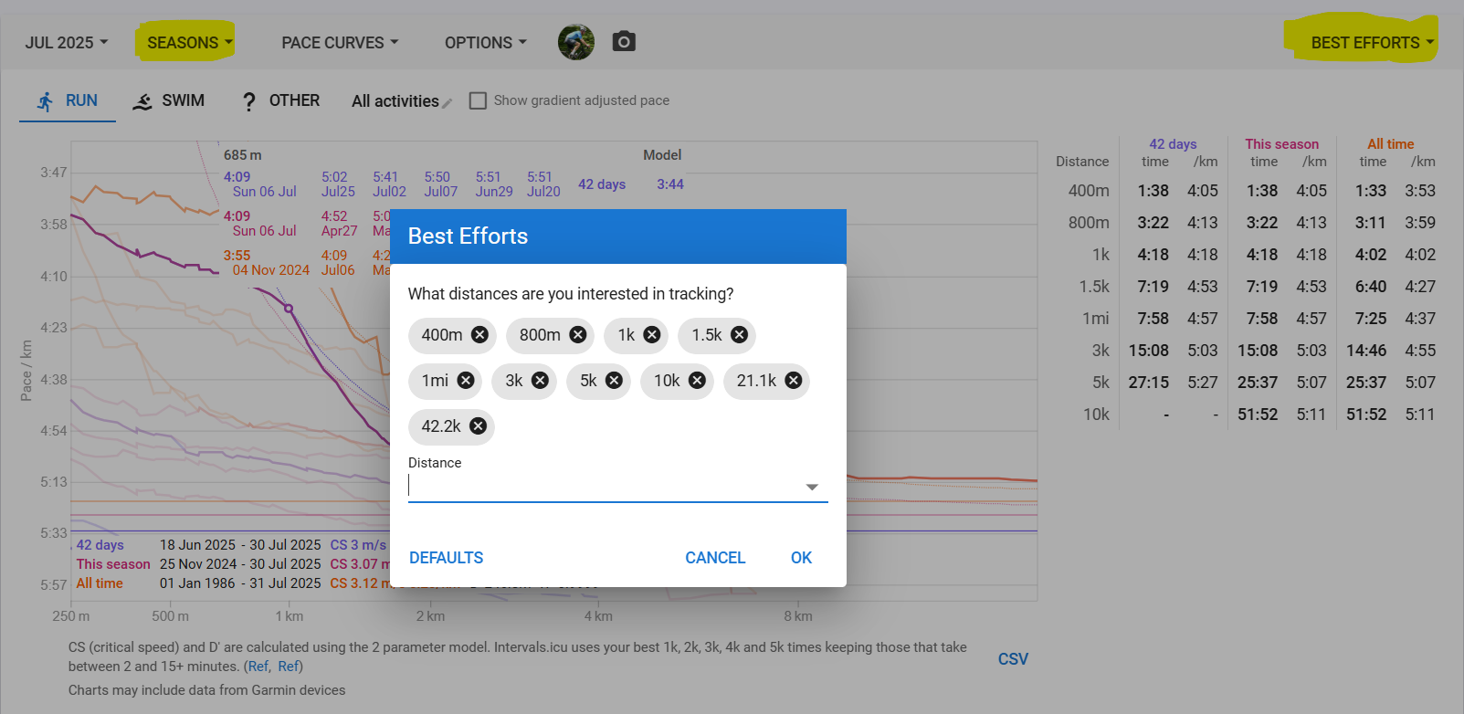

The other option is to use the seasons option. So use the “Best efforts” option in the Pace-menu to set your desired distances. You get your best times displayed in the table next to the graph. Next setup your seasons (this can just be each year), and the graph and table will display your best efforts for each season.

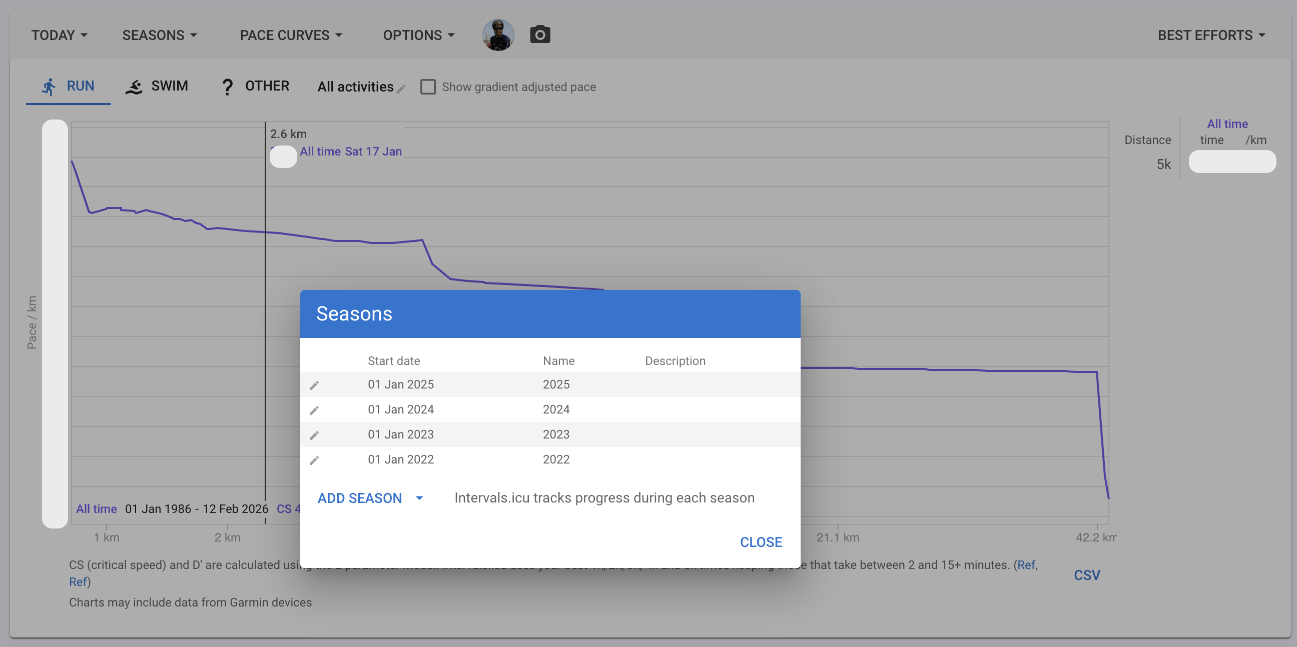

I have tried to implement your guidance, but the issue I have is that I cannot seem to get different lines for each year. I have filtered for 5k, made separate seasons, selected “All time” in Pace Curves, but it just shows the one line (see screenshot below).
I have also tried:
  • All different combinations of changing “TODAY” to try and cover more periods etc.
  • Have tried to make custom date ranges in “PACE CURVES” but that only shows 2 periods at the time (even though I made 10 custom periods for 2015 - 2025)
