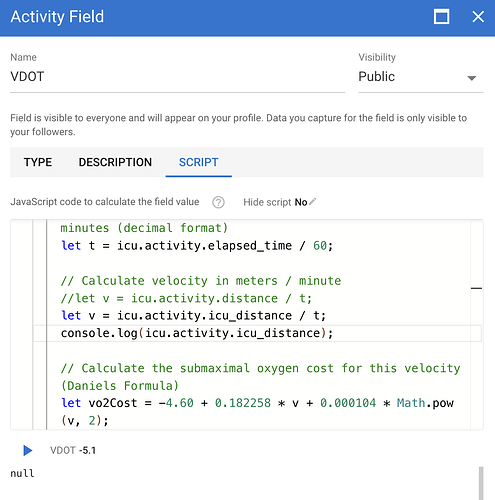

@R2Tom thanks for the suggestion! I tried it on three recent runs and two had ‘null’ values for icu.activity.icu_distance and, therefore, calculated an incorrect VDOT. Might be an artifact of these runs having already been uploaded to Intervals. Also not sure if it matters if the activities game straight to Intervals from the original platform (eg Garmin) or via Strava. Thoughts?
Sure, you didn’t have a typo?
Checked on a recent walk from Garmin, and it has the field icu_distance
But may be that this doesn’t exist for Strava ones, this post may suggest something like this
Yes, I double checked to ensure I didn’t have a type-o. Using console.log to show icu_distance resulted in ‘null’.
Where do I go to see the data fields like you screen captured above?
I use this script to show all activity fields
sl=icu.activity;
for (const property in sl) {
  console.log(\`${property}: ${sl\[property\]}\`);
So, I think more and more to use distance for Strava activities and icu_distance for non Strava ones.
Thanks! I was thinking the same … will need to work on it this afternoon. Thanks for the help!!

Thanks @pepe , sliding window is definitely the way to go. I updated with that important change.
  const valid = new Set(['Run', 'Virtual Run']);
  if (!valid.has(activity.type)) {
    null;
  } else {
    const times = icu.streams.time;
    const dists = icu.streams.distance;
    const intervals = icu.activity.icu_intervals || [];
    const ZONE_THRESHOLD = 4;
    const MIN_WORK_SECONDS = 360; // 6 min minimum total qualifying effort
    const MIN_WINDOW = 180;       // 3 min minimum single search window
    const MAX_WINDOW = 5400;      // 90 min cap
    const STEP_SEC = 15;
    let result = 0;
    if (times && dists && times.length === dists.length && times.length > 1) {
      // 1. Zone >=4 intervals, merged into contiguous "work blocks"
      let qualifying = intervals.filter(iv =>
        iv.zone != null && iv.zone >= ZONE_THRESHOLD &&
        iv.start_index != null && iv.end_index != null &&
        iv.end_index > iv.start_index
      qualifying.sort((a, b) => a.start_index - b.start_index);
      let blocks = [];
      for (let iv of qualifying) {
        let last = blocks[blocks.length - 1];
        if (last && iv.start_index <= last.end_index) {
          last.end_index = Math.max(last.end_index, iv.end_index);
        } else {
          blocks.push({ start_index: iv.start_index, end_index: iv.end_index });
      // 2. Sliding-window best-effort search within each block only
      let vdotSum = 0;
      let weightSum = 0;
      for (let block of blocks) {
        let s = block.start_index;
        let e = Math.min(block.end_index, times.length - 1);
        if (e <= s) continue;
        let blockDuration = times[e] - times[s];
        if (blockDuration < MIN_WINDOW) continue;
        let maxWindow = Math.min(blockDuration, MAX_WINDOW);
        let bestVdot = null;
        let bestWindow = 0;
        for (let windowSec = MIN_WINDOW; windowSec <= maxWindow; windowSec += STEP_SEC) {
          let tMinutes = windowSec / 60;
          let percentVO2max = 0.8
            + 0.1894393 * Math.exp(-0.012778 * tMinutes)
            + 0.2989558 * Math.exp(-0.1932605 * tMinutes);
          let rightIdx = s;
          for (let i = s; i <= e; i++) {
            let tEnd = times[i] + windowSec;
            if (tEnd > times[e]) break;
            while (rightIdx <= e && times[rightIdx] < tEnd) rightIdx++;
            let distDiff = dists[rightIdx] - dists[i];
            if (distDiff > 0) {
              let v = (distDiff / windowSec) * 60; // meters/min
              let vo2Cost = -4.60 + 0.182258 * v + 0.000104 * v * v;
              let vdot = vo2Cost / percentVO2max;
              if (bestVdot === null || vdot > bestVdot) {
                bestVdot = vdot;
                bestWindow = windowSec;
        if (bestVdot !== null) {
          vdotSum += bestVdot * bestWindow;
          weightSum += bestWindow;
      if (weightSum >= MIN_WORK_SECONDS) {
        result = Math.round((vdotSum / weightSum) * 10) / 10;
    result;
bTW I reviewed with Claude, watch these points when I shared your script:
Fixed their bug: streams are accessed as icu.streams.time / icu.streams.distance, not a bare streams global.
Kept the zone gate: still only looks at zone >= 4 segments, merged into contiguous “blocks” — this is what stops an easy run’s downhill km or GPS noise from producing a fake VDOT, which their version had no defense against.
Replaced the fixed-interval average with a sliding-window best-effort search inside each block: instead of using each 1km auto-lap’s average pace, it now searches all window lengths (3–90 min, 15s steps) within the block and finds the fastest sustained sub-effort — closer to true best-effort methodology, and immune to auto-lap boundaries cutting a rep at an awkward point.
Duration-weighted average across blocks using each block’s best-window length, same principle as before (keeps each block’s real duration honest rather than stitching blocks together).
6-minute minimum total qualifying time, same as before, to avoid firing on trivial/noisy zone-4 blips
Great you corrected you script. But:
Tried your script and got: Memory limit exceeded
Declaring local letvariables inside a nested loop running up to 390,000+ times creates millions of temporary variable allocations
While mine script VDOT 54.2
Check my script how to minimize total number of inner loop iterations
