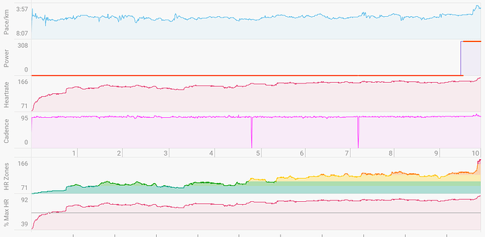

Runs missing load, power

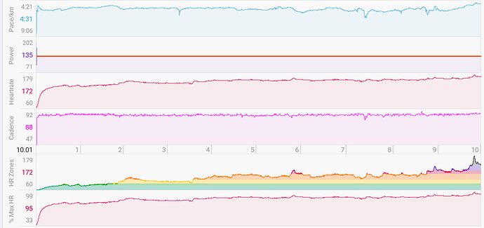

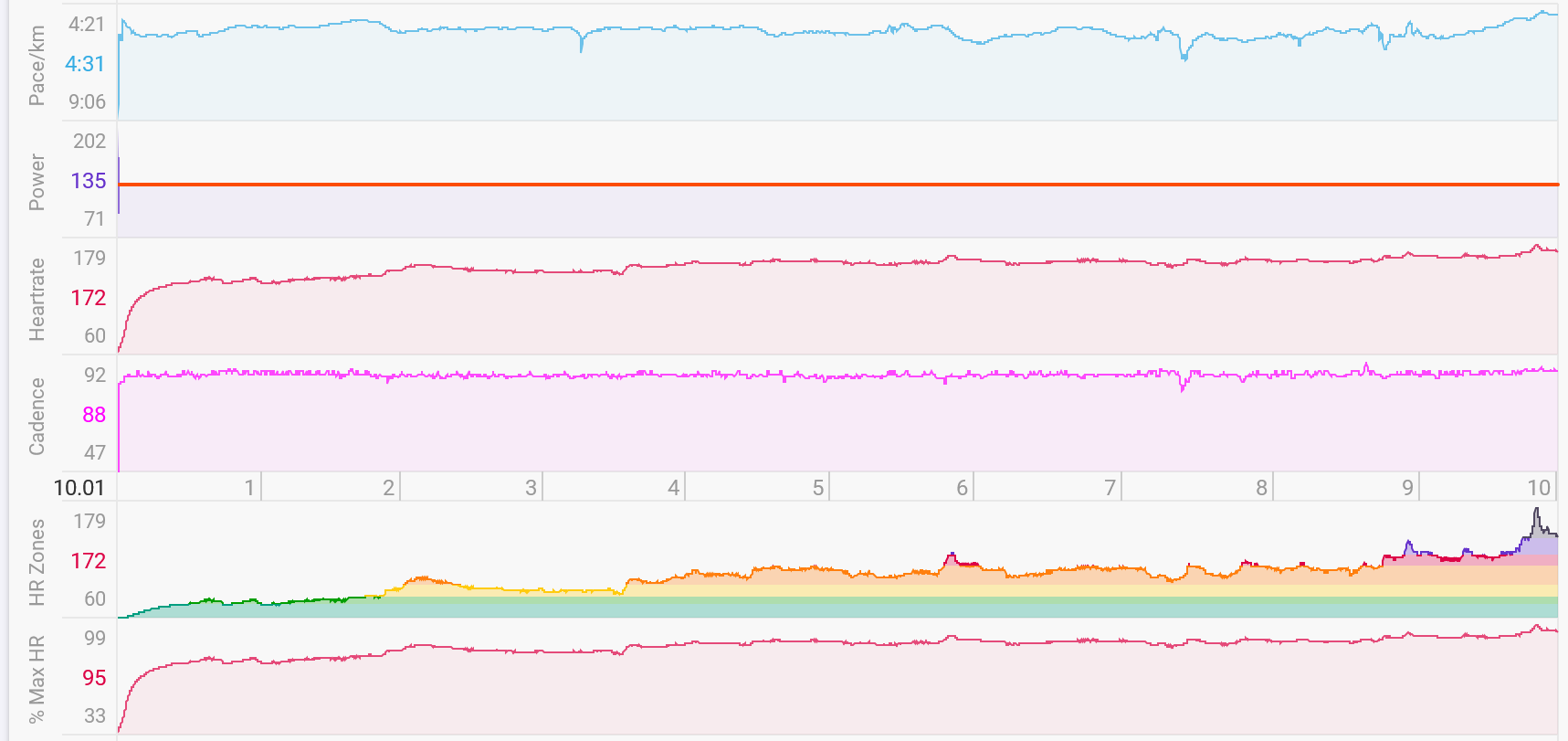

Some of these runs don’t have load. The ones that do, the power is straight across or stepped:
Even when there is load, my 10km runs should be roughly the same load, but I see 35, 37, then 145. A 12km run is shown as 40 load!
My run activity in my Garmin watch has power enabled and I see power in Garmin for these runs:

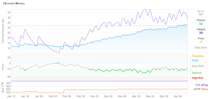

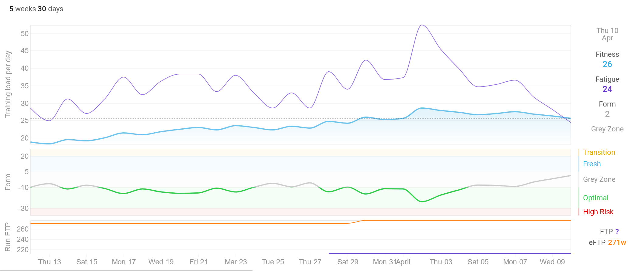

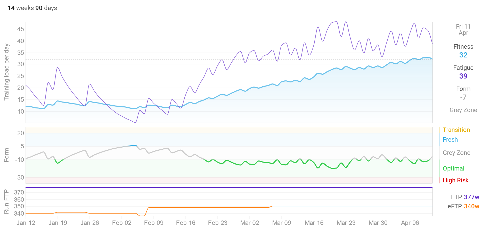

I really like the fitness graph, but now it’s showing my fatigue has fallen recently when I know that’s not true. Yesterday I ran 10km and the fatigue only went down. It shows me as almost fresh, but I hurt a lot! :smiley:
Any ideas why this happens? I’d love to be able to trust the fitness graph, but now I wonder how many previous activities aren’t affecting it.

Tried fix data, with all checked, says no data points were changed. Tried reprocess file, same result. Tried settings > ignore power data, then I got load 59 instead of ?. I guess that’s something, but I hope I don’t need to do that for every run.
The horizontal red line across your power indicates that it’s being clipped; you should see a message above your graphs saying “Power spikes of XX% or more above FTP based power curve have been fixed.” This means that your FTP likely isn’t set properly, if your whole exercise looks like this.
You can see the full data by adding the “Raw Power” chart, to confirm that this is the issue.
To fix, you’ll need to set your running FTP in your settings correctly. You can also loosen the restrictions by clicking that message, and changing the value for the power spike correction to something large, like 999%; if you do this, it should give you a new estimated FTP value that you can plug into the settings, if you don’t have a value from other source (like your watch).
Edit: To go back and fix your historical data, you can recognize which activities have been clipped in this way by the red circular icon with the lightning bolt visible on the activities in your screenshot.

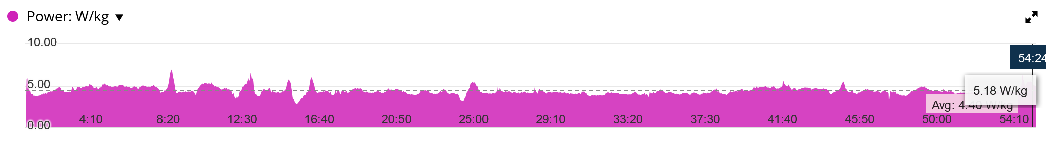

Lasr screenshot shows a run FTP set around 270. Garmin data shows that you´re mostly over 5W/kg.
Chances are that your FTP is set too low. Post just above perfectly explains what to do.

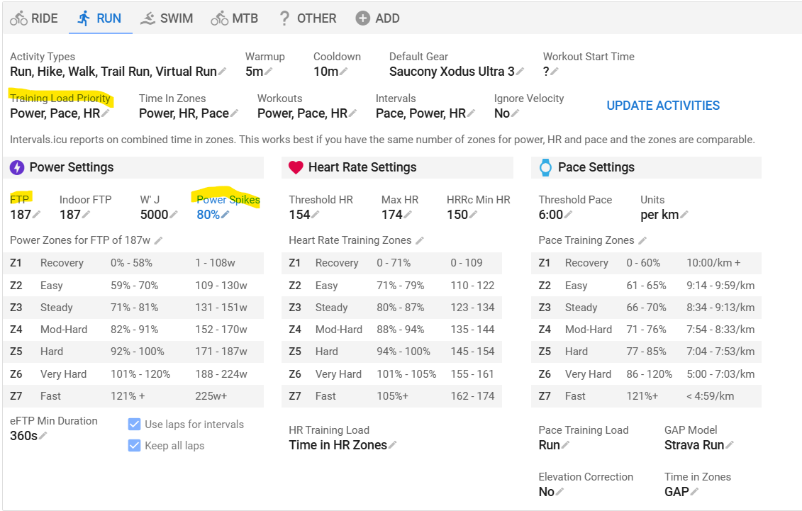

By ignoring Power, Intervals will use the next priority for load calculation. Depending on your settings, that can be Pace or HR.

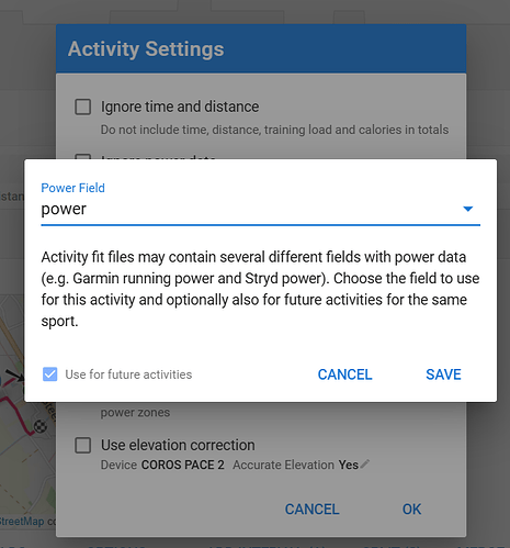

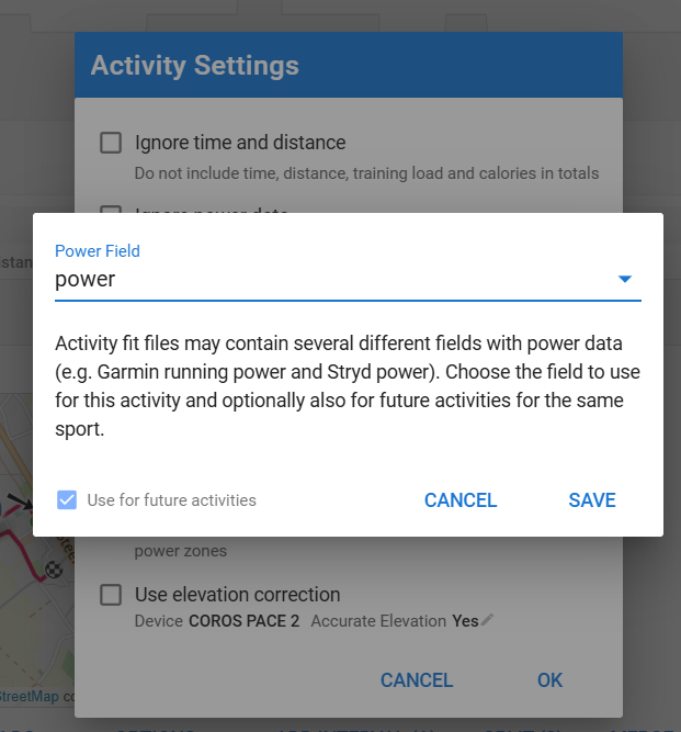

If you have Stryd or other second power on your watch next to wrist power, make sure to select which Power stream you want Intervals to use as default. Actions Settings:

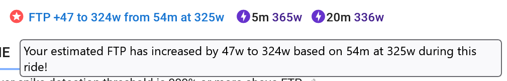

With 999% power spike correction I see:
Funny it says “ride” but cool it gives me a number. This is my first time encountering FTP but I’m happy to learn and I’ve now read up a little bit.

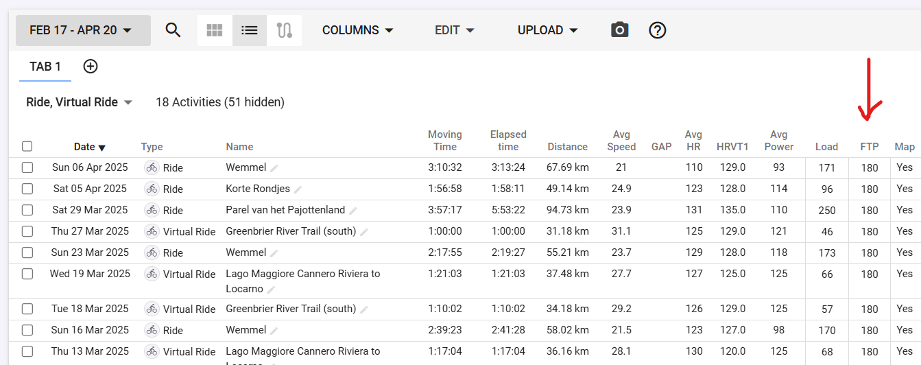

You can edit FTP on past activities in bulk from the activities list view. On the activities page, select this middle icon to switch to list view:
Make sure the time range in the upper left is enough to contain all of the activities you want to change. You can use the dropdown that says “All activities” by default to further filter your activities if you need to (choose “Add” to add a field to filter by, then you can choose options for that field).
Check the boxes to the left of each activity you would like to edit (or the checkbox at the top of that column to select all visible activities), and select “Edit” from the “EDIT” dropdown menu on the top bar. In the window that comes up, you can enter a new FTP, and it will apply that to all selected activities when you hit OK.

This is how I’m looking now:
There is an automated value that intervals generates called eFTP (estimated FTP); you can see this value from your Power page. Intervals will also alert you on an activity when your eFTP goes above your FTP (like it did when you changed your spike correction earlier) to alert you that you may want to change your FTP in your settings.

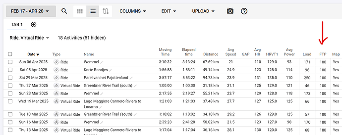

A new entry for FTP on an activity in the past, will be used for all consecutive activities thereafter, untill you enter another FTP. That´s how FTP history is used.
On the Activity List view, you can visualize the FTP column to check out the FTP used for that activity. And you can manually edit it there to if you want. That’s ok for a single activity but for bulk, better use the procedure explained above.
