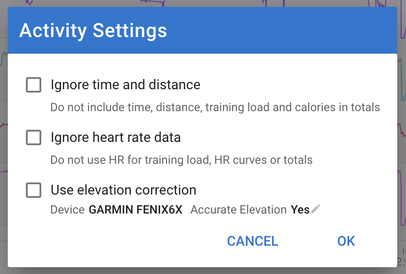

Aha. I may have updated the db to indicate that the Garmin Fenix 6X has accurate altitude around the end of the year.
Your Jan 2nd run has elevation correction off (Actions → Settings):
Your 30th Dec run has elevation correction on.

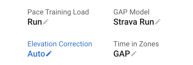

Supposedly the altitude data from your watch is good and likely better than the corrected elevation data so you should probably keep elevation correction on “Auto” (check “Pace settings” for “Run” in /settings):

I just want to check… For elevation correction.
Can the “Accurate Elevation” option be used as a “from this day onwards”?
Reason I ask is that somehow Garmin watches have a tendency to have their internal barometer being spoilt after some time (i’ve had to warranty mine 2x - then the last It died out of warranty) and activities uploaded still uses the internal barometer data anyhow and you have to manually change this each and every time in Garmin Connect (and strava I think)
That setting in /settings only applies to new activities. So for your use-case you can just set it to “Yes” and elevation correction will be done regardless of the watch.
Oh I see, thanks David! Yes, seems to be working fine now :slight_smile:
