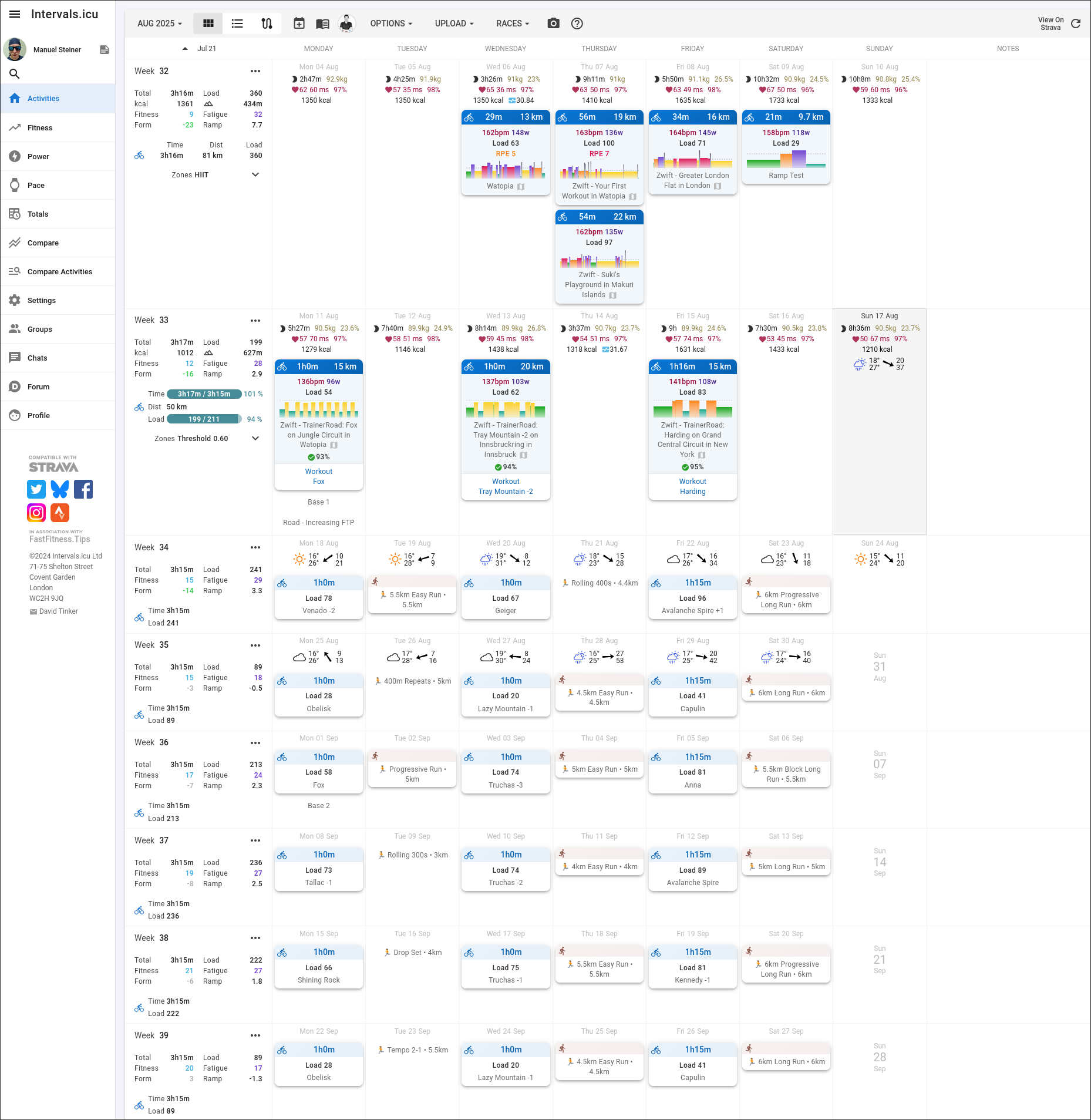

when I import an external calender (Runna running plan), most of the events correctly show as running events. However, some (weirdly seems to be the same weekday although the first of these works) shows up as being categorised as Note.
I have attached a screenshot. The run on Tuesday 19 August is categorised correctly but the following one on 26 August as well as all the ones from 09 September onward are incorrectly displayed.
I have tried refreshing the calendar and switching “Events are workouts” off and back on, which does not change the behaviour.
Any help would be appreciated. Thank you.
There is no “Run” in the description, so it’s not recognised as run.
Oh, thank you! I didn’t think about that. Makes sense.
