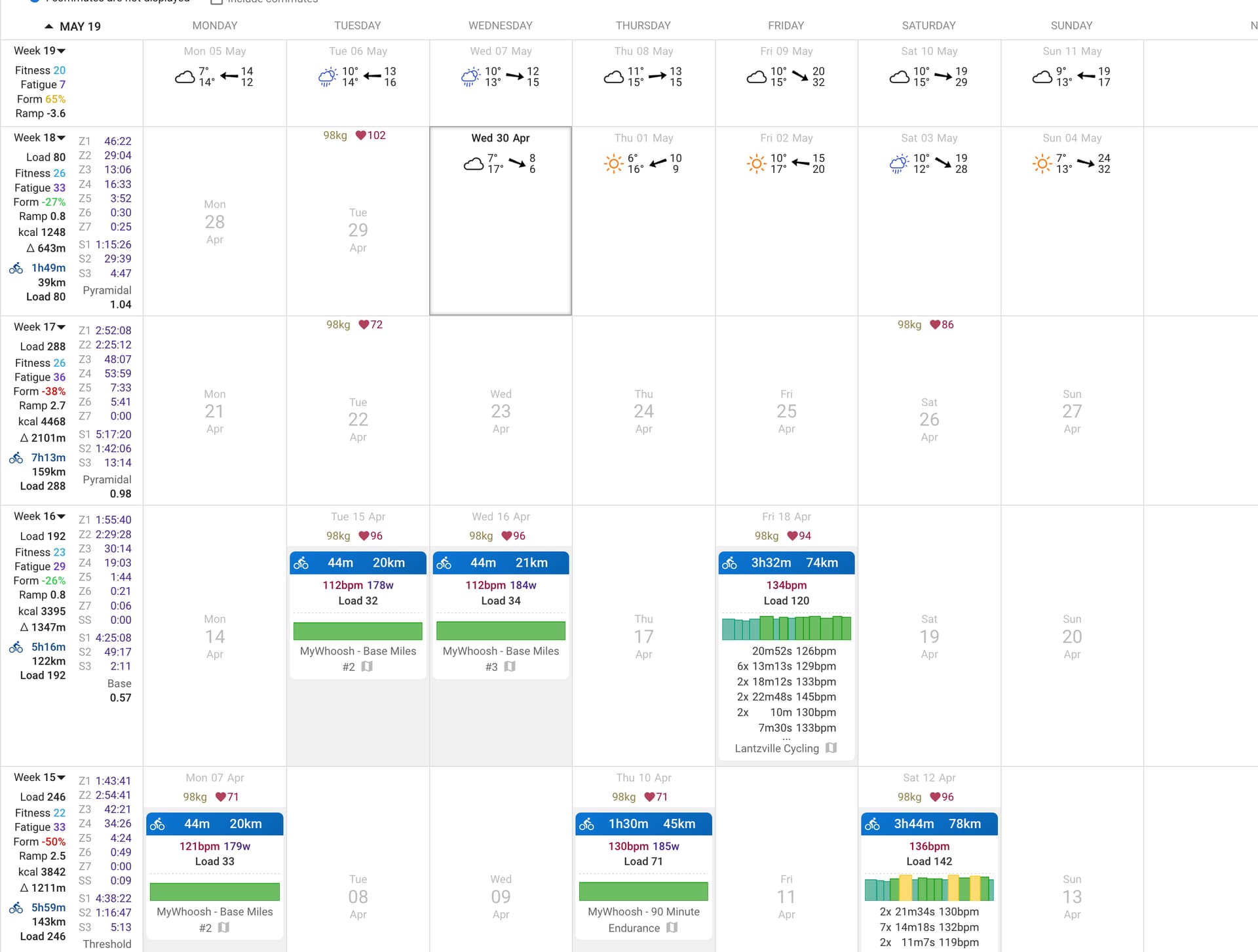

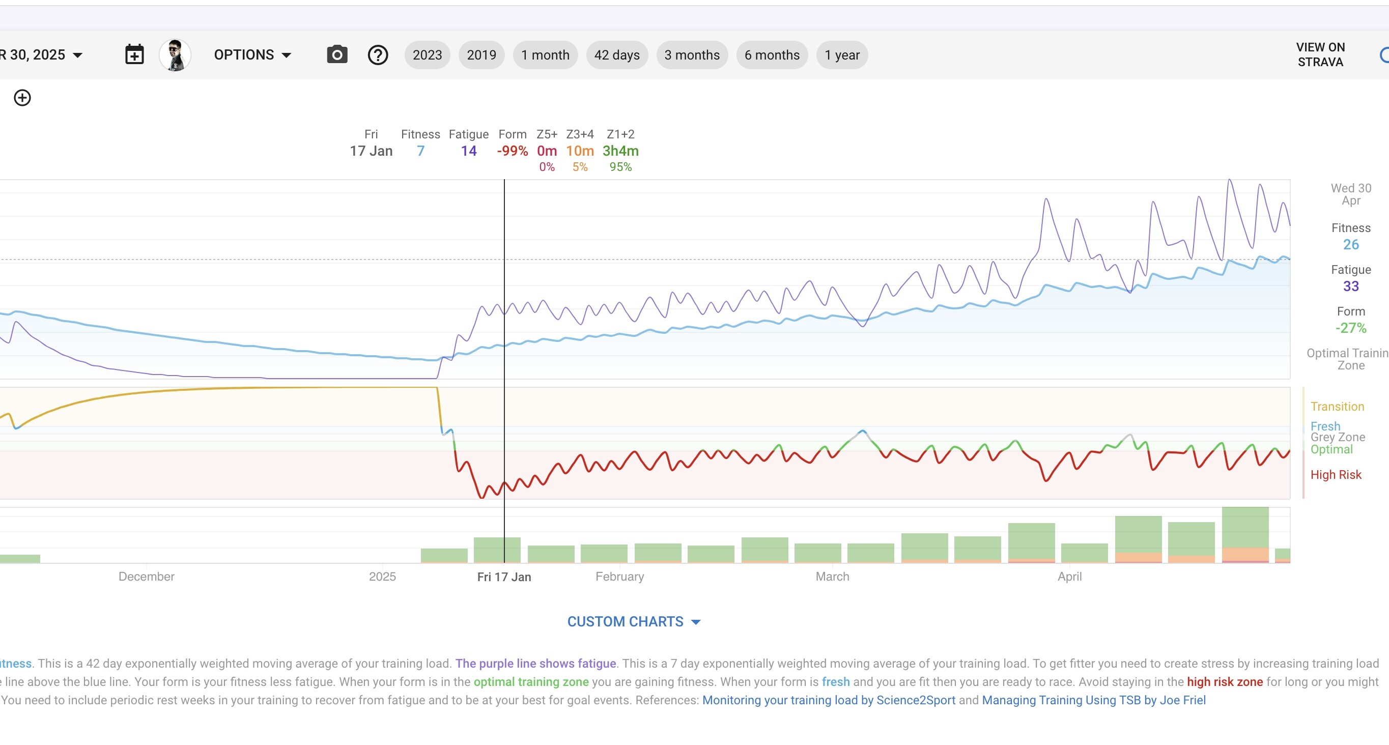

Hi, recent rides have stopped showing up in the activities page (I tested this in both Chrome and Safari). I have my Intervals account linked to my Garmin Connect. All I see for recent rides is a heart rate icon (first screenshot) but ride data appears to be used correctly to calculate fitness scores (second screenshot). I haven’t made any changes to the settings in either account, and downloading my FIT file from Garmin and manually uploading to Intervals does not appear to correct the issue. Any ideas? Thanks the help!

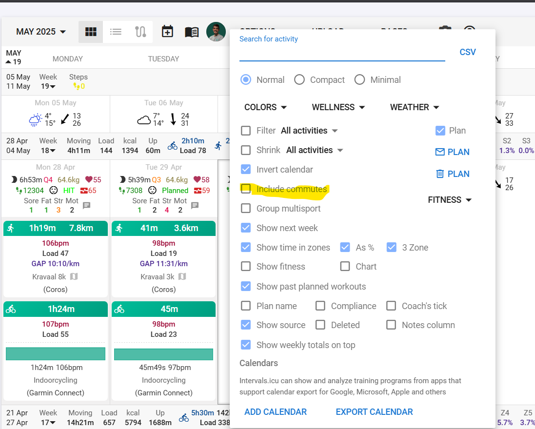

There recently was a change to how ‘Commutes’ are recognized. My guess is that all your rides are flagged as commute and commutes are set to not be visible on the calendar. Check the box in the calendar options and let us know if it solves the issue.
I think that worked! Thanks! I’ll keep tabs on this and follow up if any issues persist. Any idea how to stop my rides from being flagged as commutes? I’m slow, but not that slow (or so I thought).

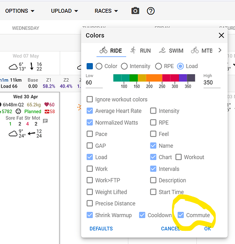

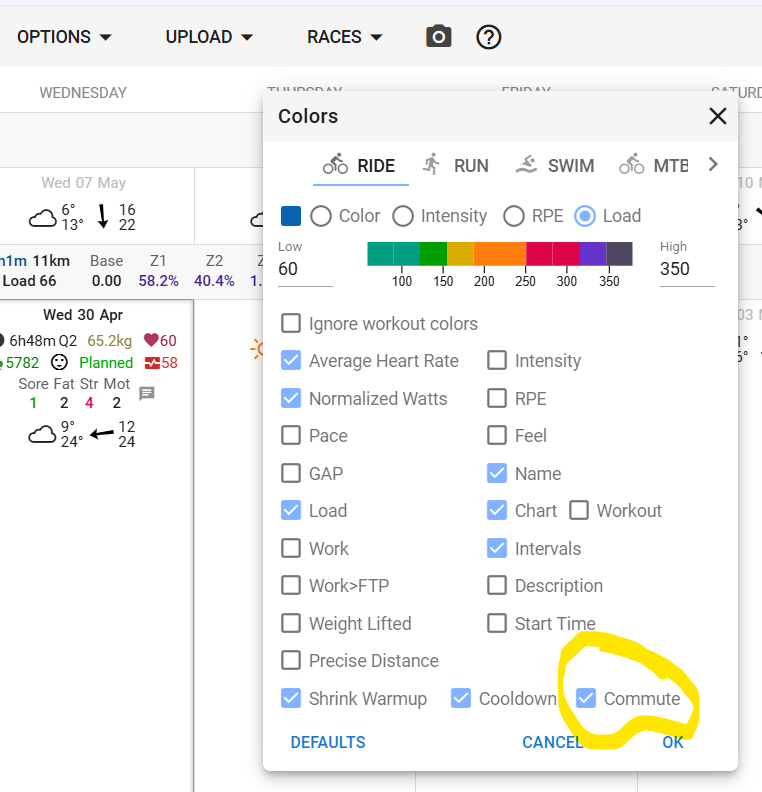

That’s another specific thing for commutes:
Options - Colors. If you uncheck the commute box, they will be displayed as normal rides.
