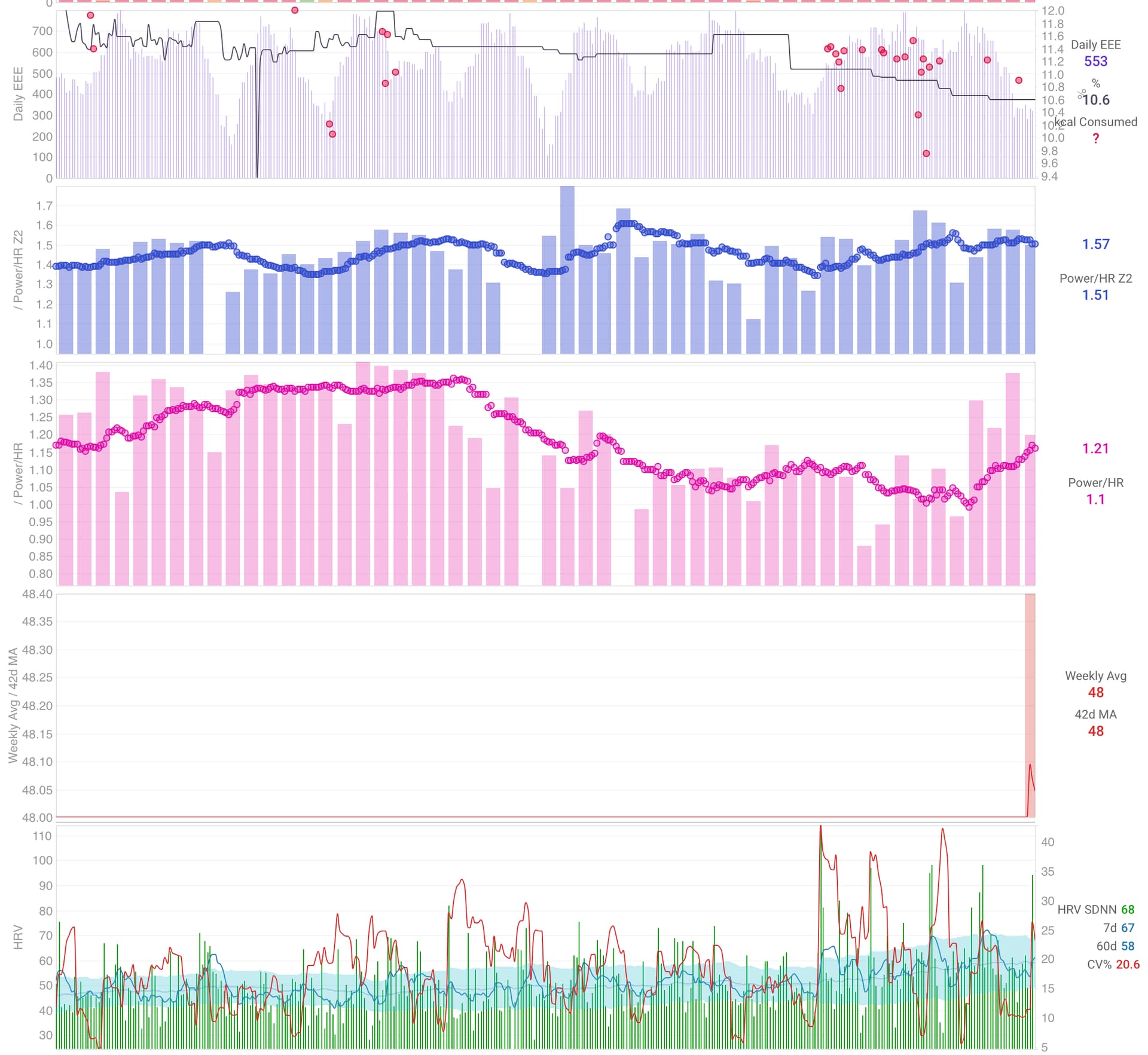

I have been uploading resting HR and HRV (SDNN) data on my calendar daily for over a year, but for some reason both of those Fitness Charts now only show 1 week of data (this current week). For example, the RHR (red bars) graph is only showing this recent week, but I haven’t changed my inputs for past wellness metrics. Screenshot attached for reference - you can see that other metrics are still being tracked, but it was odd to see this one, and the HRV chart (not shown in screenshot) with a big blank space all of a sudden. Thank you for any help with getting these to return to normal!
Hmm it looks like you don’t have much resting HR data … its all 48 prior to this week. How have you been getting that into Intervals.icu? How long ago did you last see the data you are expecting?

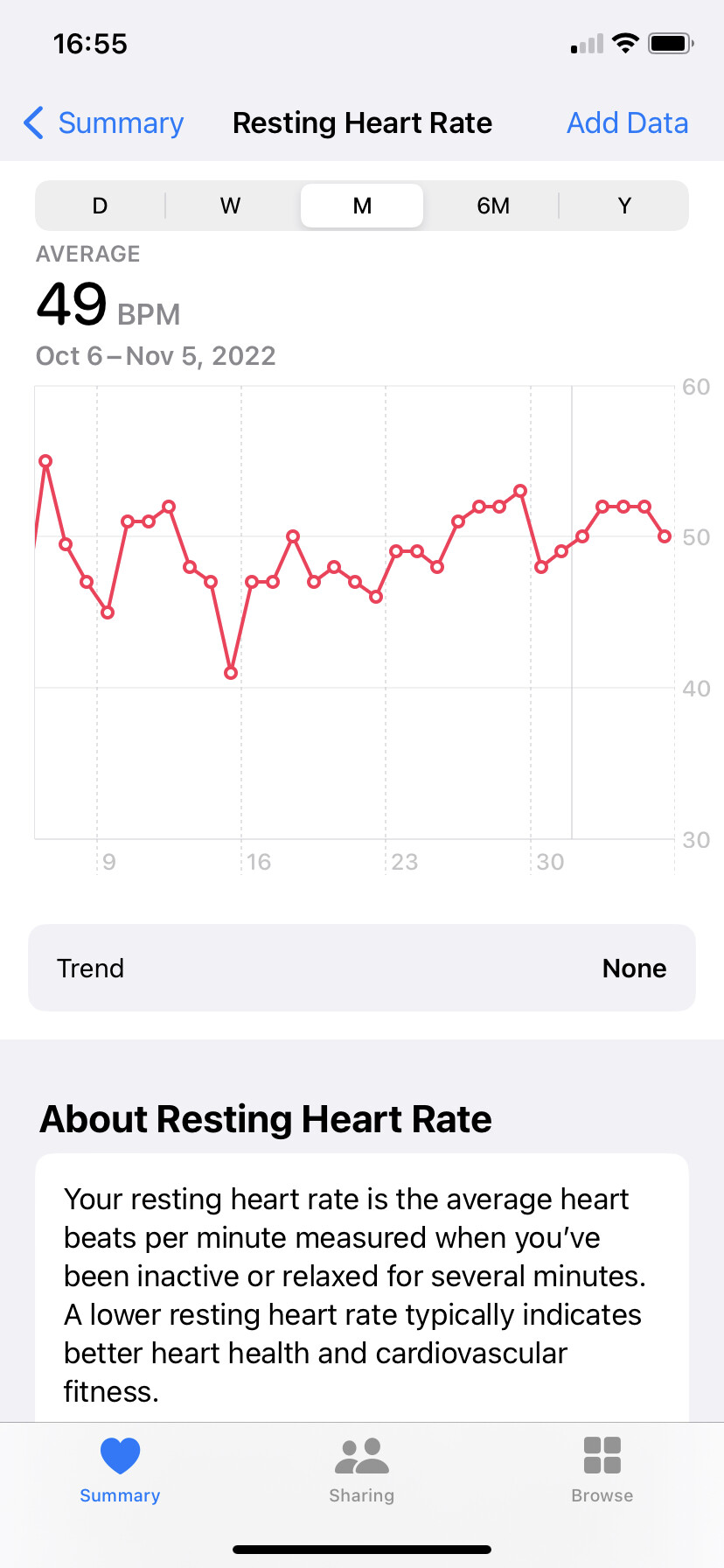

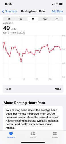

Hi David, I’ve been uploading through HealthFit, but the RHR has varied between ~43-52 this whole time and before this happened, there was a normal looking graph on the Fitness page. Looking back in my calendar, it’s like all the previous data was overwritten with 48 as the RHR. The HealthFit app was pulling from my AppleWatch and AppleHealth, and going back into AppleHealth (below) you can see that there is normal variation in RHR historically.

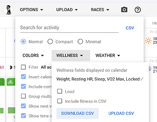

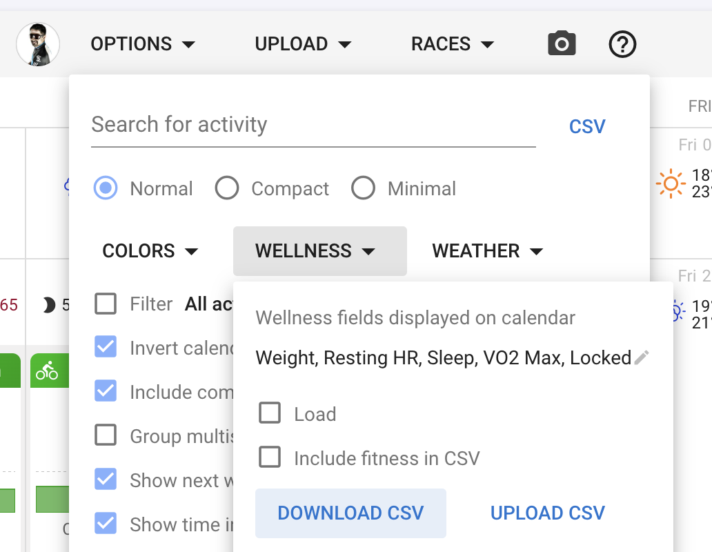

Can you get that data out of Apple Health in a CSV? I don’t know what might have wiped it out. Or maybe get HealthFit to re-upload it?

It looks like I can push history to Intervals.icu, but some of the data is inaccurate. If I had a CSV file of the accurate data, is there a way to import that to Intervals.icu?
