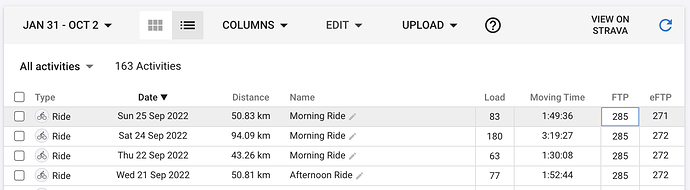

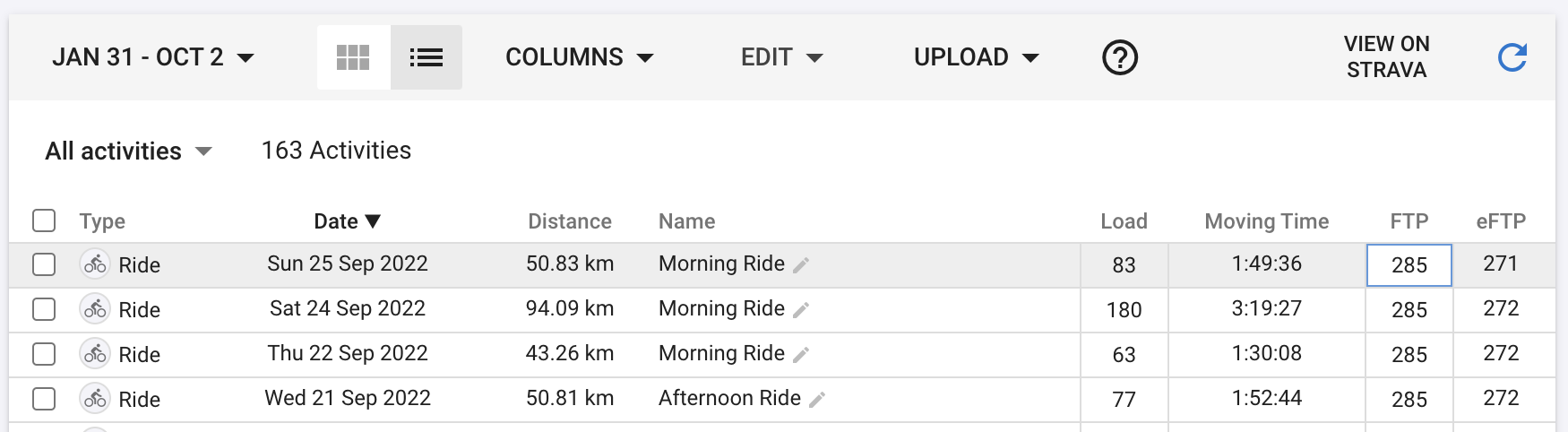

use calendar… put into LIST view and then show the FTP field and edit away.
edit: re-read what you asked… nope… don’t believe there’s such an option.
There isn’t such an option but you can add FTP and eFTP columns to the list view and quite quickly update FTP for each activity to match on the grid.
Oh nice, that will work plenty well. Can probably use a browser macro for that, too.
