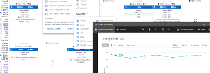

Hello, dont know if it was reported, but resting HR is not synced with garmin connect, but sleep hours and weight working well. BTW thank you very much for youre work, intervals are awsome.

I am wearing garmin Fenix watch 24/7, and have for all days rest HR 50, but in connect are different data. What can be set incorectly from my side, if other data like sleep hours and weight are synced correctly?
I am not sure. I keep the raw data Garmin sends so I should be able to track this down. I need to finish some urgent scaling work first then will get on it.
Hey, I think the sync works, but you are displaying the manually input resting HR (for me it shows everyday 42bpm). Either you are acessing the wrong HR data or Garmin does not provide it. Weight and Sleep works though!

I have fixed a bug with weight and resting HR. Both of these were being overwritten with the current athlete values when an activity was download. Will deploy the fix on Monday AM (GMT+2).

I see that now it works well, nice work @david , thank you
