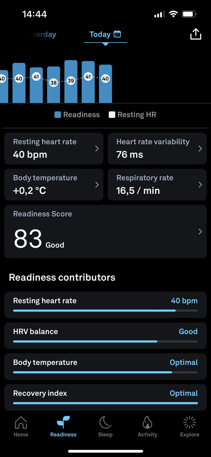

Ok. Unfortunately I don’t have a ring to play with. This is a screenshot I’ve been given, but no context as to what that temp value means.
Thats what I see as well. It doesn’t tell you what the temp actually is there either. I think its probably off by quite a bit so only the delta compared to “usual” values matters.
Hi @david ,
Is the body temperature delta synchronized with the intervals.icu? I can’t find it.
No it isn’t. I don’t think that was available when I did the integration.
And would it be possible to add it, please?
