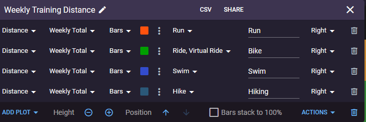

Can this also be applied to custom charts in the Fitness feature? I have a custom weekly distance chart as below:
The totals on the right are in miles for swimming:
