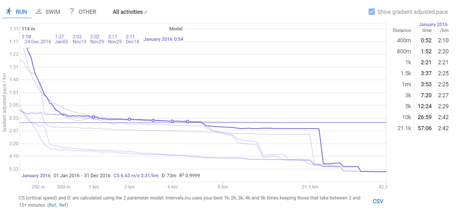

Remove autliers in pace chart
how can i remove outliers in pace chart
how can i find the work out that is maybe wrong tagged (e.g cycling instead of running)

As you hover along the line you can see the date of the activity that determines a certain point. You can then look at the activities on that date and investigate further.
thx
1 what next:
i found the activity - then change it in garmin → will this be automatically updated in intervals.icu or do i have to change it in intervals.icu. if yes how?
2 propose for better usage:
my workout seems to be defined correctly, but in the workout there seems to be some data issues with pace: it would be nice to have an outlier filter that removes everything faster than a certain value
At this time, you would need to disable the data for that whole workout. From the workout: Actions - Settings - Ignore Pace Data
is a filter option planned in the future?
would be very helpful
I have “ignore pace/HR for this portion of the activity” on the todo list. You can click the dates displayed for activities on the pace/power/HR charts to navigate to that activity.
