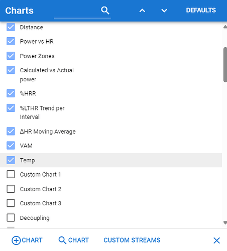

There’s a field called average temperature , that pulls through from devices that record it.
IMG_0317

For those finding this thread now, the field is now called simply “Temp”.
