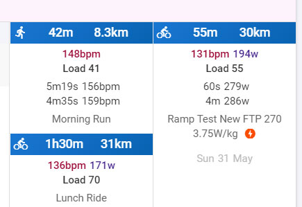

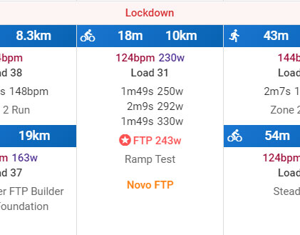

Today i have made a Ramp Test and got a new value but the intervals.icu did not detected the new FTP as before but when i did Ramp test 6 weeks ago
before

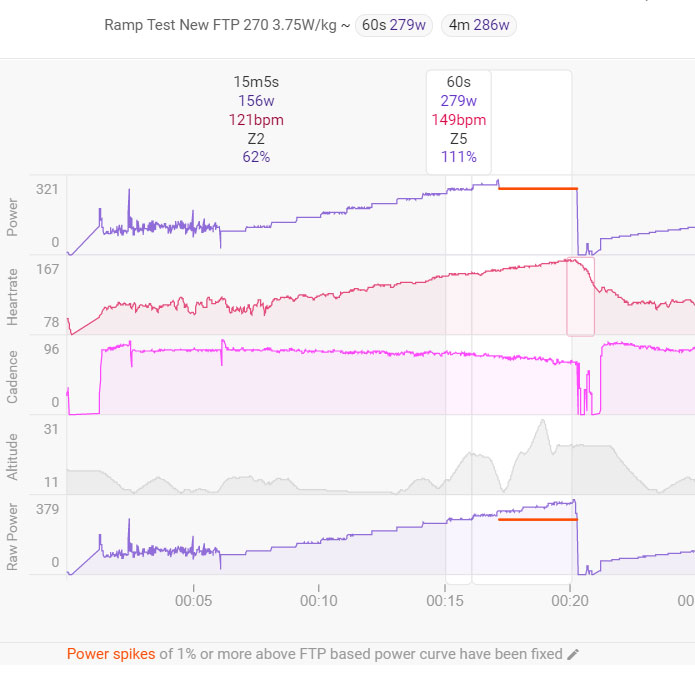

As you can see in the image the intervals.icu detected auto the new estimated FTP but today gave an Power Spike.
This is my calendar view and my configuration for Power spikes of 1% or more above FTP based power curve have been fixed . What should i change? Get a bigger treshold value? What should be a good percentage value?
You need to bump up that percentage until the spike is not corrected. You know it is real power data from the ramp test. I suggest trying 20% and going up from there.
You can change the default in /settings. I would go with 20 or 30%. Some people have a really good sprint and need to make it higher.
Forgot to mention that you can just click the warning to edit the percentage.
Thanks for the help, manage to make it work with 9% percentage. Funny Zwift told me 270 W new FTP and intervals FTP +25 to 264w
