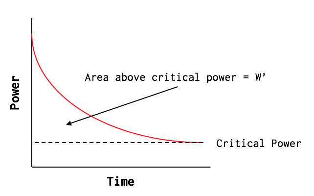

The highnorth website explains it quite well.
lets say your actual (not estimated) W’ is 10kJ (= 10,000 joules or watt seconds) and your FTP is 250W.
How long can you go at 325W?
  1. Figure out wattage over ftp:
    325-250 = 75W over ftp
  2. Figure out how long
    10,000 watt seconds / 75 watts over ftp
    = 133 seconds
Answer is you can go 2 minutes and 13 seconds.
What if your W’ was 11.1kJ? Then you could go 148 seconds or 2 min and 28 seconds (11,100/75) at 325W if your ftp is 250W.
What if you pushed W’ up to 15kJ? At an ftp of 250W, you could hold 325W for 200 seconds or 3 minutes and 20 seconds.
An accurate W’ and FTP/CP can also help you optimize high-intensity intervals.
