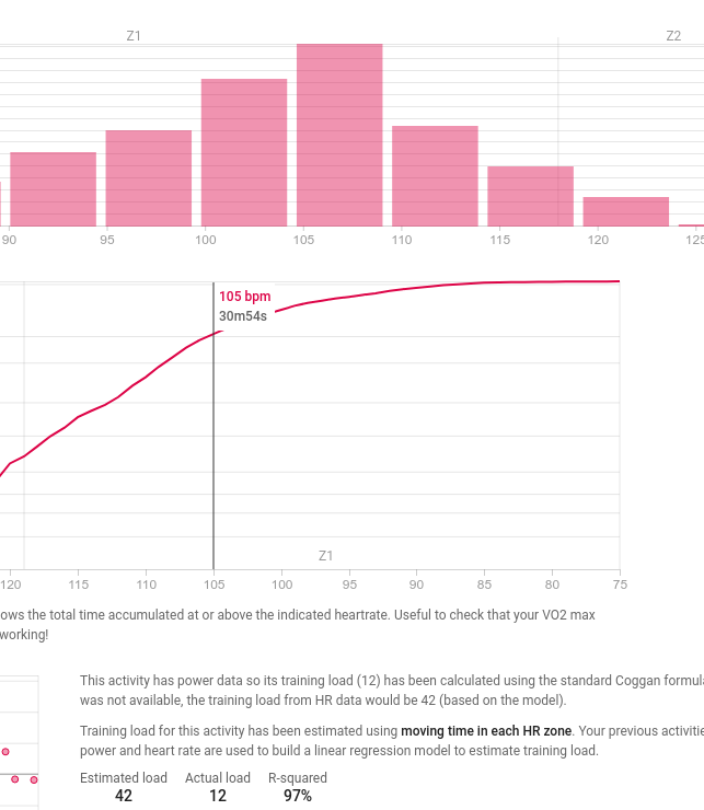

Got a query about potential overestimated TSS for heart rate only rides. On Tues I did a very steady commute (15 minutes approximately) and was calculated at ~27 TSS @116bpm (no power). Later on, I did a harder effort on the turbo for the same time, 315w @160bpm and got a TSS of 26.

For HR there isn’t a standard way to do it (that I know of anyway) and Intervals.icu has 3 models: Average HR, time in zones and HRSS (normalised TRIMP) as used by Elevate. You are currently using “time in zones” which does tend to overestimate very low HR efforts. I suggest changing to HRSS in /settings as it is more robust. I made it the default for new users a while ago.
You can see the model in use on the activity HR page.

When doing a zone 1 ride, I got 12 TSS per hour while the HRSS is around 42 and on training peaks it also states 30 TSS for a high zone 1 ride in the table and the slowest easiest effort on RPE 1 is 20 TSS per hour.
Hi, I realized my heart rate zones was a little different but even after I reset it, the estimated load on HR was 40. There is just too much of a difference compared to the calculated TSS.
Hmm yes. I think its probably best to change to HRSS. The “time in zones” model works well for my data but thats just one data point. HRSS is probably a bit more robust.
After changing to HRSS the load was 17, which sounds a bit better and a recent 2h51 easy ride I did with HR only had a load of 130 and has gone down to 72. It sounds a little bit on the low side to me definitely more acurate.
In a recent hard 4h ride, my TSS was 283 and the HRSS was 267, so that is quite close to each other. Will see how I can tweak my heart rate zones for closer matching.
Edit: I see the zones have no effect, just HR max and resting HR
