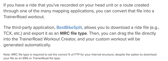

    https://support.trainerroad.com/hc/en-us/articles/201377834-Creating-a-Custom-Workout#1
  2. uploaded MRC or such to their platform

Unfortunately they have allocated all of their resources to adaptive training and the current method of importing .mrc files is outdated and arduous.

I emailed a potential new athlete the MRC file today. Took him less than a minute to drag and drop into the TR workout creator, and was able to view it in his custom workouts.
Perhaps not what you need, but it worked for him and he seemed happy.
Less than a minute is a big exaggeration. It’s more like 5 minutes. Doing that everyday adds up to 30 minutes a week I could add to my training volume instead.
