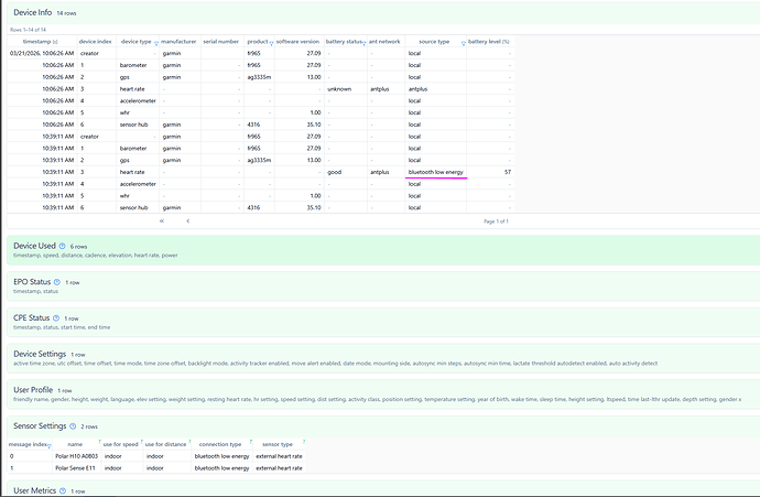

Pull sensors from the fit file and display on activity
Here’s the sensor part in my fit file: I have two rows, even though in this particular activity, I was only using the verity sense.
How can I adopt the script to pull the correct sensor for my activity?

Do not search m_147 for the active sensor, Messages m_147 have all sensors paired, the order is not guaranteed.
Search m_23 instead and filter by network type and device type. (Thats like in a mobile expecting the active heaphones is the last one paired).
If you want your device settings name (the one you have in your watch settings, and can be edited) use m_147 f_2
Use device ant id for index in that case
But I don’t connect it via Ant+. Ant+ is reserved for alphahrv (imready), so I connect both the H10 and E11 via BLE. I though I could differentiate the sensors from the fact that the H10 records R-R intervals, whereas the verity sense doesn’t, but it didn’t work. I only quickly used chatgtp.

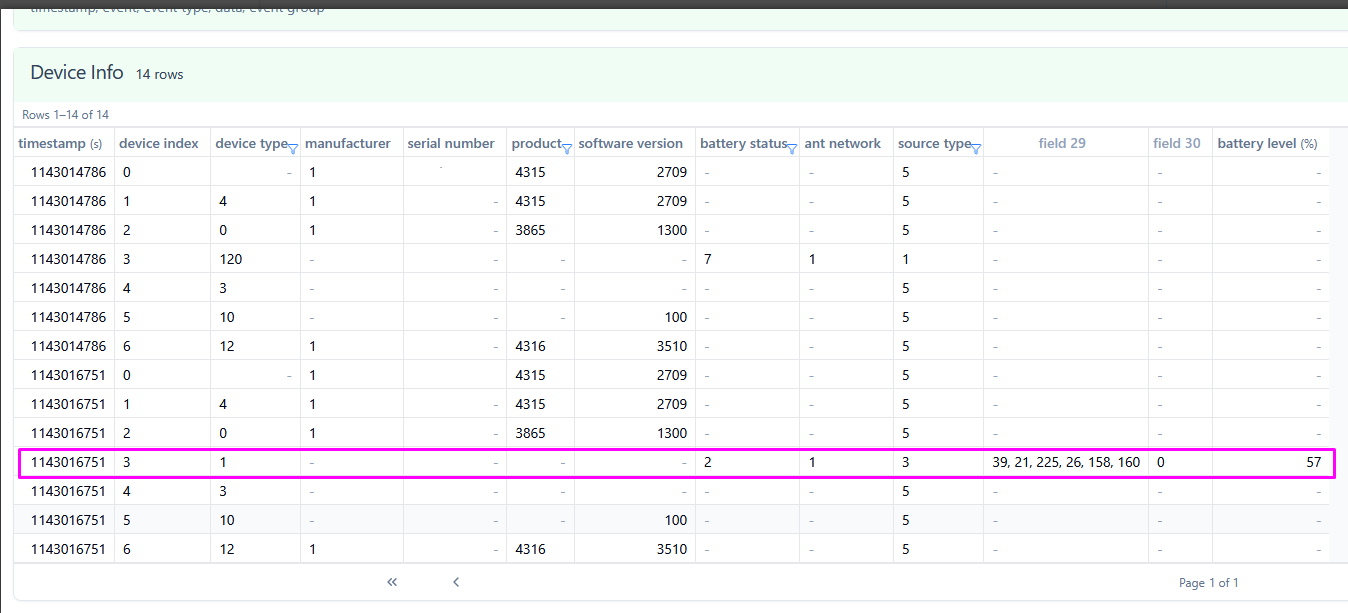

Can you open that file in runalyse fitfileviwer and paste here the device_info message that contains device_type =1

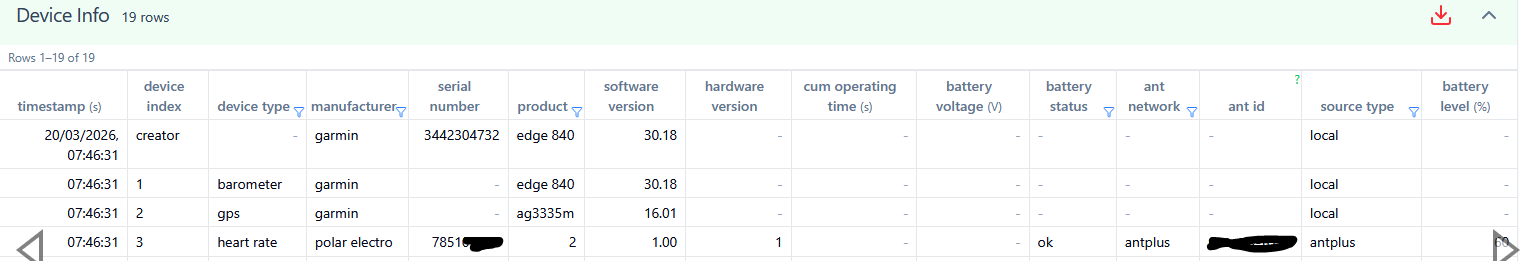

Polar H10 Ant+
timestamp(s)=1143049989,serial_number=7317xxxxxxx,unknown#15=3,unknown#24=247xxxx5,manufacturer=123,product=2,software_version=1.0,device_index=2,device_type=120,hardware_version=1,battery_status=3,ant_network=1,source_type=1,battery_level(%)=100
timestamp(s)=1143050029,serial_number=7317xxxxxxx,unknown#15=163,unknown#16=3,unknown#24=247xxxxx,manufacturer=123,product=2,software_version=1.0,device_index=2,device_type=120,hardware_version=1,unknown#9=98,battery_status=3,ant_network=1,source_type=1,battery_level(%)=100

timestamp(s)=1143016751,device_index=3,device_type=1,battery_status=2,ant_network=1,source_type=3,unknown#29=[39, 21, 225, 26, 158, 160],unknown#30=0,battery_level(%)=57

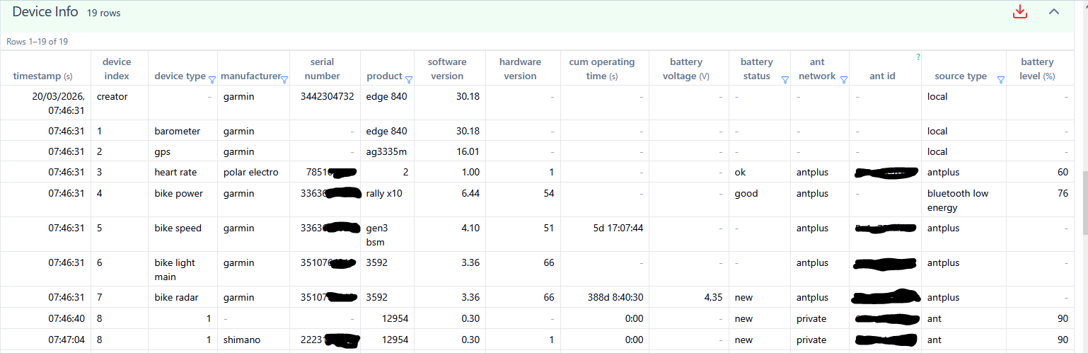

Distance from Bike Speed sensor, and the rest. Allows to know when to fill tires.

This is a console log from Sense:

In contrast, Garmin GARMIN HRM_PRO_PLUS BLE has manufacturer number and product number:
timestamp(s)=1136548708,serial_number=348850xxxx,manufacturer=1,product=4130,software_version=8.9,device_index=2,device_type=1,hardware_version=66,battery_status=1,ant_network=1,source_type=3,unknown#29=[79, 169, 187, 184, 109, 206],unknown#30=1,battery_level(%)=85
timestamp(s)=1136550250,serial_number=348850xxxx,manufacturer=1,product=4130,software_version=8.9,device_index=2,device_type=1,hardware_version=66,battery_status=1,ant_network=1,source_type=3,unknown#29=[79, 169, 187, 184, 109, 206],unknown#30=1,battery_level(%)=85
Can’t I just use device index: 2 for H10 and 3 for sense? I do care about security on the internet, but who would benefit from knowing my R-R/Alpha values? Wasn’t there some benefit for using ant for alphahrv? You get respiration rate as native field or something…
no, indexes are dynamicly assigned, perhaps by pairing order.
I think that Polar HRM BLE implementation doesnt implement that specific garmin features (garmin sdk manufacturer and product numbers) to be more Apple HRM BLE profile’s compatible.
