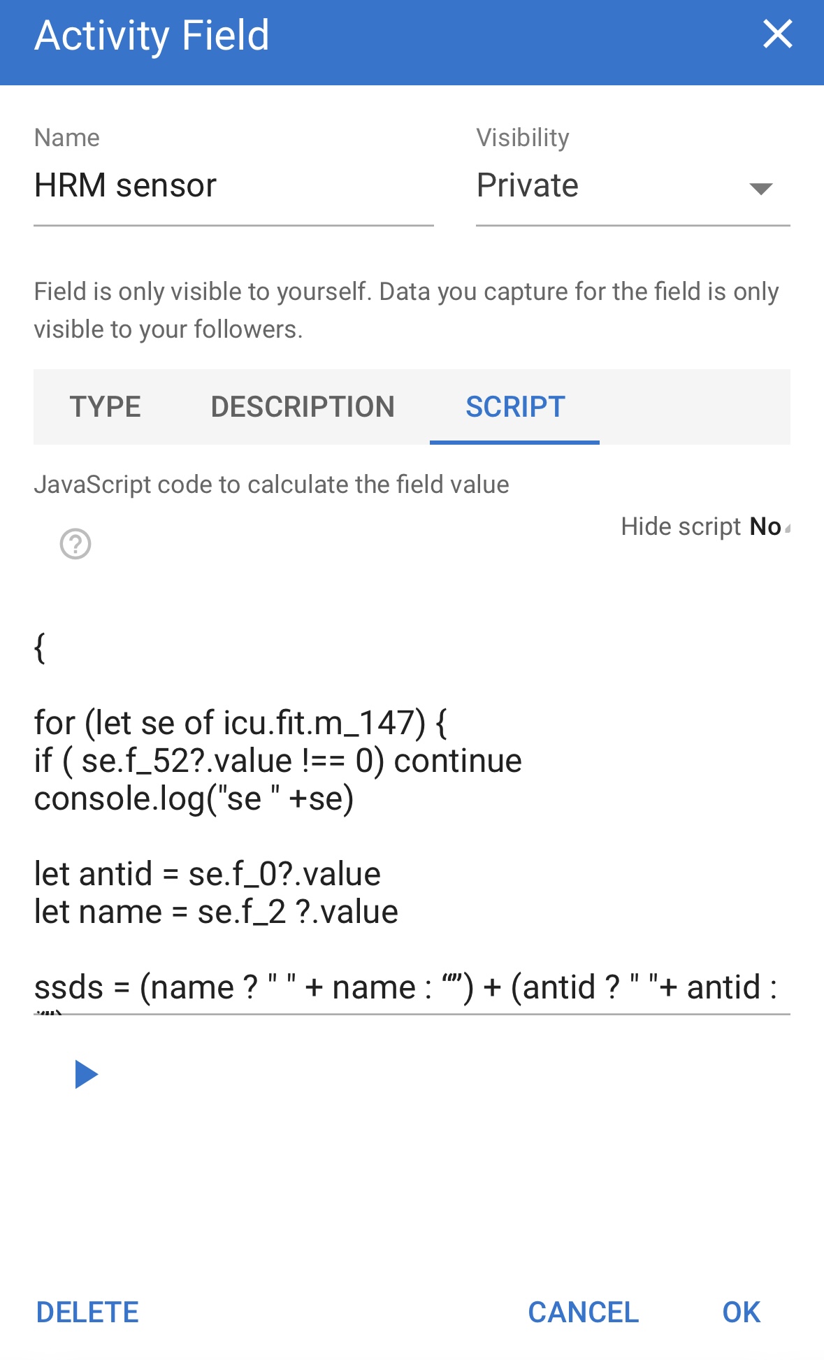

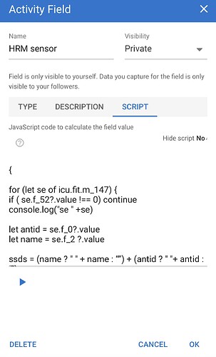

in Activity>Custom>Activity FieldsAdd Field
Paste the code in SCRIPT

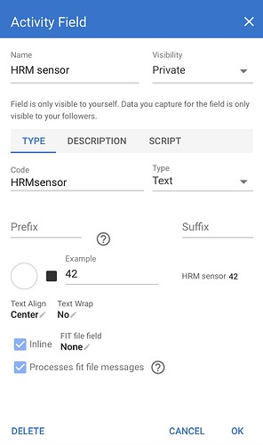

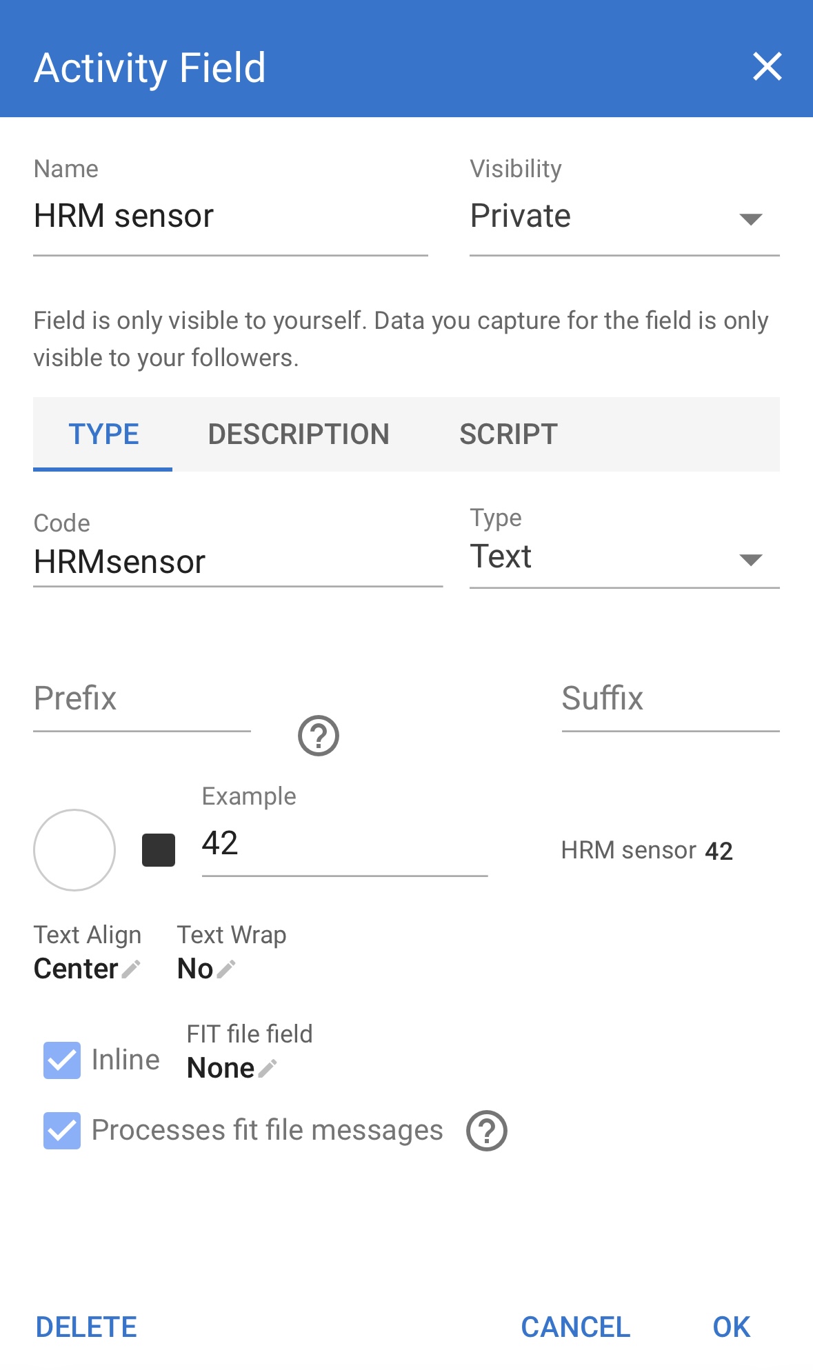

Give A Name, select Type as Text, check Process Fit File check box, chose units, and save.
The reprocess and analyze activity.
What do you mean choose units. I can’t see that in there
thats right
After reprocessing activity the activity field is still blank
Can’t see any of those Polar Verity Sense numbers in my fit file. Does that matter?
That the name that Polar likes to use and additional info to parse fit file in the conventional way
So do I need to put that info in the script or something? So far the script is not working for me.

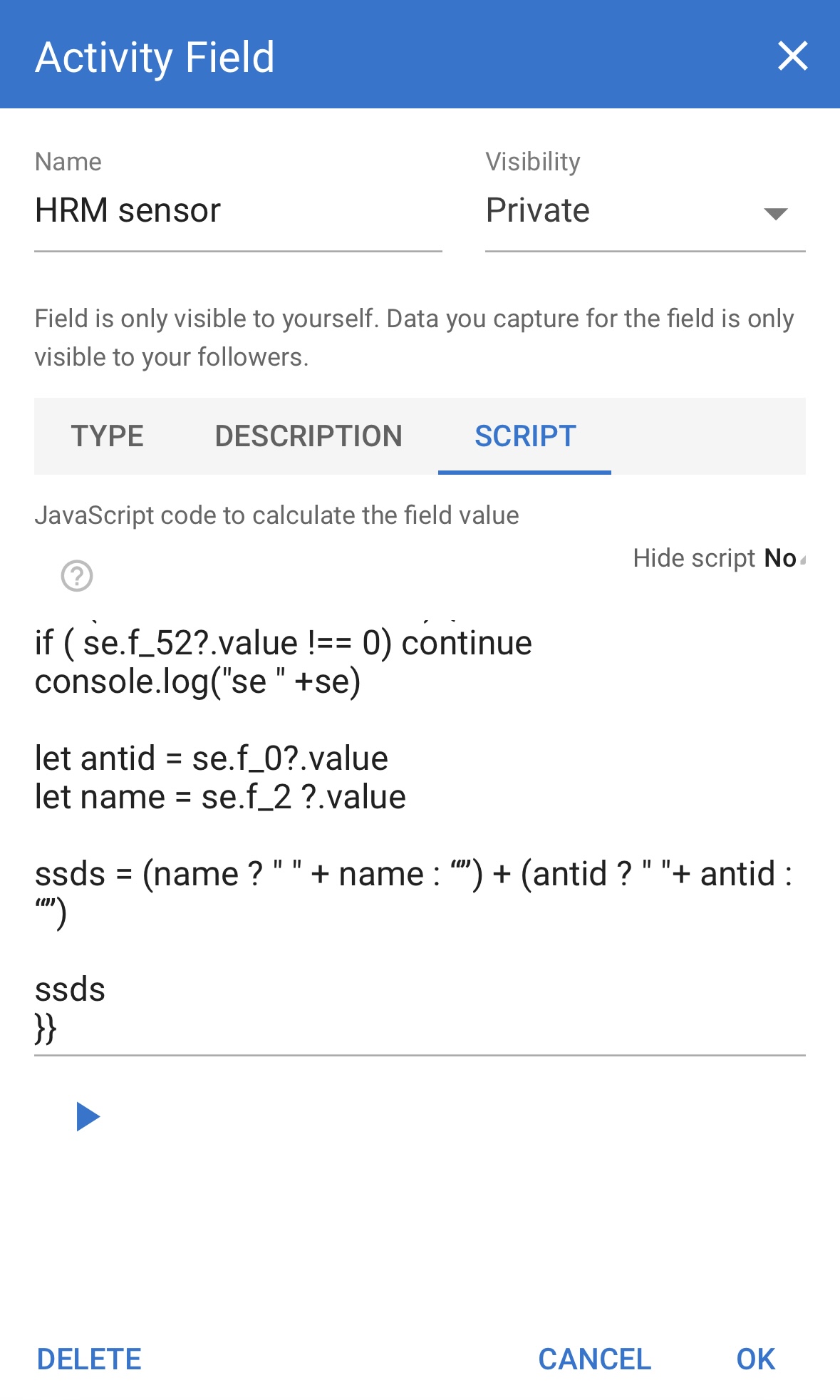

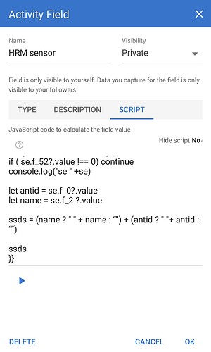

for (let se of icu.fit.m_147) {
if ( se.f_52?.value !== 0) continue
console.log("se " +se)
let antid = se.f_0?.value
let name = se.f_2?.value
ssds = name + " "+ antid
break
ssds
Wow, it works. Thank you!

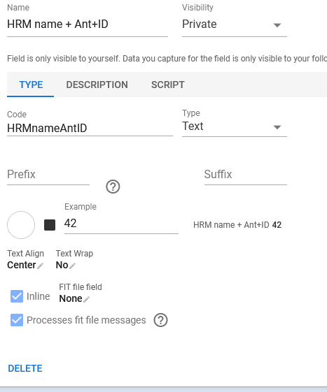

BTW, you can check also my beta Custom Activity Field: “HR Monitor S/N mod”, in the search field, search for mod.
