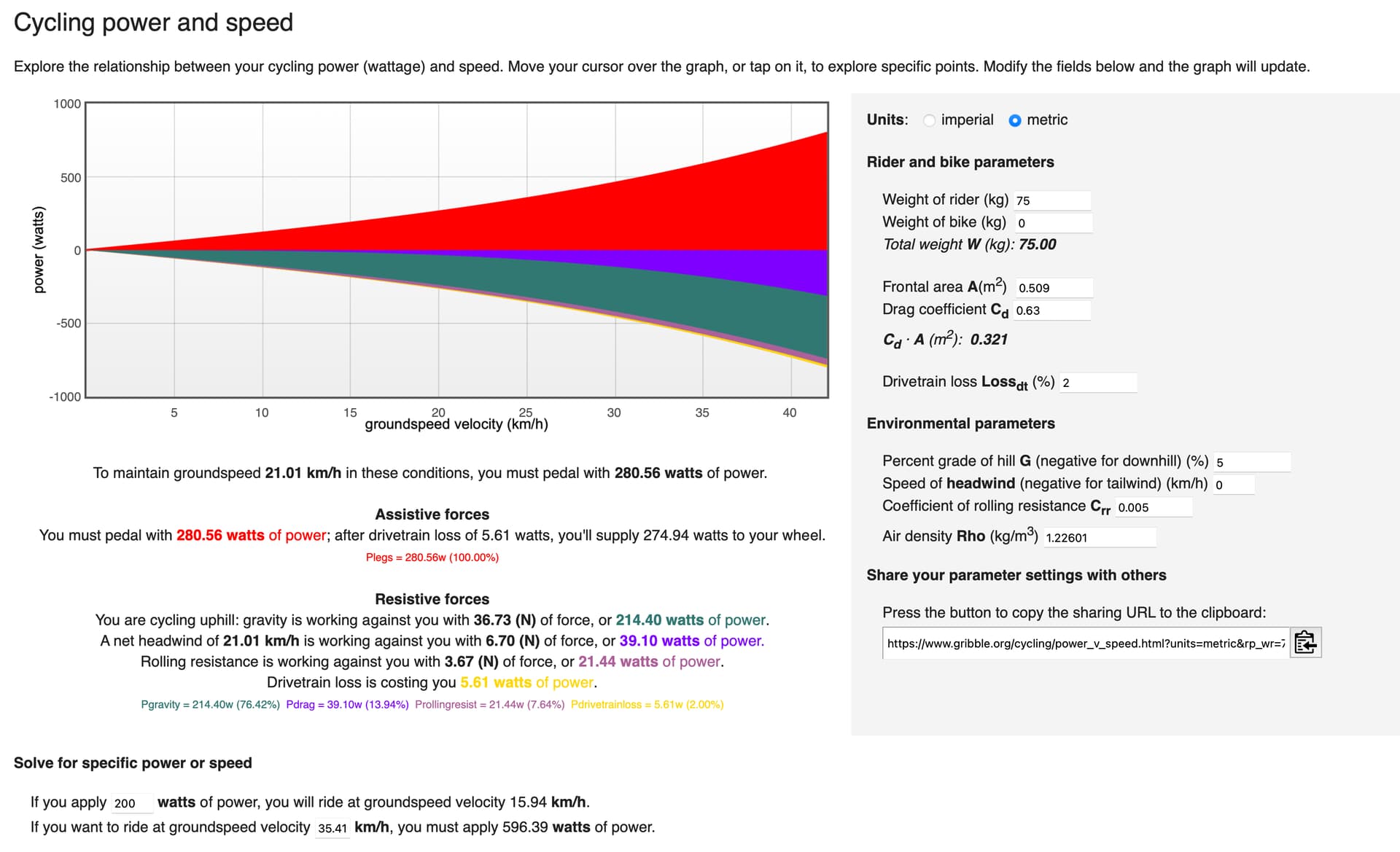

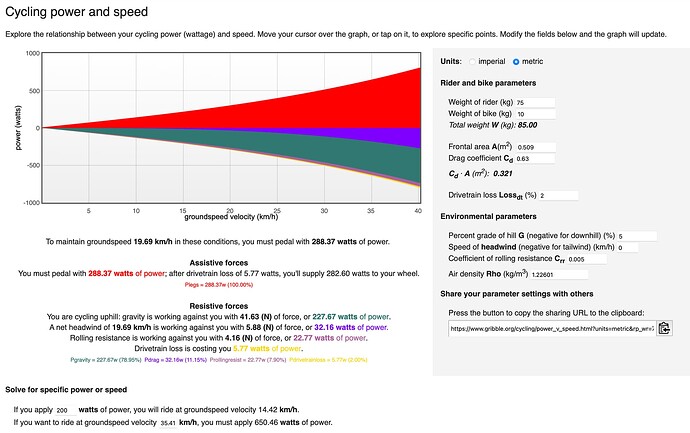

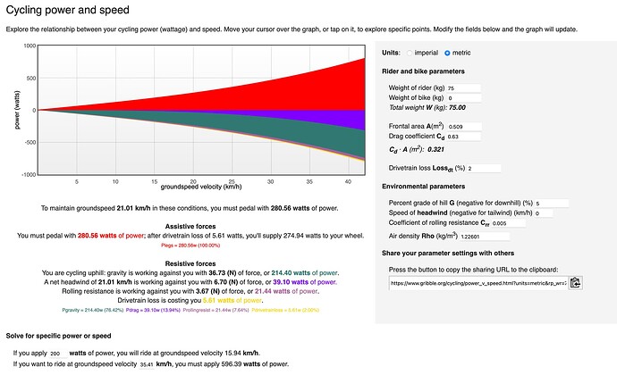

like @MedTechCD, I agree with the assessment. Let me share some graphic and such (this is the site / physics math I use for my BreakAway app to model the forces applied to the rider and thus simulating climbing)
I’m sharing 2 pics here. All the same conditions except one is Bike weight = 10kg and another, bike weight = 0kg, 5% Grade
Bike Weight 0kg, at 200w constant power you ride at 15.94kmh
Bike Weight 10kg, at 200w constant power you ride at 14.42kmh
So yes, clearly all things remain equal (same human, same human weight / same w/kg) the lighter bike will get you up faster but w/kg remains the same because its your weight
