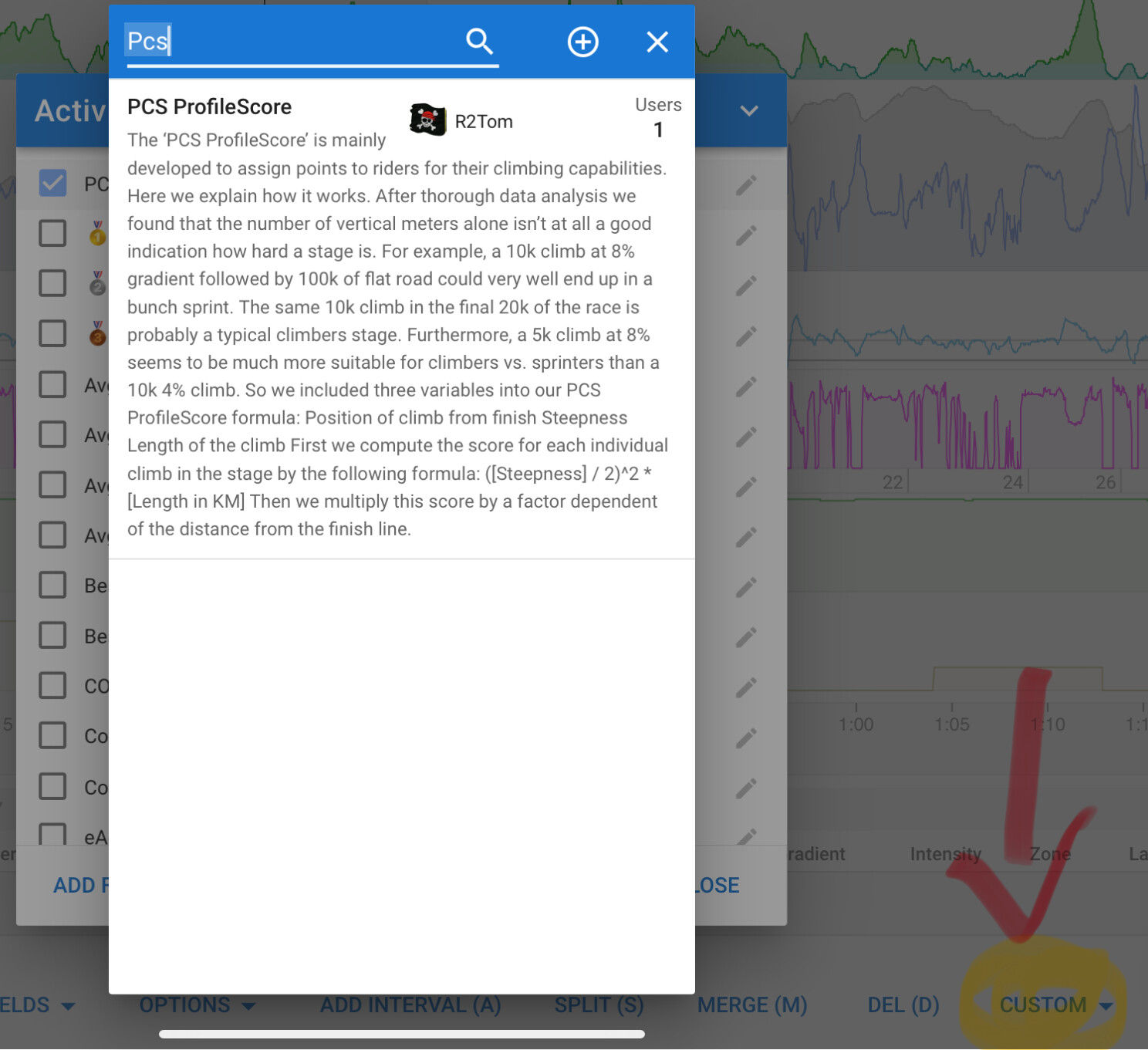

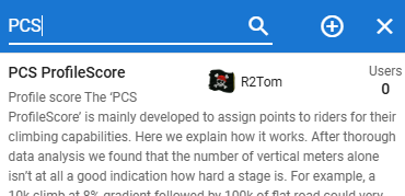

Because you’ve said it worked, I made those public. I’ve changed it, so that it works for intervals (search under fields) and as a custom field (serach under custom):

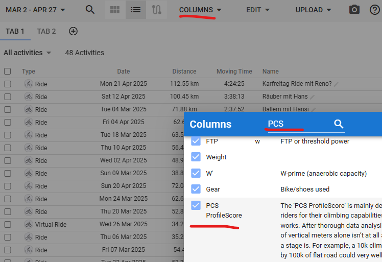

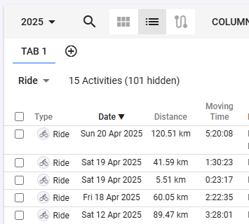

I meant in the Activities → List View, like in the following pic
Sure, you can add it to the columns:
it does not appear on my side ! :smiling_face_with_tear:
If you have it as ā€œCustomā€ Field (not as Interval ā€œFieldā€), then it will appear under columns:
