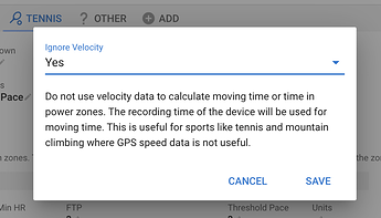

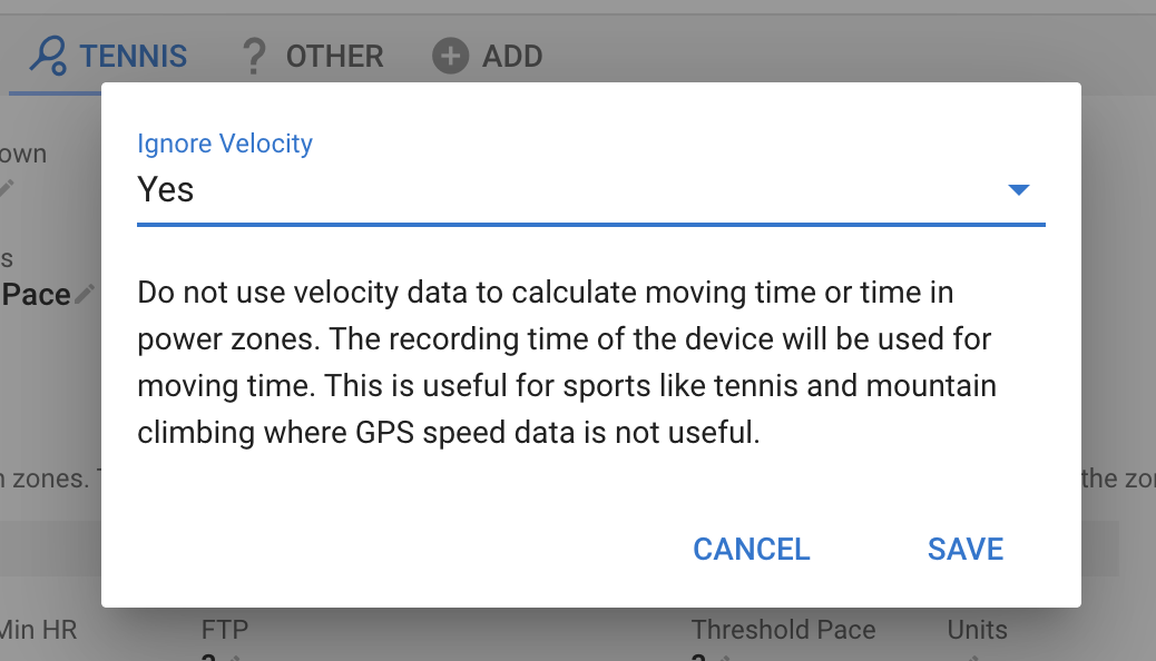

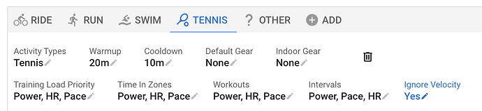

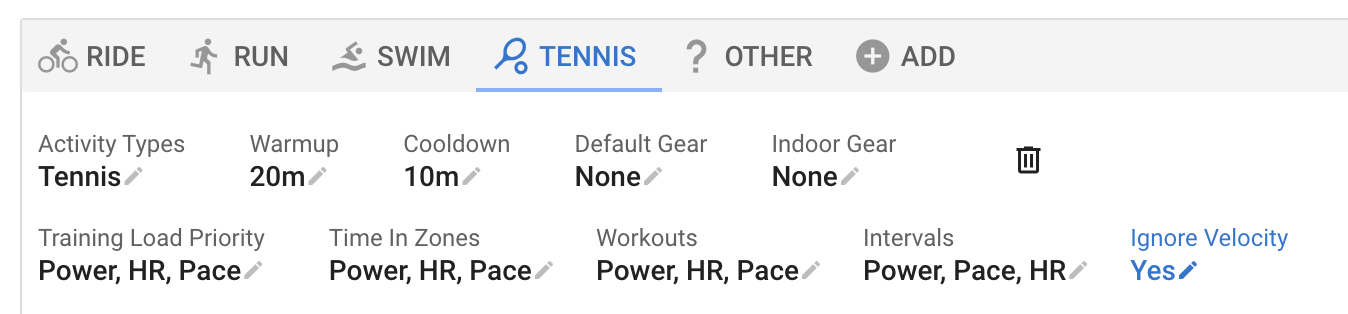

I have added a default for ignore velocity in sport settings. This is applied to newly analysed activities.
This is perfect, thank you.
