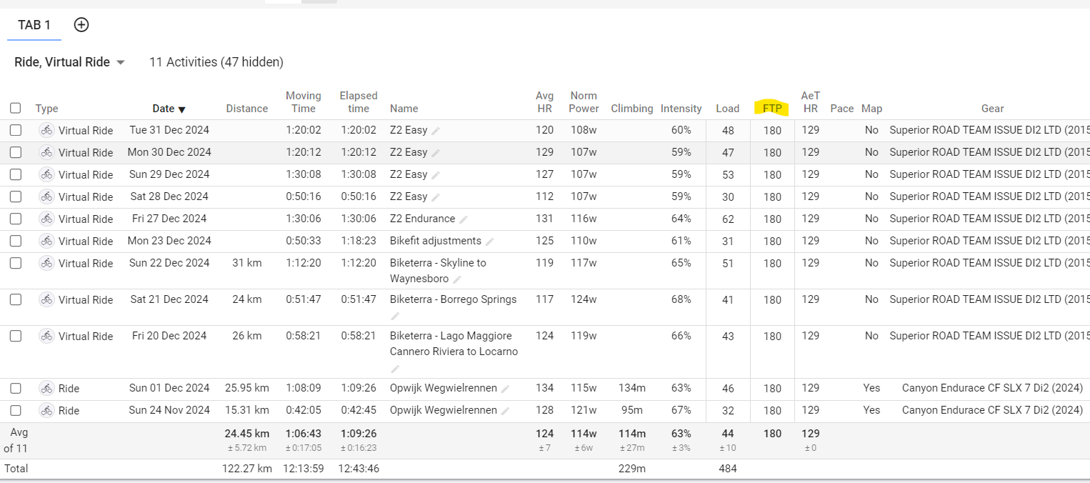

Zones are set as % of FTP and remain constant until you effectively introduce other zone settings.
FTP on the other hand follows what you have set as FTP for date ranges.
What FTP is set for a particular date range (or activity) can be displayed in the activity list view. Just add the FTP column and you can see what FTP was set at that time. If it is for some reason not correct, you can correct it there too. Once you set an FTP on an activity, it will be used for the following activities until you once again edit it.
Thanks for the fast answer.
I got it and understand it now. :slight_smile:
