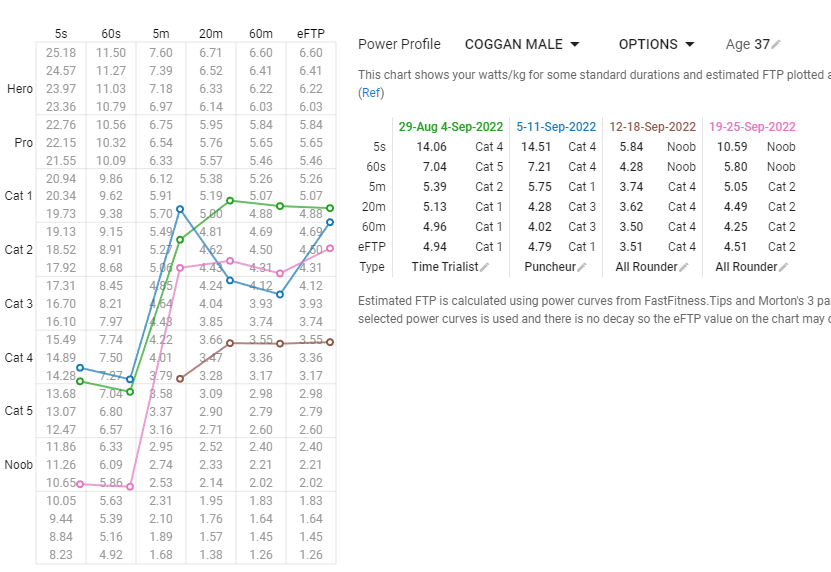

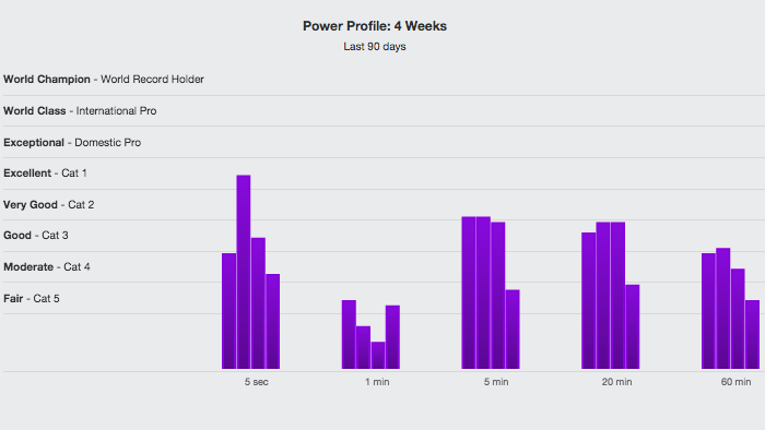

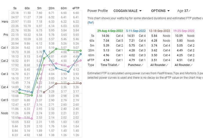

I can’t find on Intervals chart with power profile progress, like here:
  • where time period and number periods were a parameters.
    Is it possible?

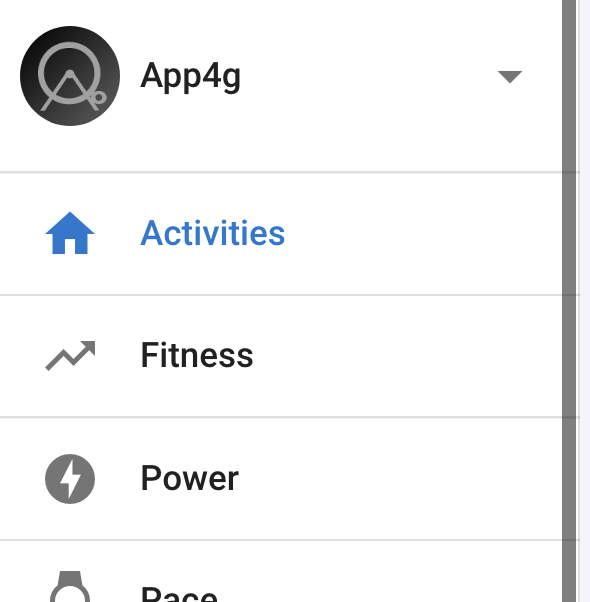

try the /Power page…
Everything else is there but not this kind of graph.

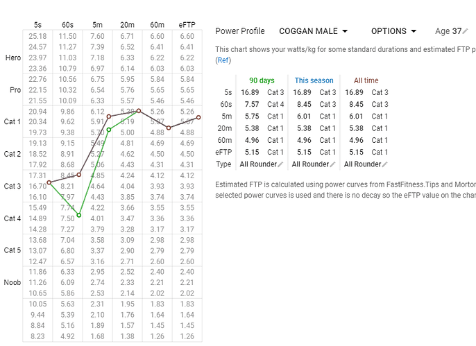

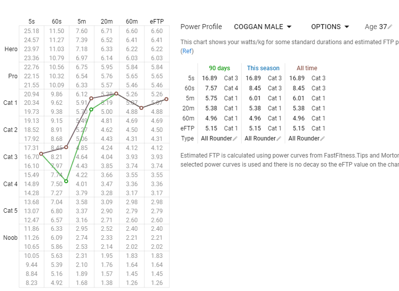

Go to your /Power page, navigate to the bottom and change the ‘Power Profile’ option to ‘Coggan Male’ (or female) and you will get the same information…

This is not exactly I am looking for. If you look closer to my referenced images from TP there is also additional information about how power profile evolved during last (four) weeks.

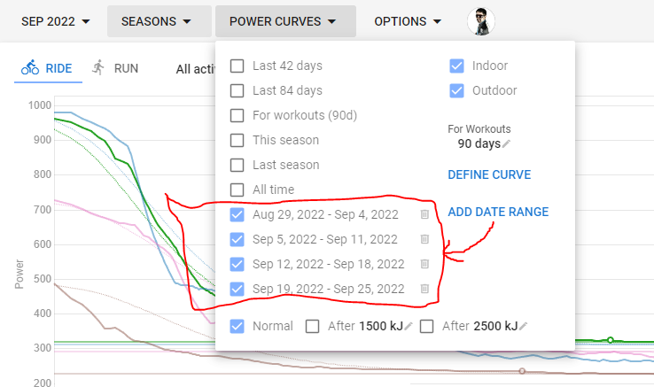

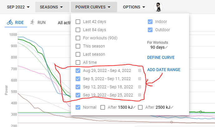

You are looking for something that is not included as standard (currently) I’m afraid then. I have had a good look at the images and I also use TP… You can get somewhat close by doing the following but I appreciate it is not exactly the same but does provide the same level of insight.
  1. Setting custom weekly date ranges on your power curve

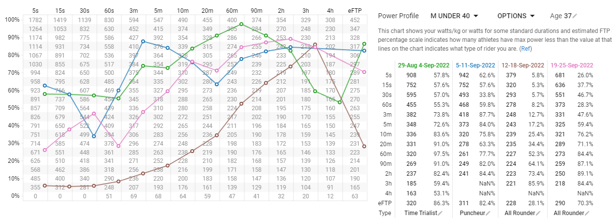

  2. Changing the Power Profile to Coggan Male/ Female OR changing to something like M/F under 40 which will show you it in W (rather than w/kg)
