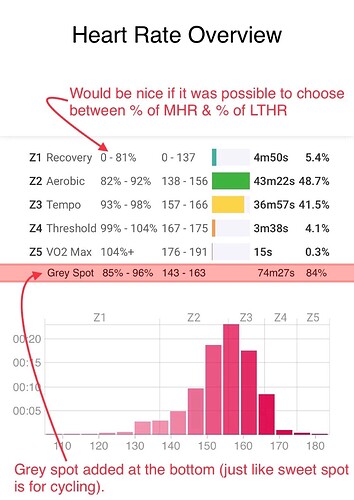

Possible to add «Grey Spot» to heart rate zones and power zones? Same way as sweet spot is shown. See attached photo for example.

Attached is an example I made. Junk workout with high tax on the body, but low returns on fitness compared to effort. State of mind just after I finished «great workout, feel tired».

If I could add a 6th zone at the bottom of the table and call it «Grey Spot» it would be problem solved. It is however not possible to do that as overlapping zones are not possible.

So in my case tweaking Z3 will not help. Only adding a 6th zone (which I have in intervals.icu) works. But the best option would to have a customizable grey zone separate from the defined HR-zones. Just as sweet spot.
