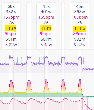

Power/FTP % is showing as Normalized and not Average?
When selecting chart fields, and wanting to view the power effort vs ftp - it’s displaying the % using the normalized power / ftp and not the average - yet the w/pkg is right… Is there something I’m not selecting? It should be the average as far as I can tell but it’s not displaying…
In this instance it should be showing as 119%, 125% and 122% respectively… Instead it’s using the normalized values…
Hmm. I changed that on the 28th of Feb to be normalised power / FTP instead of average power to be match “Intensity” for a ride. But maybe I should change it back. For intervals using average power is probably better …

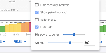

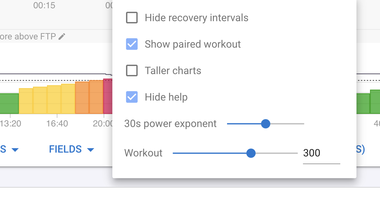

Just FYI, seems like your ERG workout and the chart is not lining up…
There’s an option you can do to align it. (the “Workout”)
Ok I have changed that back. Will deploy Sat AM (GMT+2). You will need to re-analyse activities from 28 Feb to 4th March to get the update.
Cool thank you.
Cheers I used a different workout but didn’t realise you can align the workouts. This tool just keeps getting better and better…
It wouldn’t hurt to be able to choose between the two. For laps over 20 minutes and with a high VI, it would be better to use the NP, for everything else medium power.
