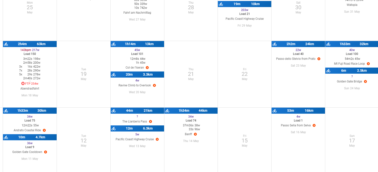

from November to mid May only minimal power data is synced within the activities. On Strava the activities are displayed correct and all the data is correct. Is there a way I can fix this?

Your FTP on at least some of those activities is set to 50 (!) so Intervals.icu is considering the whole thing to be one big power spike.
https://intervals.icu/activities/3484031828
You need to use the “Edit” option on the calendar or fitness pages to fix the FTP for those activities.

Thank you very much! Thank god, there’s a bulk edit :slight_smile:
