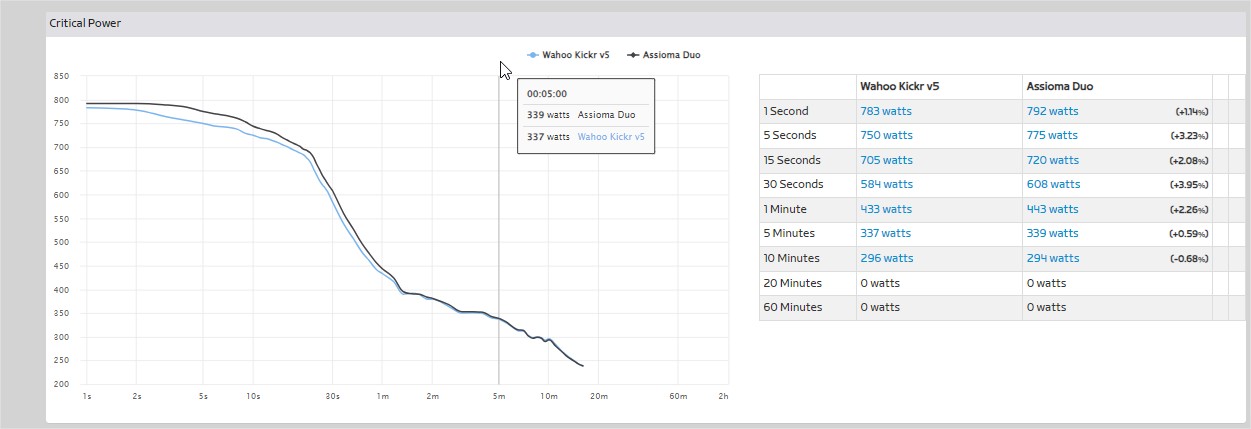

306W instead of 335 and I can’t figure out why.

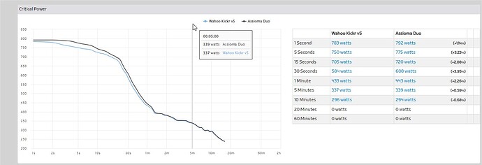

On the power data, I have 337W for 5min.
I made comparison of all curves in several tools, I have also 335-337W for 5min, only the interval power average is showing 306W
Intervals.icu - Google Chrome_24
I made a dual recording (power is really close between 2 records) and the power average in the same interval is correct. See second interval of activity Intervals.icu
Thank you in advance for your help!
Martial

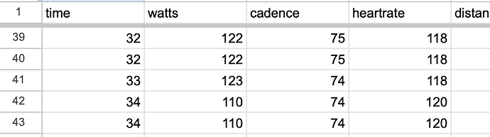

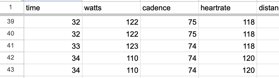

That file has very many duplicate records and I think that is throwing off the interval average calculation.
I should be able to fix that at import time.
I have deployed a fix to get rid of the duplicate records and the interval average is now the same as on the power curve.

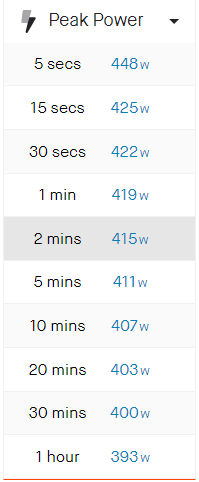

I’m wondering something similar from my July 23rd activity. I did a 1 hour test indoors, and while intervals says my 1hour average is 391W vs. the 393W reported by the recording app and strava (could be a kJ average vs. linear average difference), my calculated FTP is showing 383W from “41min at 388W”, which doesn’t make sense to me. Any thoughts?

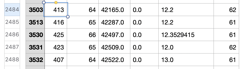

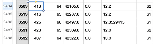

That ride as some large gaps in the data. The first dark column is seconds and you can see a 10s and then 17s gap here but it is mostly 1s per point.
Intervals.icu does interpolate to close small gaps but 17s in a 1s/tick activity is too much.
You can see the moving time is only 48m because of those gaps. This is also causing the total work for the activity to be less and lowering the power curve (work / elapsed time). The interval display is more lenient with respect to gaps.
I am not quite sure what to do about this …
Ahhh; thank you.
I’m guessing it’s from me texting my wife a few times mid-ride, with my phone doing the data recording at the same time. :slight_smile:
You can ride at nearly 400w for an hour and text at the same time? :slight_smile:
It was a good day, and only a few texts; eating the granola bar about 40minutes in almost caused me to blow up, though!

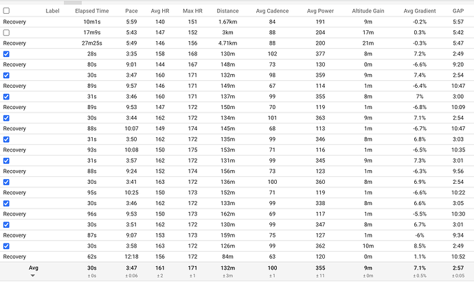

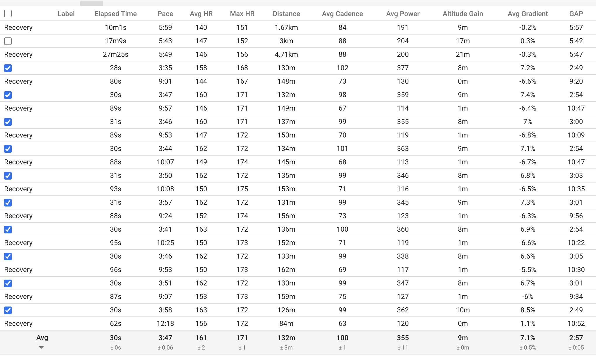

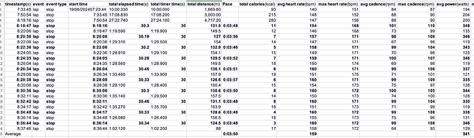

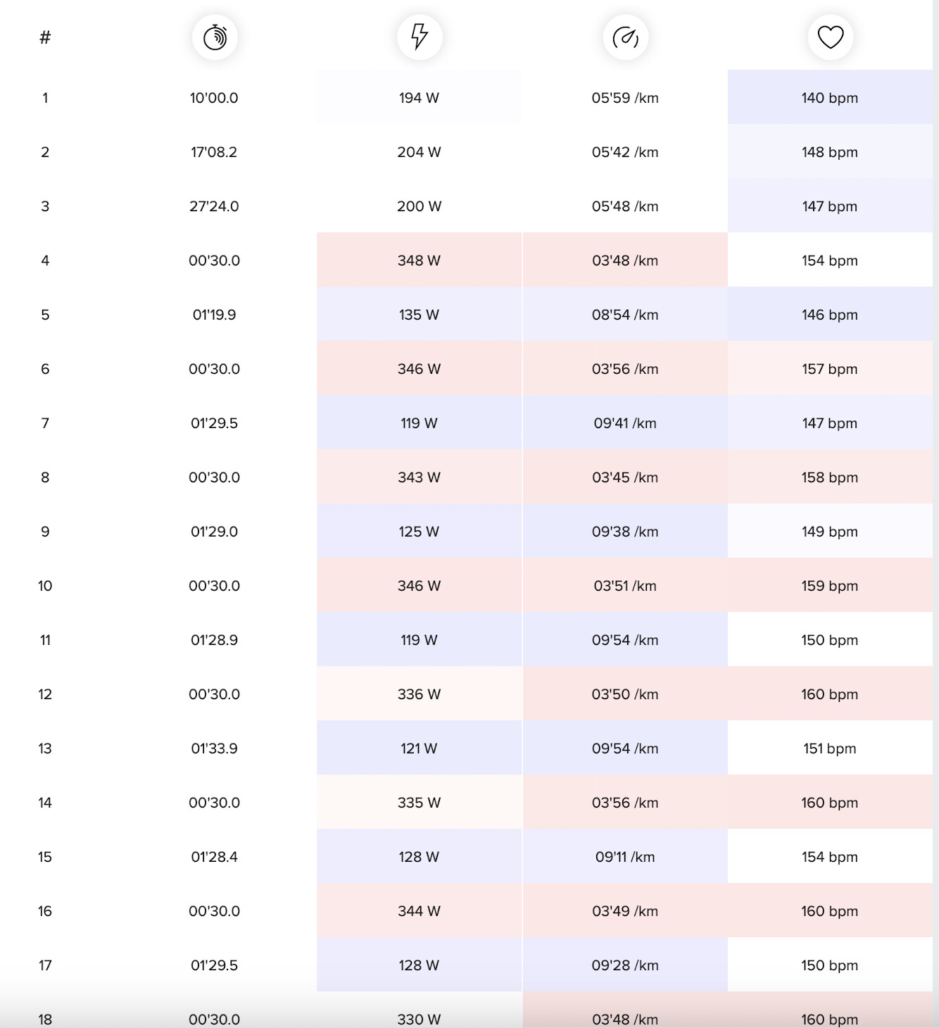

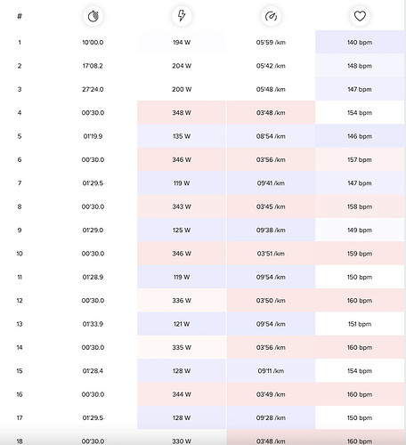

I have this activity - an easy run with 10x 30 seconds hill sprints - where intervals data are very different than what displayed on Suunto App. I extracted the fit file and analysed “laps” in Excel, they correspond to Suunto App. What could be the issue?
Intervals.icu uses the start and end of each lap but computes all the stats from the power, heart rate and other traces. This is to support editing the power etc. and editing the intervals.
Unfortunately often this does not match the data computed by the watch and stored in the laps. That is “higher resolution” than what is available via the activity data traces.
Thanks for the quick reply @david
So is there a way for me to edit those intervals to match the actual ones? I tried by editing start/end time of an interval, but it automatically changes the lap distance, too, and the result is not what I’m looking for.
Intervals.icu should already have got them as close as possible to the laps. If you download the streams CSV from the activity data page and open it in Excel you will see what I mean. Intervals.icu uses the start time of the interval to find the start index. Sometimes this is between time ticks. It uses the larger of total elapsed or timer time to compute the end time and hence the end index (exclusive). Again this might fall between ticks. Then these indexes are used to calculate average power, duration etc. from the streams. So you can see how it might be different to the laps.
