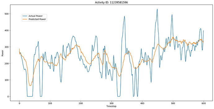

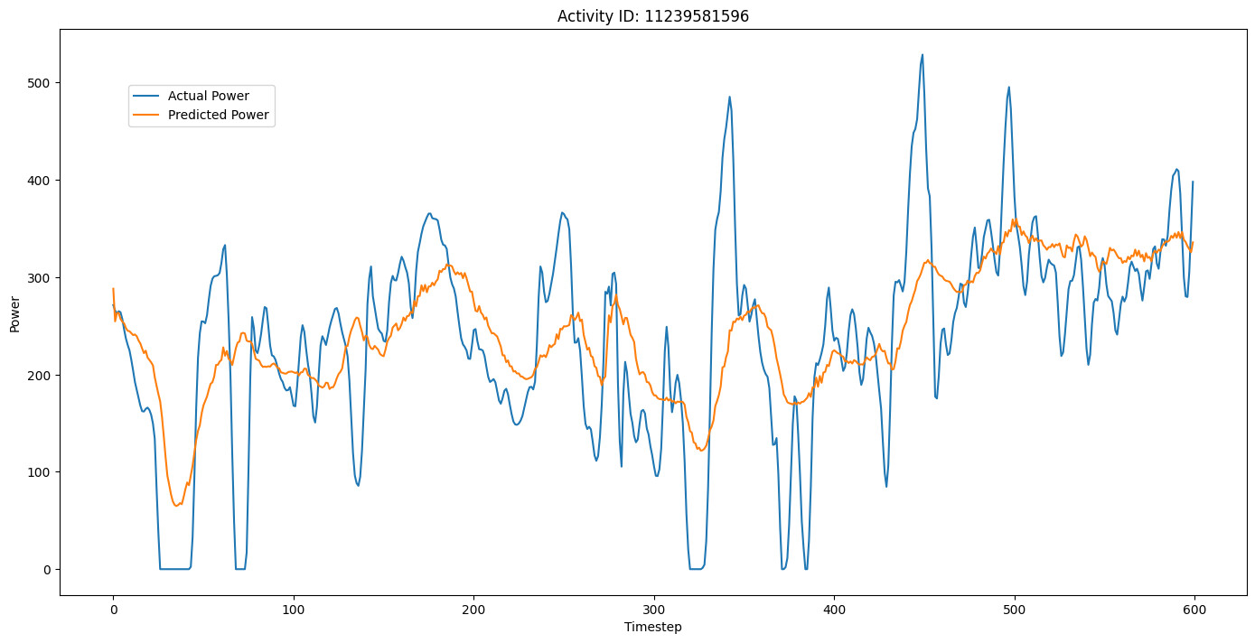

Hi guys, continuing my work from here:
I am developing a new feature which is a power and food consumption prediction program. I am training a ML model with my freerides (no workouts = no target power), and depending on the track and training stats (ATL, CTL, weight, etc), it learns how many watts I will give in any route section.
For now I am getting roughly 0.85 of accuracy for 3s avg power which is quite good.

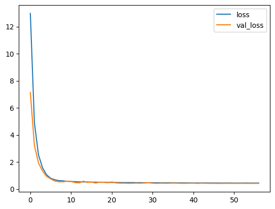

Here are some advances I achieved:
I am using the following data to train the model:
  • grade (compared to previous point)
  • distance_meters (total distance)
  • ascent_meters
  • distance_diff (distance from previous point)
  • atl_start / ctl_start (atl and ctl before the ride)
  • watt_kg
  • temp
The training process looks ok, but I need to tweak the model a bit more, maybe use 5s avg power, as power is quite noisy.
