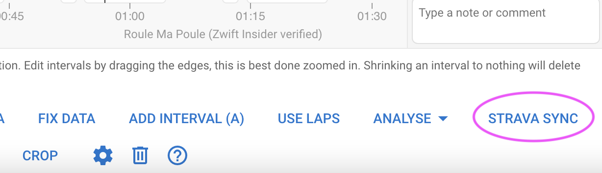

I was just playing around with the fix data functionality and was reverting my data with “Strava Sync”. Now that you are also gathering data from Garmin without dependency on Strava will this also resync from Garmin Connect?
Yes for Garmin Connect activities it says “Garmin Connect Sync”. Note that this functionality is currently broken for many activities. I have fixed the problem and am going to deploy Monday AM (GMT+2).

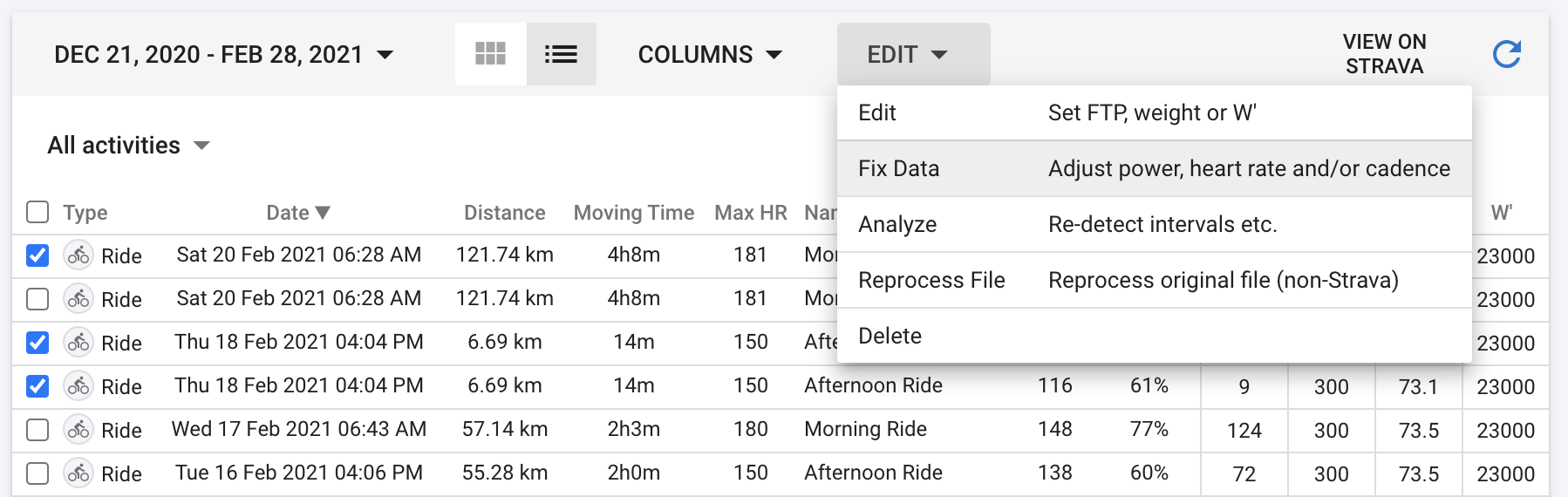

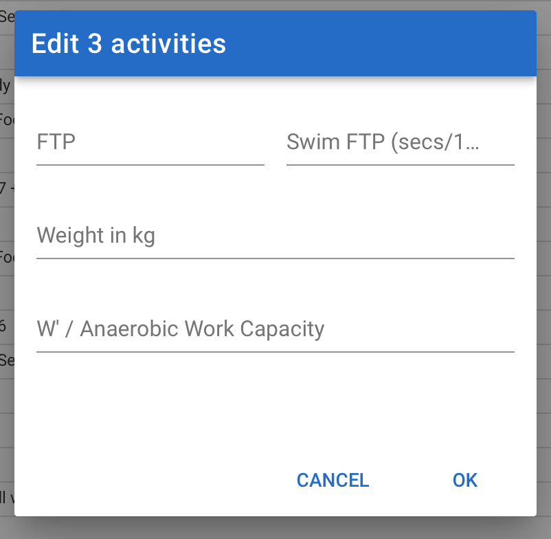

You can now bulk adjust power and/or HR and cadence data for multiple activities at once on the activity list page (click the list icon on the calendar page):

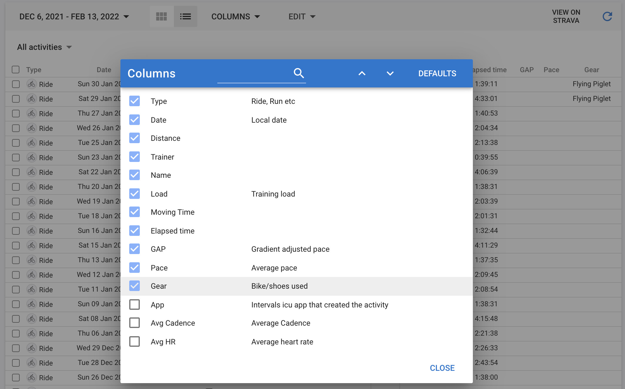

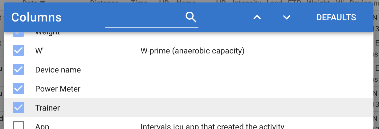

Adding columns and sorting can help find the activities you need to edit:

is is possible to add the “Type” in the multi edit window please?
thanks!
You can filter the activity list view to only show activities with a given type (or types) and then update only those.

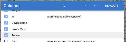

David, is there an easy way to see or sort by bike so I can adjust power numbers in bulk? Not sure how the data from strava gets imported into the site, but it seems to strip my bike and power meter info so I can’t easily bulk sort based on that.
Sorry, I wasn’t clear. What I meant was that I would like to bulk update the “activity type” field. not bulk update only certain activity types.

Yes Strava doesn’t give power meter info. You should be able to add the “Gear” column in the activity list view and sort by that:

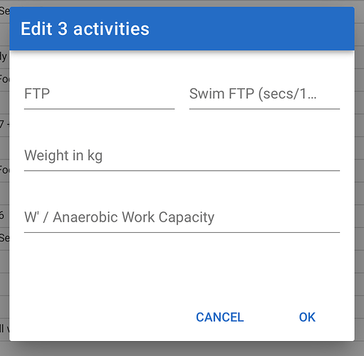

Aha. I have added that to the todo list. I already need to add threshold pace to that bulk update dialog.
