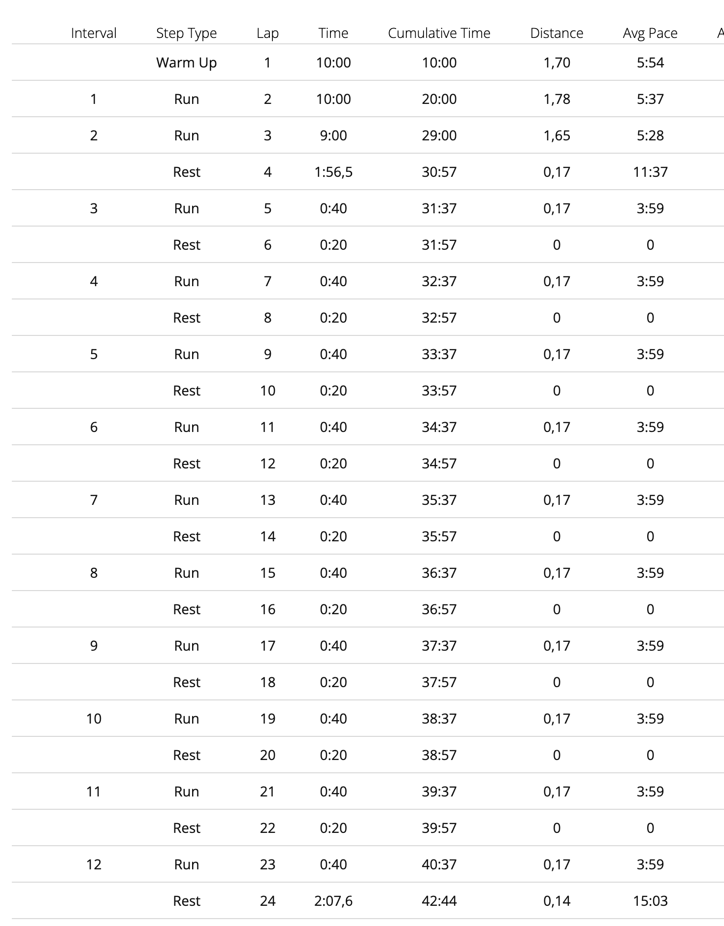

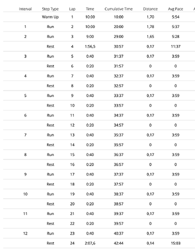

Garmin Connect (reference)
The workout steps/laps are shown consistently:
  • 40s reps = 3:59 /km
  • recoveries = 0 distance as expected
  • durations and distances coherent

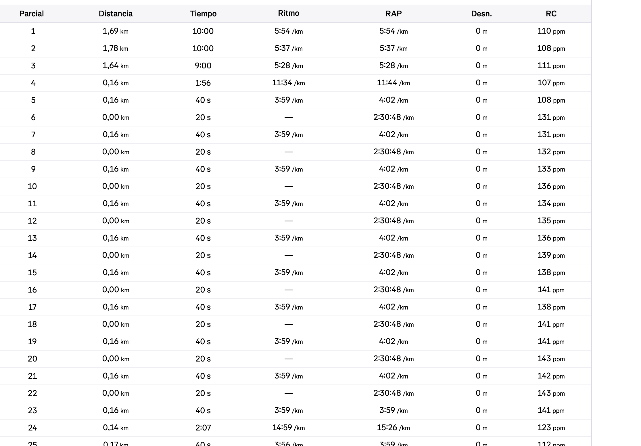

Strava
Using the same file, the laps are also shown consistently:

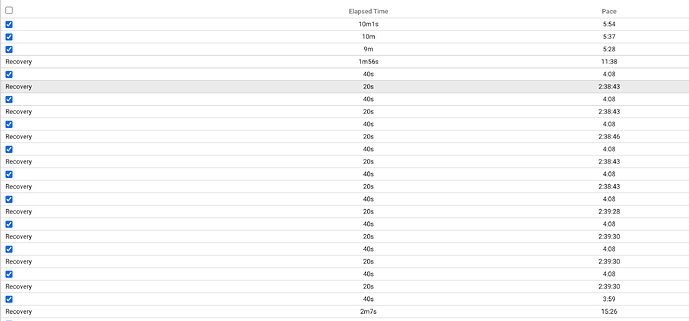

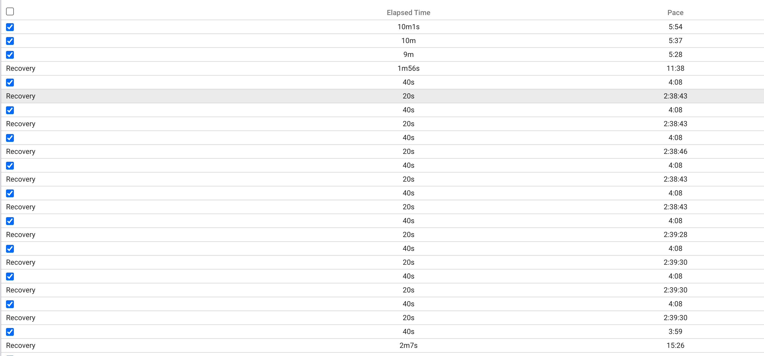

Intervals
Several 40s reps are shown as:
  • 4:08 /km
while a later identical 40s rep is shown correctly as:
  • 3:59 /km
So equivalent intervals inside the same activity are not being calculated consistently.

Intervals don’t use the laps summary for intervals metrics calculation. It’s based on the streams and therefore can be different from the summary fields
And the stream shows the correct values. I am pretty sure that the error comes from erroneously including one sample after the end of the 40s lap in the average computation. Pace should be 3:59. Only 1-2 samples at zero speed added to the average are enough to produce the wrong pace. It doesn’t happen on the last 40s lap because the speed doesn’t go immediately to zero at the end of that last lap, as in the previous ones.
I don’t understand. You tell the speed doesn’t go down in the last lap, and because of that you want the pace to be the same?
What do you mean with the stream shows correct data? Can you show an interval stream?
That is a totally erroneous assumption because Intervals isn’t using the velocity stream for Pace calculation of intervals. It uses the distance stream and the time in between end and start. Total distance over that time difference gives you the avg pave for that interval.
For GAP, the velocity stream is used because the GAP needs to be calculated point by point based on velocity and elevation change.
