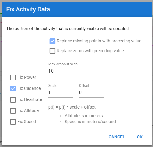

If you just want to edit it to a reasonable value you can do that with Action → Fix Data, and for example set it to xx rpm for the whole activity.
I can’t set the RPMs for the whole activity:

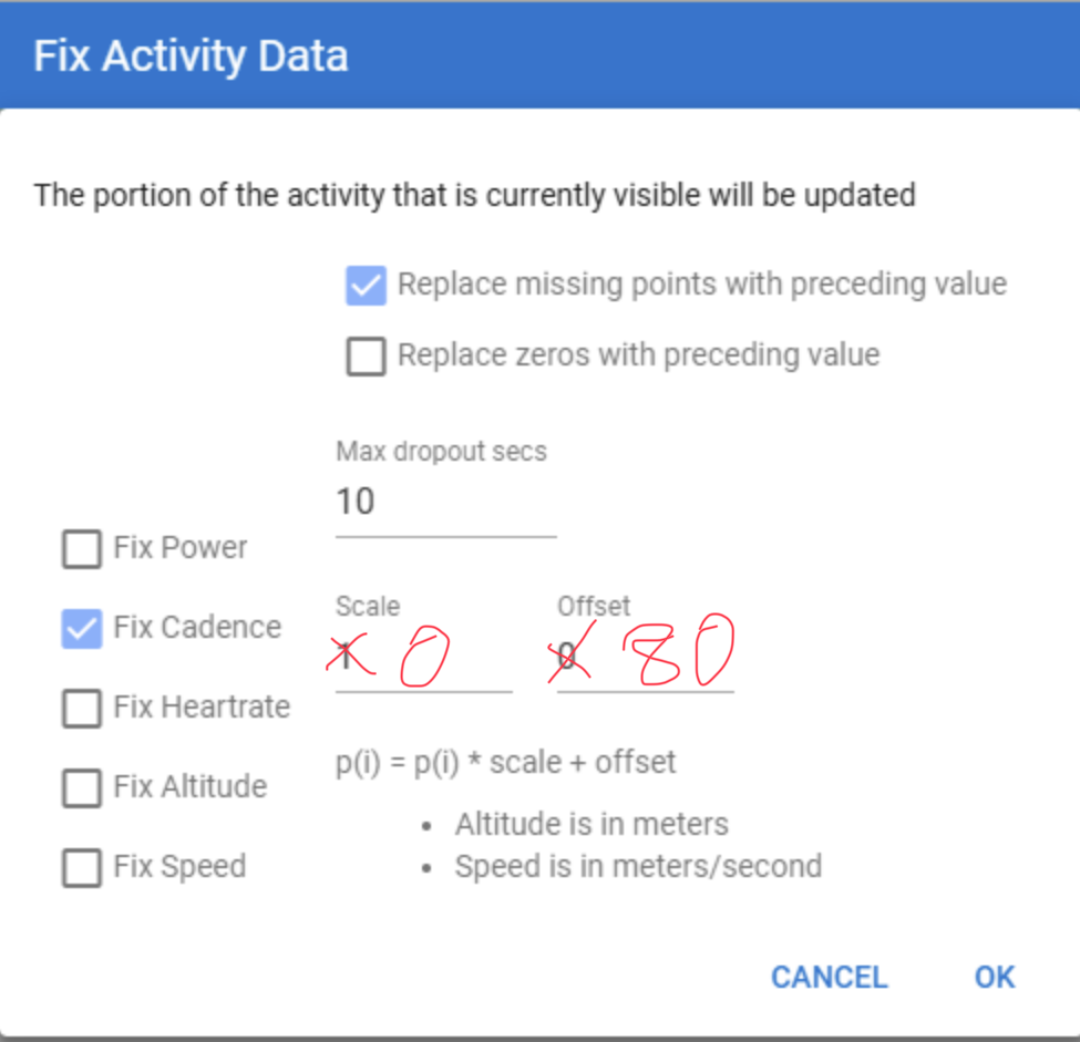

If you want to set it e.g. to 80 rpm, set the scale and offset values to:
Thank you!
