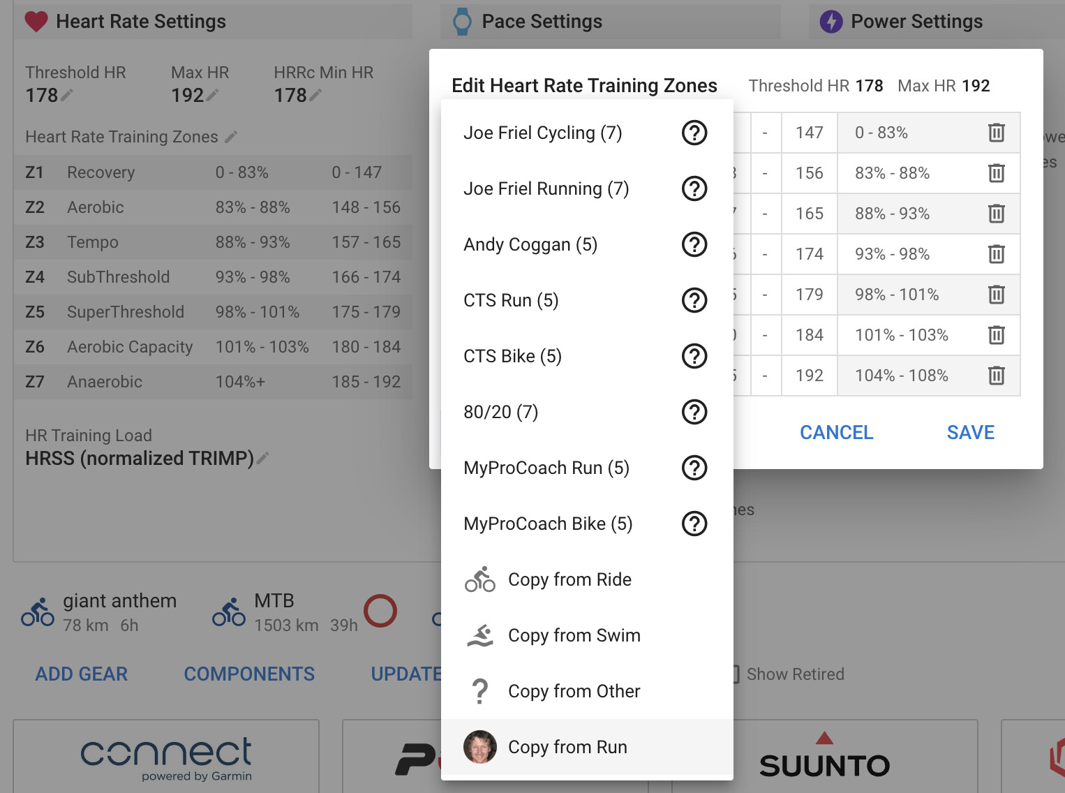

The soon to be released big Intervals.icu update supports fully customisable training zones. There is a “Defaults” button that puts in Joe Friel’s zones. Any other sets of zones I should add to a “Defaults” drop down? I need %FTP or %LTHR or %MaxHR for each zone, then its easy to implement.

Yes you can now have between 3 and 7 zones (+ sweet spot for power) with whatever names you like, different for each sport and separate for HR and power. Pace zones are under development. I had to cut that for the first release just to try control scope.

I need to come back to this because I want to make a specific training zone to use in ALL the athletes that I train. And once its costumized (I use Jack Daniels), I need to update EACH athlete with the percentages that I really want.
TLDR: There is any way to implement a costumized training zone in order to use to all the athletes that I coach??
You can copy your own zones onto an athlete you coach using the presets menu. Your zones for the sport appear at the bottom of the list:
