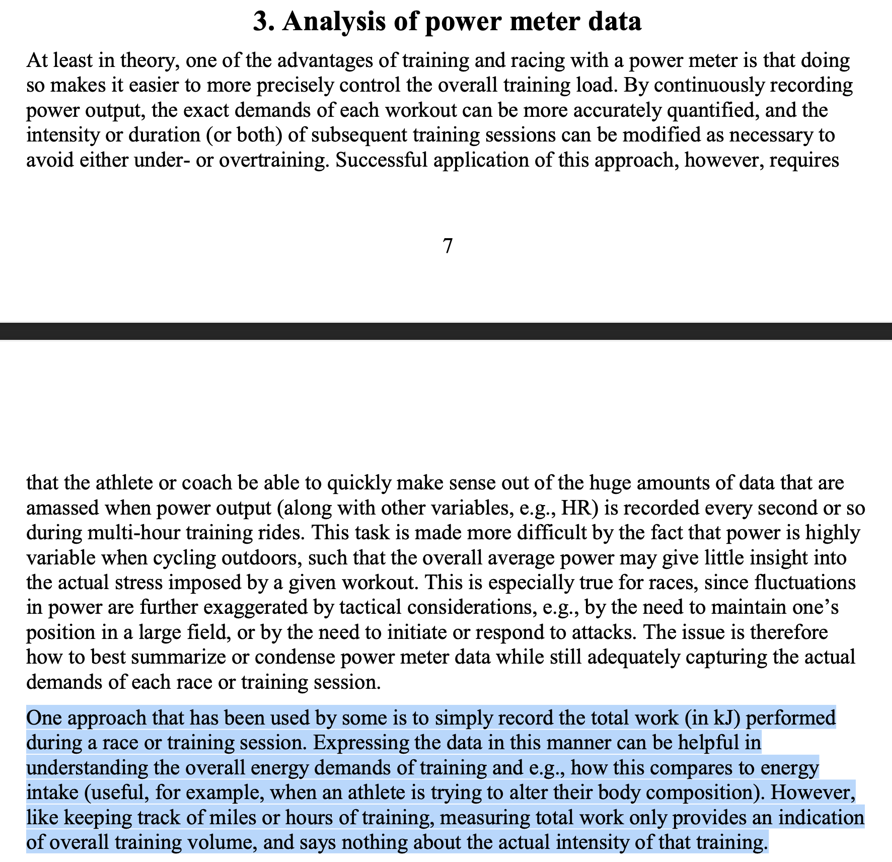

Coggan paper from March 20003, in a presentation to coaches at USA Cycling training event.

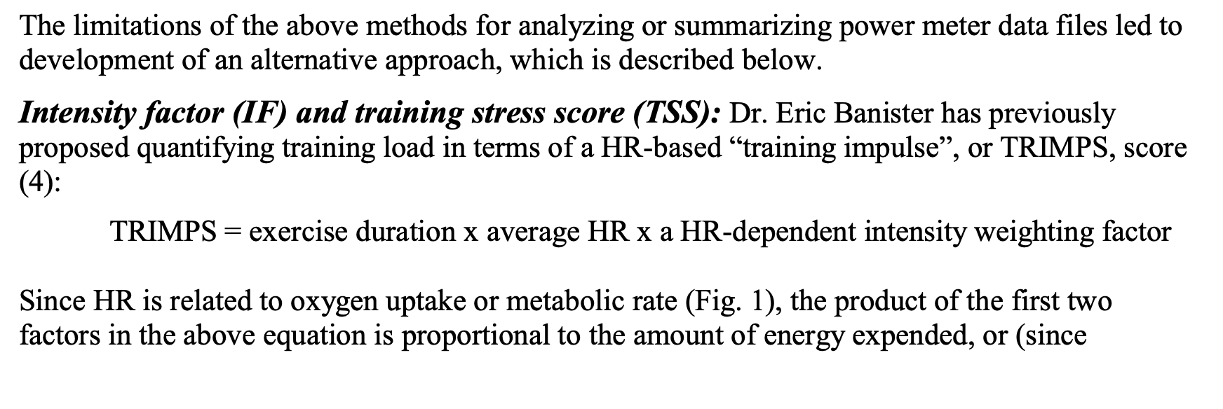

another approach:

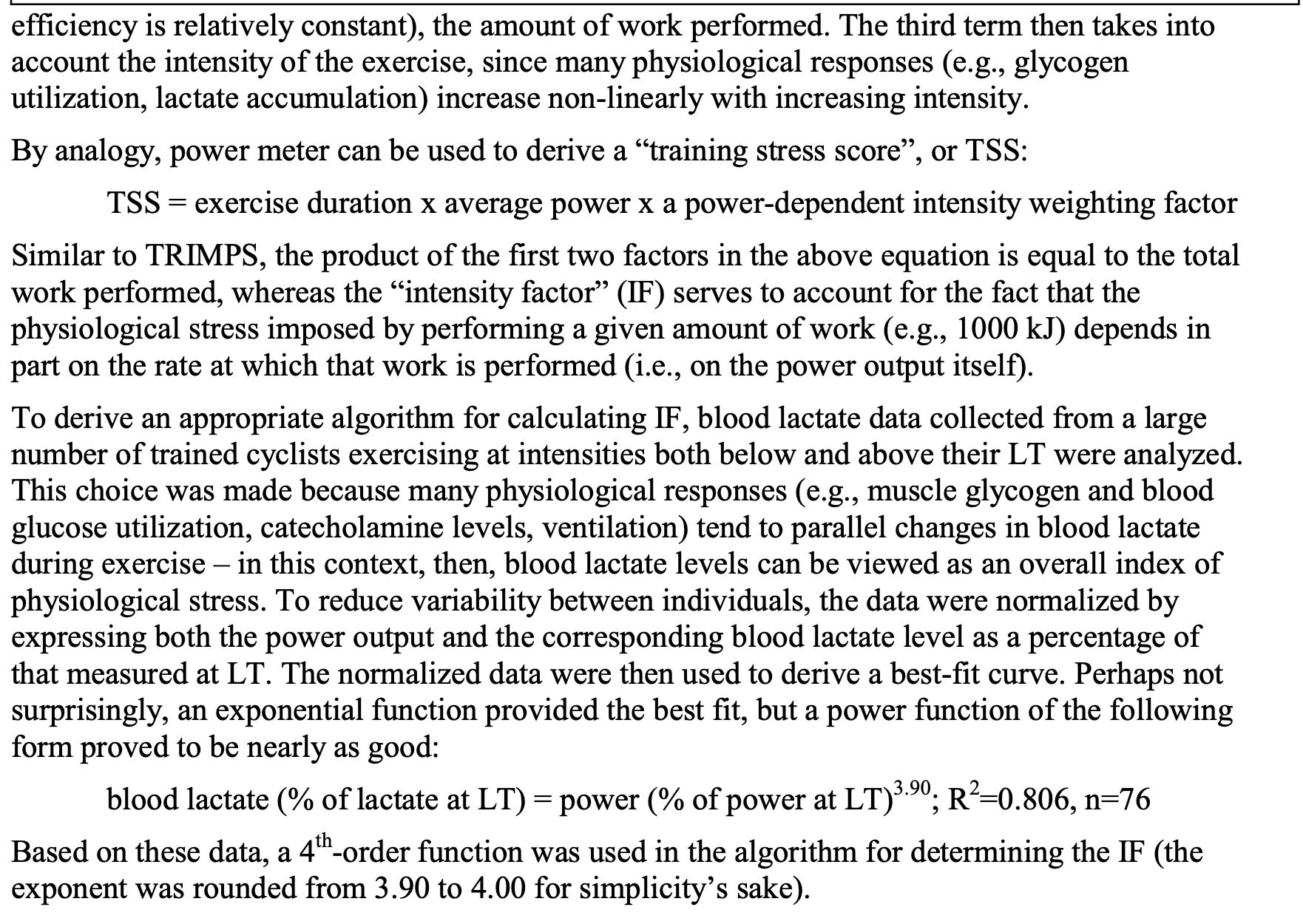

which led to the development of another method, built on established model

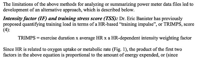

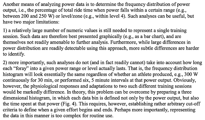

and

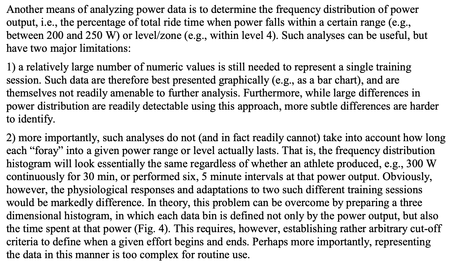

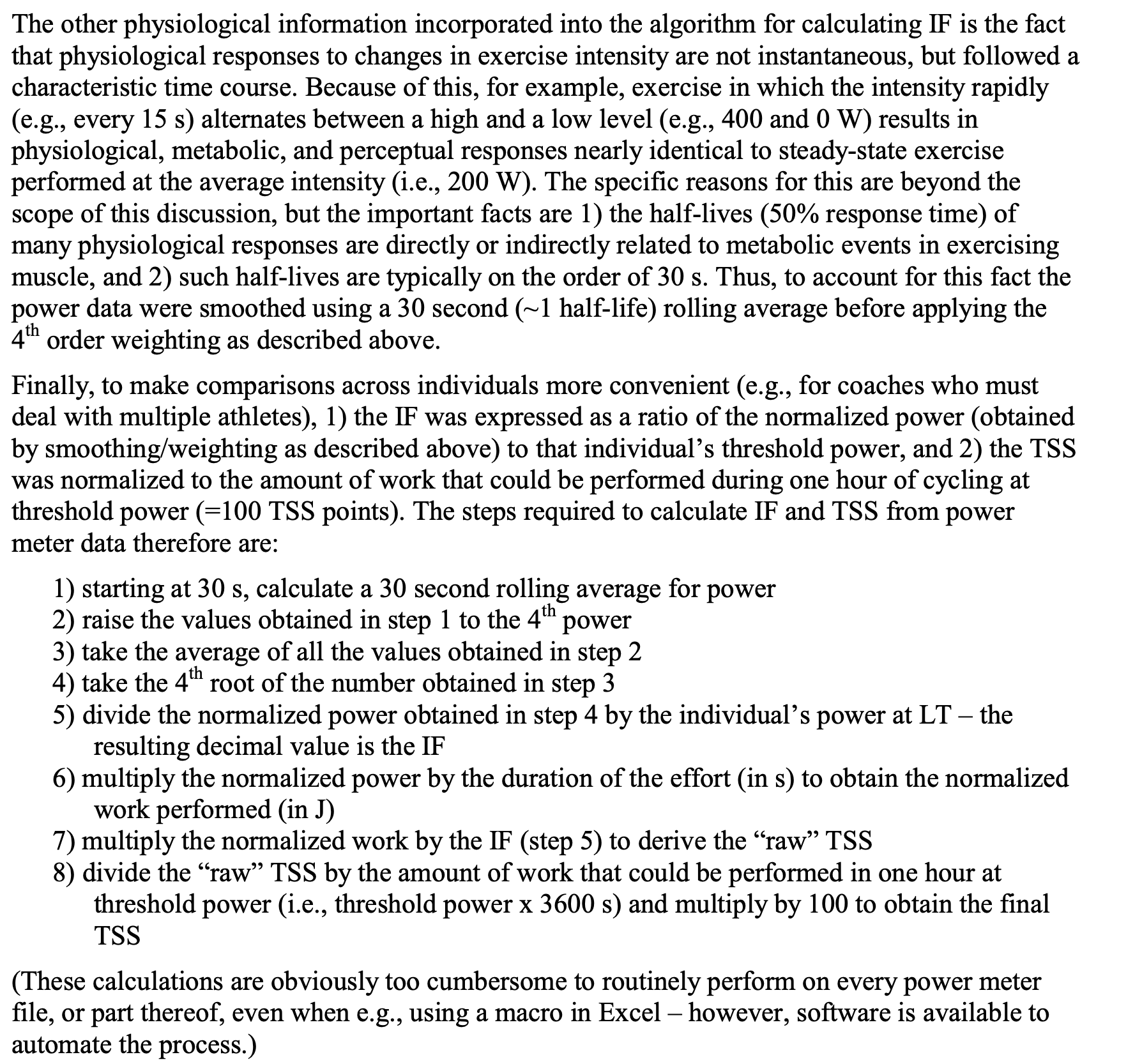

and continuing

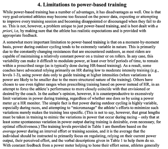

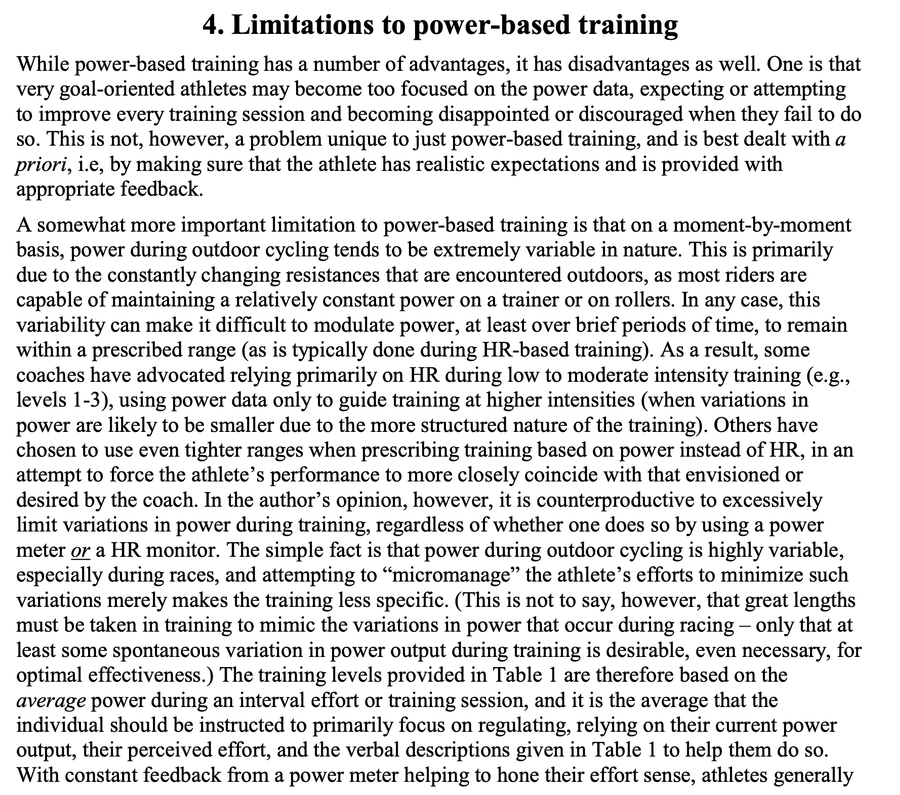

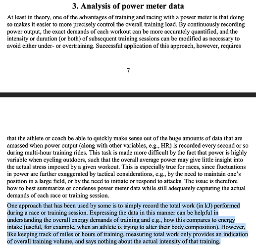

and limitations
