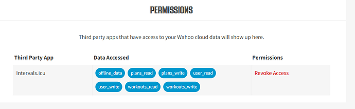

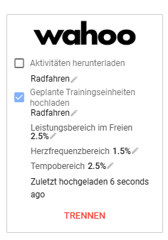

followed all the steps mentioned, but still have no workouts on my Bolt.
Does it also work with a Bolt v1 or is it too old?
2025-03-03 14_08_48-Intervals.icu und 11 weitere Seiten - Profil 1 – Microsoft​ Edge

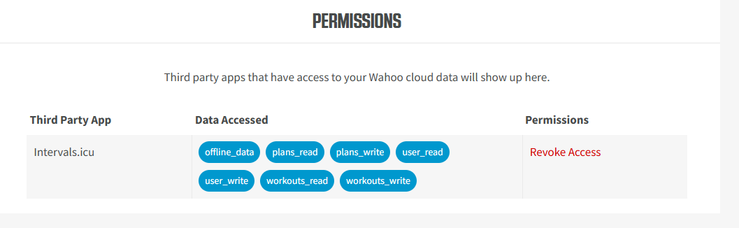

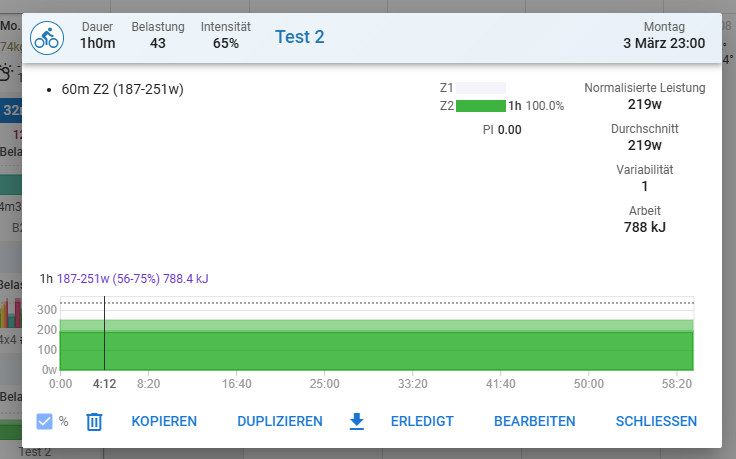

Despite having everything connected, I have no workouts on my Bolt.
Is the Training programmed in the right way?
Can anybody help?
Is the workout in the elmnt app?
After I posted my issue I re-done all the steps mentioned above and somehow in a magical way it works now, despite I done everything the same as before (at least I think so, but maybe I forgot somewhere something). But thanks!
