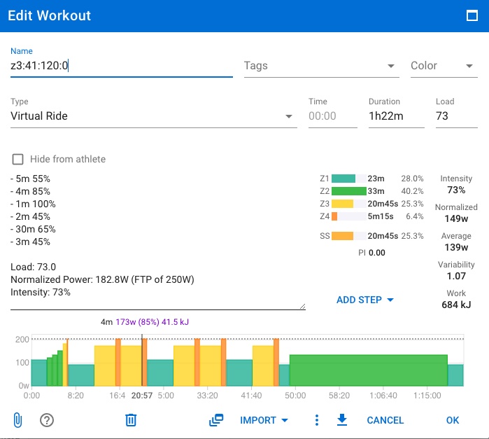

  2. Click on the plan in the library at intervals.icu
  3. The load and duration of workouts in the plan view look correct based on the input to Intertools. For example: z3:41:120:0 should create a workout with load of 41.
  4. Click on the workout and the duration and load in the editor view are different from the the plan view.
  5. If I press CANCEL, nothing changes, there is still a mismatch. If I press OK, then the duration and load in the plan view update to match what was shown in the editor.
Logging out of both Intervals.icu and Intertools seems to have resolved the issue. Maybe because I imported a plan with the same name over and over old data was being imported? I deleted the plan from the library before importing a new version, but I guess logging out and back in cleared the old data?
