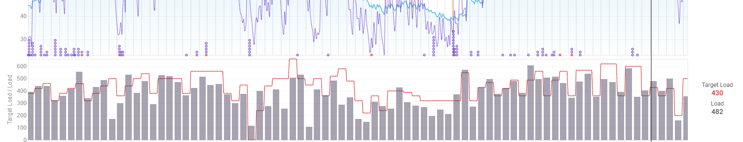

You can see it in a chart.

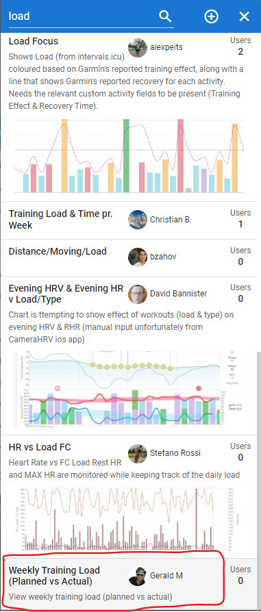

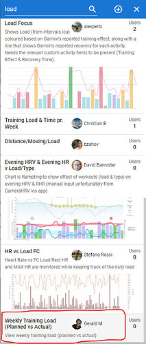

You can use one I’ve shared, and change to suit your requirements

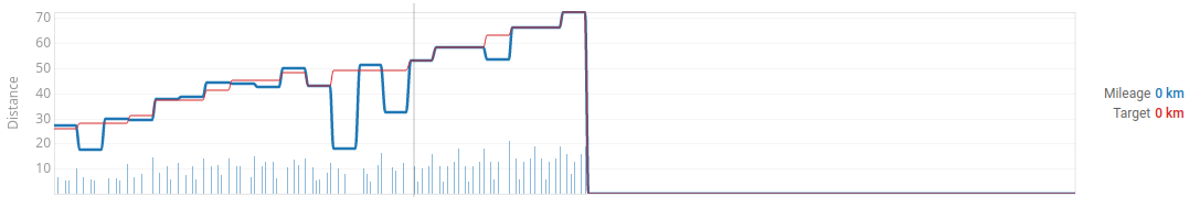

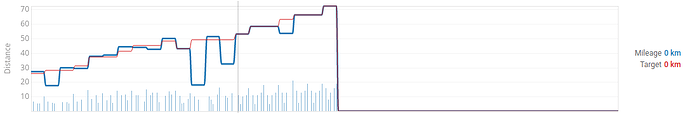

That would be Target and not Planned Load - I ran into this while trying to chart planned vs actual mileage:
One difference is that, as far as I can tell, you can only set targets for a full week while you can have a daily planned load (via planned workouts).
This approach also requires you set the your weekly targets instead of automatically calculating it from your planned workouts; That’s what you’re doing here, right?
I’m using the target load as the weekly planned total, and comparing my training in weekly buckets within each mesocycle (2+1 week cycle).
The majority of my rides/workouts aren’t the same as the daily planned load due to the but within a few %. A missed session, remains a missed session.

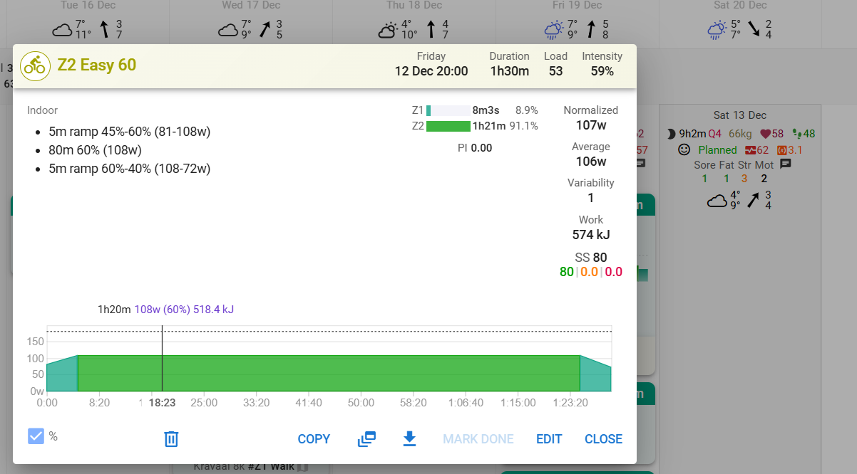

Looking to re-open this thread. How do you look at what was planned for a specific workout after a workout has already been uploaded. For example, If I had 2hrs of Z2 with a load of 105, but go out and hammer for 1:15 in Z3-4. It says I had 101% compliance. But that’s only reading load. I didn’t really comply with the workout. Is there a way to set it so the duration and zones either show or are also factored into the compliance? This could be important for managing multiple athletes.
Just click on the paired Planned workout (lower part of the activity) and you will see what it was.
