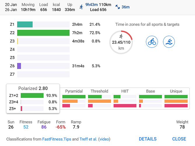

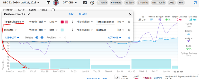

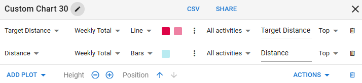

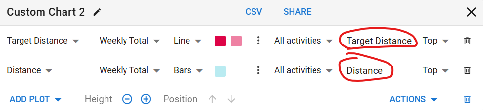

If you add your target distance, then you can plot target vs actual.
Target distance is added in the weekly summary popup

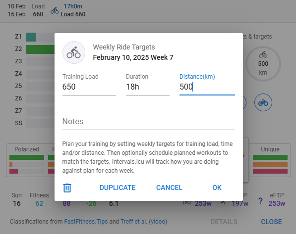

Thank you @Gerald.
Should I add a value for Target, assuming that it is not required for distance as it will pull through from the activities completed. The targets will differ from week to week, so how do I add values if I want to do it for each week?

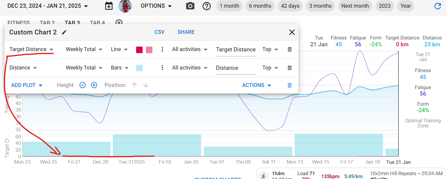

I’ve added it, but the Target Distance stays flat, whether I add a value or not.

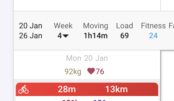

And lastly, where do I get the weekly summary popup? Sorry for my dumb questions.
PS: This is for running.

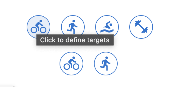

click the calendar.. Here I am clicking on the “moving”
then click any of the icons
if they differ each week, i think you’ll have to input it each week. Not sure, I don’t use it
Aaah, got it, thanks.

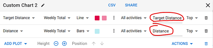

For this week, it is showing the progress nicely.
And on my custom chart as well.
And I could do it for each week.
Thanks for all your help.

Yes, each week has to be added manually, for now, for distance, duration, and load per sport.
These are planned values, and not necessarily “targets” to strive to achieve at all costs.
It will change, I guess, when the Annual Plan is available, allowing editing in an easier format. This is something I’m sure David is busy with, along with all the other changes.

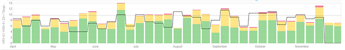

I only use load and duration, not distance on my chart. This chart is Target time vs Time in Zone (3)

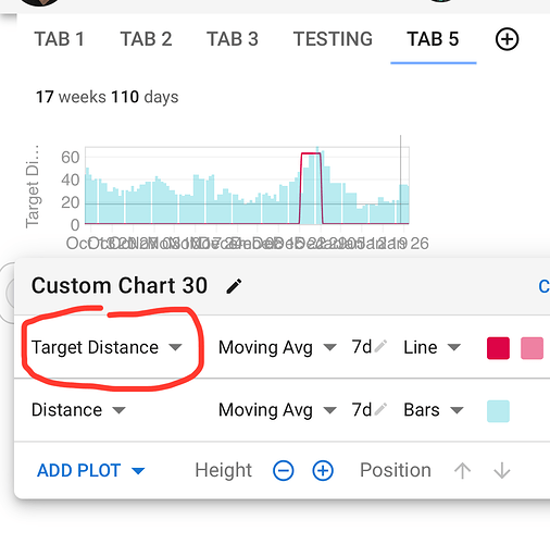

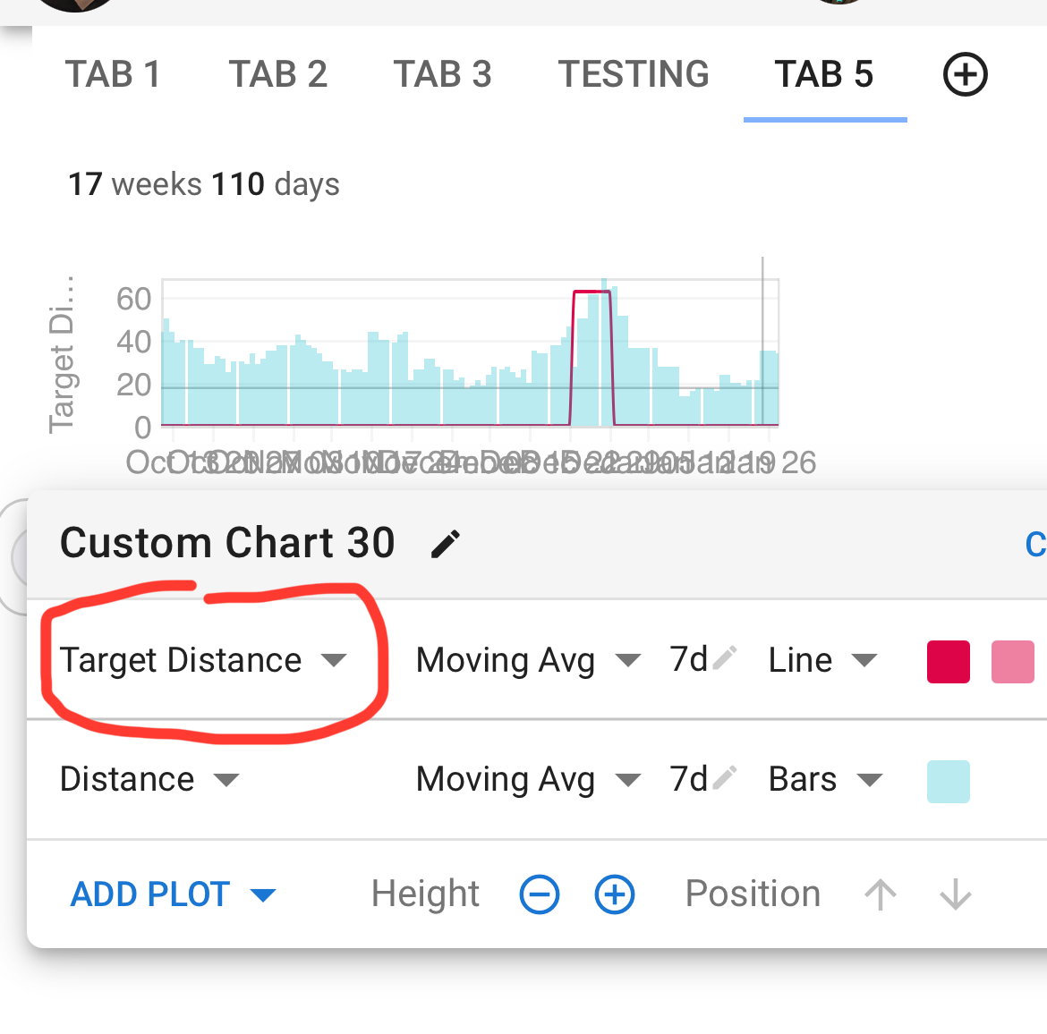

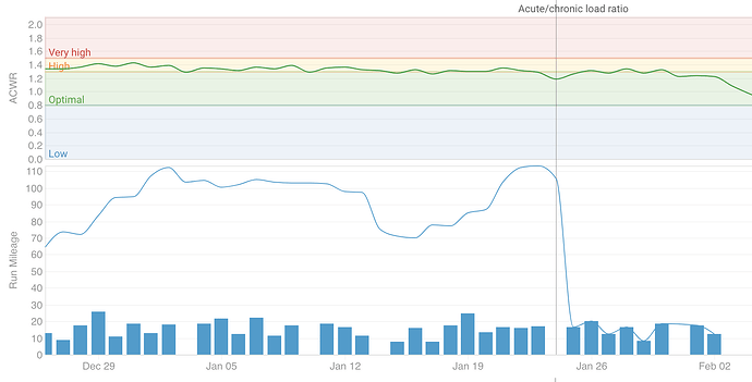

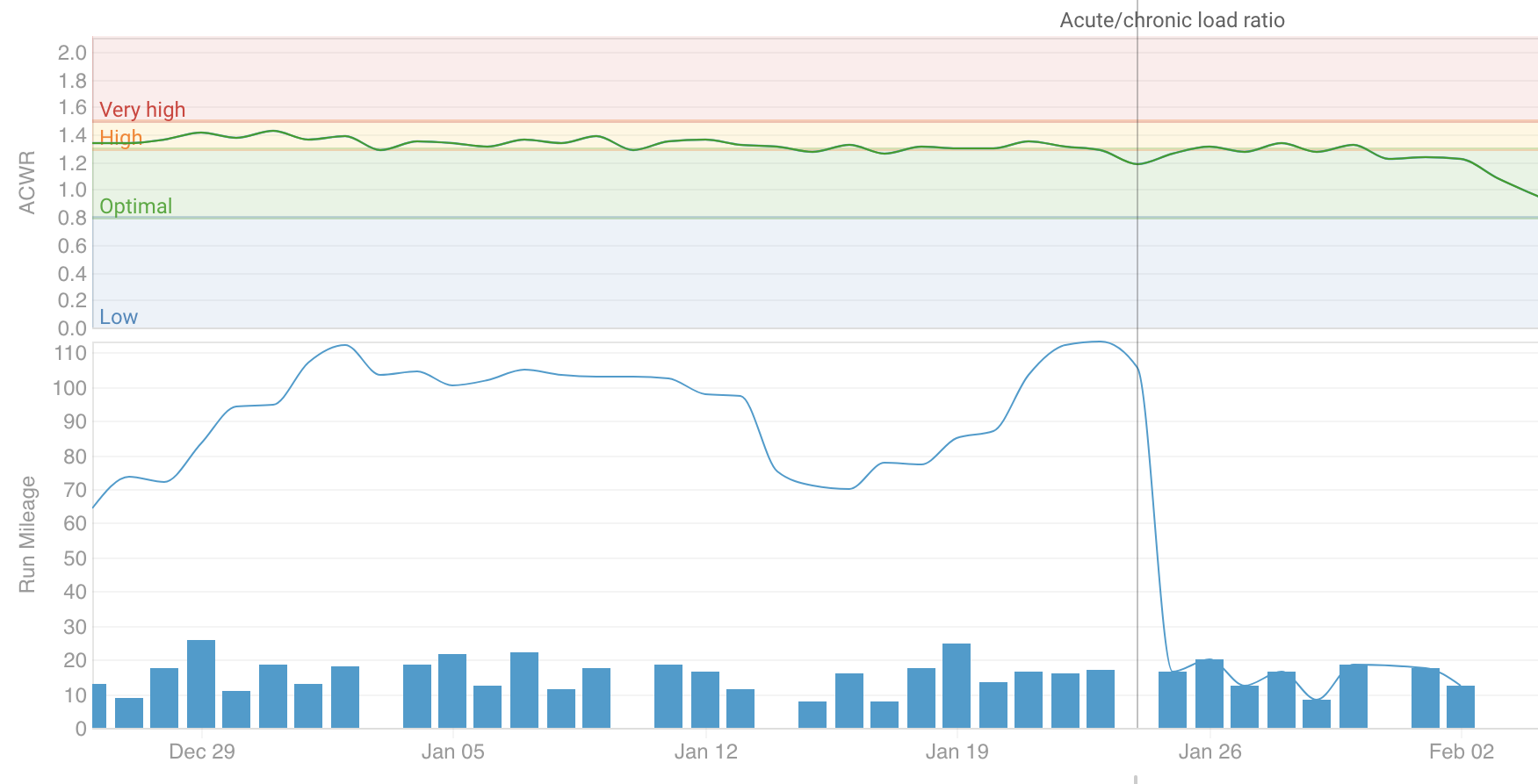

I am using the “Run Mileage” custom chart with a 7d moving total. It works great for completed runs, but it doesn’t include planned workouts - as the ACWR does (seen at the top).
Do you know if it possible to include planned workouts in a moving total calculation?
Appreciate any help, thanks!

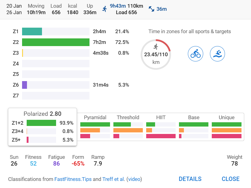

If you add the planned mileage in the weekly summary, as shown above, you use the field target distance for the future planned distance. It requires summing your workouts for each week.
For workouts, you cannot add distance in the workout builder, so target distance is the better option.
