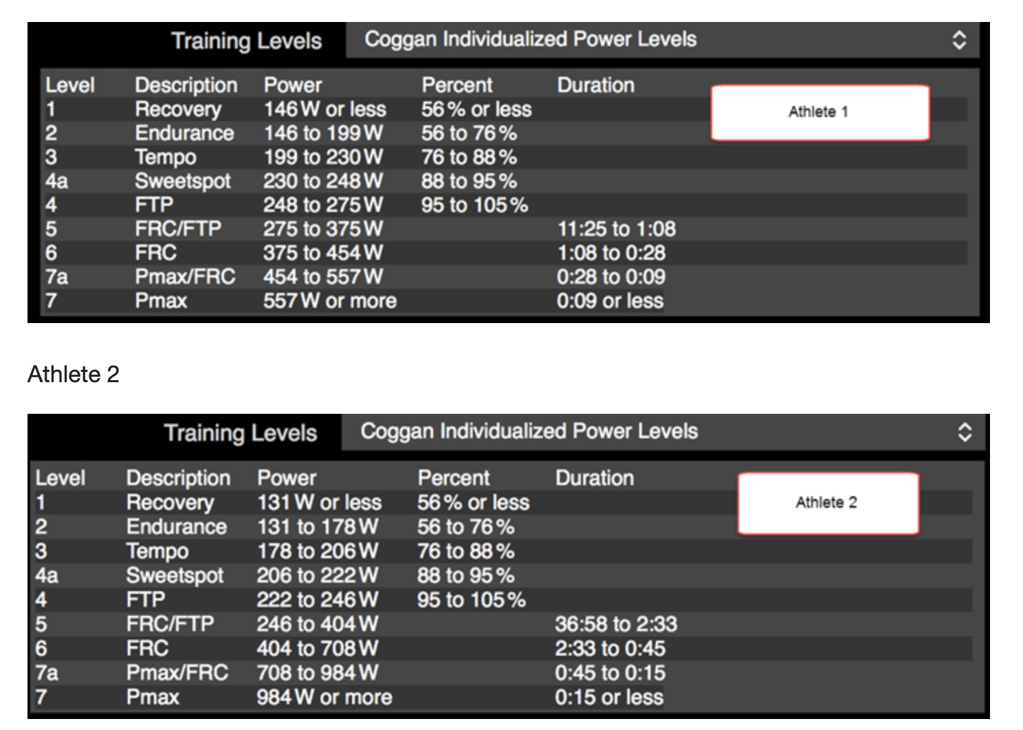

Below is a screenshot of the kind of thing you get from WKO. I’m trying to find out how the person applied it to tweak Trainer Road targets - whether it was a bit of trial and error or if there was more of a formula applied.
Sorry I can’t add much more information! It might be that the iLevels are a bit of a red herring. The meat of my query is more - can the power data and curve collected by Intervals in some way be used to predict your ability to perform intervals at Z5 and above?
