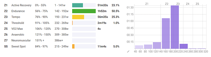

I noticed that time with 0 Cadence and 0 Watt counts toward Active Recovery (Z1), which is supposed to be 0% - 55% FTP and 1-xxx Watt.
On this ride, I spent about 28 minutes in Active Recovery (Z1), but the bar chart says it was about 51 minutes.

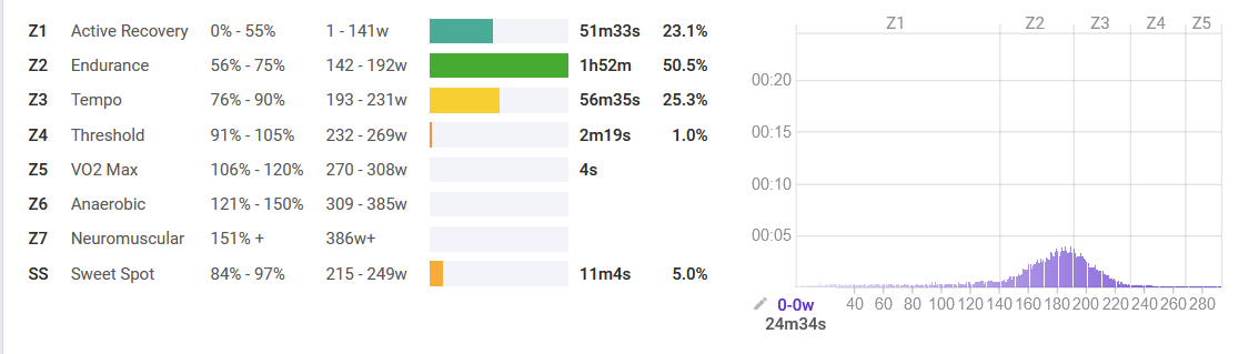

Looking closer reveals that I was about 28 minutes at 0 Watts. Yet, the time at 0 watts is counted towards Z1.
Isn’t it confusing, for instance, when assessing total time ridden or time spent in Z1, if coasting counts towards Z1?
Intervals.icu allocates all the moving time in the activity to one of the zones using a 5 second moving average of power. The chart is misleading starting at 1w. I think if I did it again I might do it differently but changing this now would make people unhappy.
There is a separate coasting time field and coasting %.
