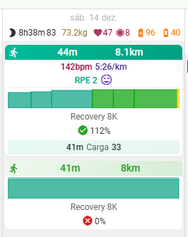

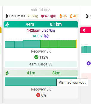

This workout have not paired. already dragged but nothing happens. They are very similar, was expecting the pairing to happen. Any hint? Or why i still the bottom workout? Should i just delete the bottom one? Thanks
It is paired already because you have a 112% compliance.
I think you inadvertently created a manual activity and a planned workout. The planned workout was paire to the recorded activity, but the manual activity is still there.
Okay, thanks. Going to delete the bottom one (Manual activity). I did no create anything, will keep an eye on this how and if it happens in the future. Because when i hover it says planned workout, the bottom one. Not really an activity added

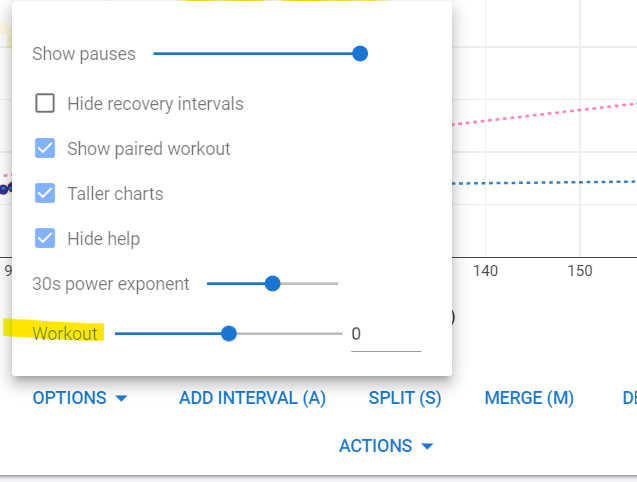

The workout timing was recorded to the FIT file while executing it, so modifying the workout file afterwards has no effect.
You can re-align workout and activity with the slider under Options at the bottom of the activity page:
That will move the ‘Workout’ stream to align with the activity.
