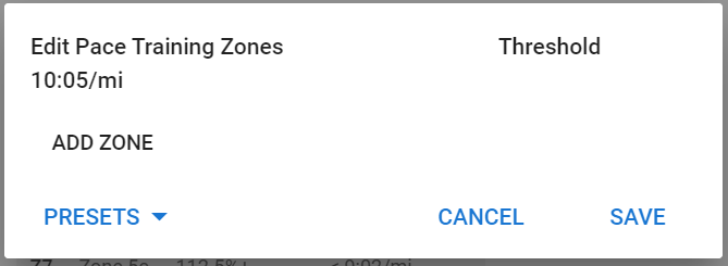

I’m fairly new to the site and love it so far. The workout builder is great, but I’ve encountered a couple issues trying to build workouts by pace:
  1. When I try to set-up pace zones the “Copy from Run” feature doesn’t work like it does for HR. I just get an empty list of zones and have to make the zones from scratch each time I add someone that I’m coaching. Also related is that the “Add Zone” button doesn’t seem to do anything after this happens so I have to just start from one of the 7-zone templates and replace everything.
