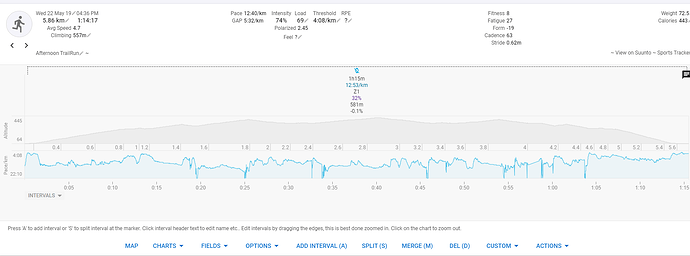

Is there a way of deleting a best effort for running. I had an issue with one of my runs where the GPS/HR/Power seemed to cut out for a mile then came back. It looks like some map data was retained as the map is correct however I’ve been left with spurious best efforts
I guess I could just delete the run from Intervals but wondered if there were any other options. This is the section in question.

Actions - Settings - Ignore Pace and maybe Velocity
That should sort it.
Yes that did sort it. Many thanks!

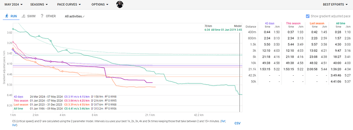

I am having some issues with my pace curves;

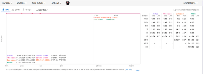

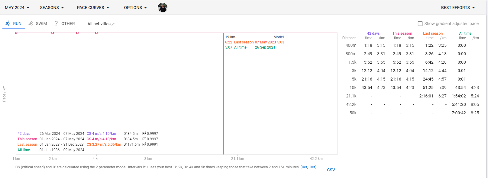

- All Time pace curve (not grade adjusted) data does not show up - it seems there are missing values? See attached picture

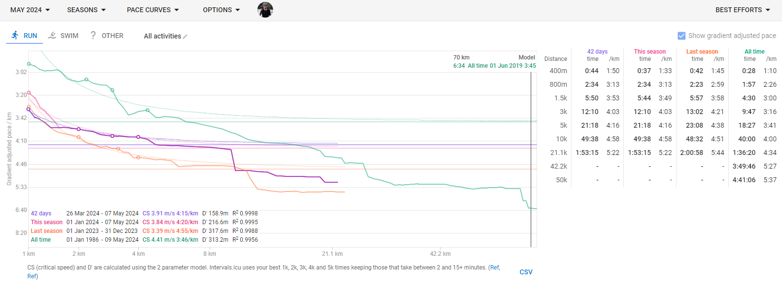

- GAP curve for All Time shows up → BUT there are a lot of outliers.
2a. it would be nice to have a filter to “Ignore all paces <xx:xx min/km” to leave out anything that is unreasonably high - beyond what my actual capacity is. Eg ignore my 2:09min/km 5km runs)).
2b. I’ve been going through to ignore segments of runs where I can identify a period of abnormally high pace - but that doesn’t always seem to fix the issue. But even identifying short blips in my run with a high pace - doesn’t make sense that it would lead to my pace curve showing 1:09/km for 1.5km. I wonder if because its GAP - issues in elevation change will create extreme values for GAP? Even though unadjusted pace looks reasonable? I’ve tried ignoring pace for the entire run for some of these runs but this still doesn’t seem to fix my GAP curve.

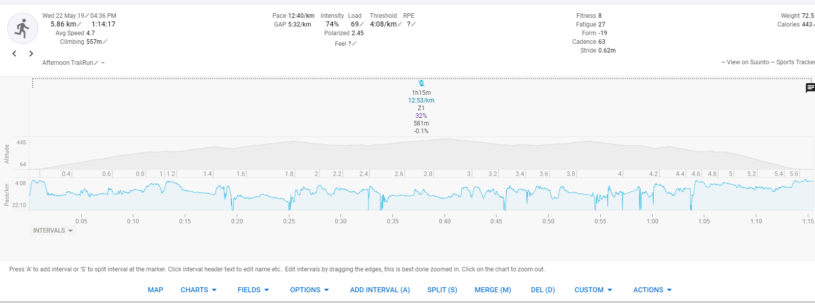

In the screen shot of my activity - you can see there is no 1km period with a pace of 2:58min/km
Any help would be appreciated!
