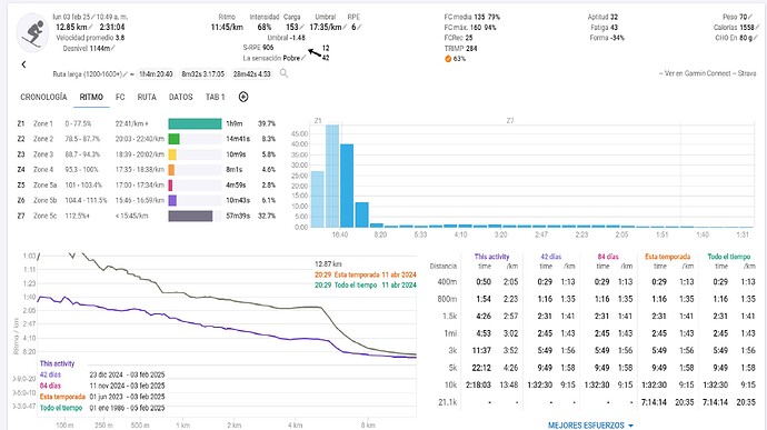

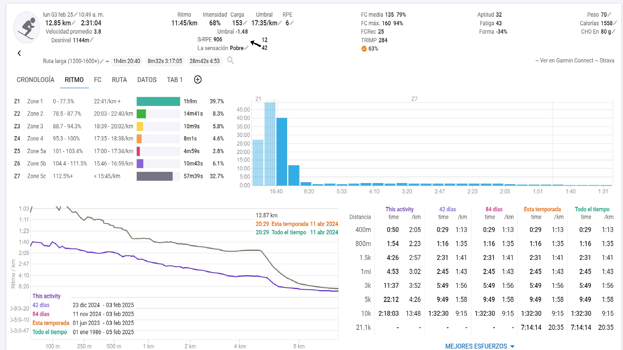

Pace ascent not taken into account
How to make sure the pace is not taken into account during the descent (Z7) in a skimo activity? What I’m interested in is the pace during the ascent.
Probably Actions - Ignore Part can achieve what you want.
I’m also interested in this for my XC Skiing/Nordic Skiing activities.
Also, does anyone know how to write a custom activity field that gets my average pace exluding the times when the gradients are below 0, ie. the descents.

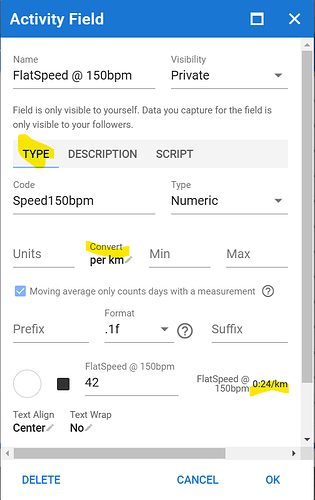

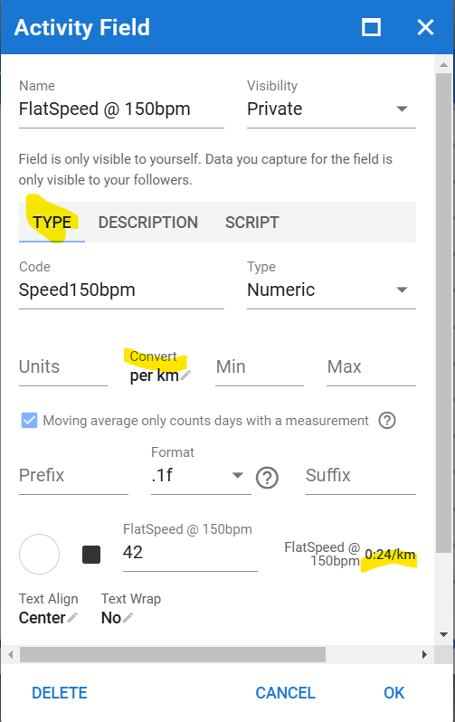

Using the streams ‘velocity_smooth’ and ‘grade_smooth’ will probably give better results.
velStr = streams.get(“velocity_smooth”).data;
gradStr = streams.get(“grade_smooth”).data;
Let the script calculate velocity and set the display options to convert to pace. That gives proper pace display as mm:ss/km.
