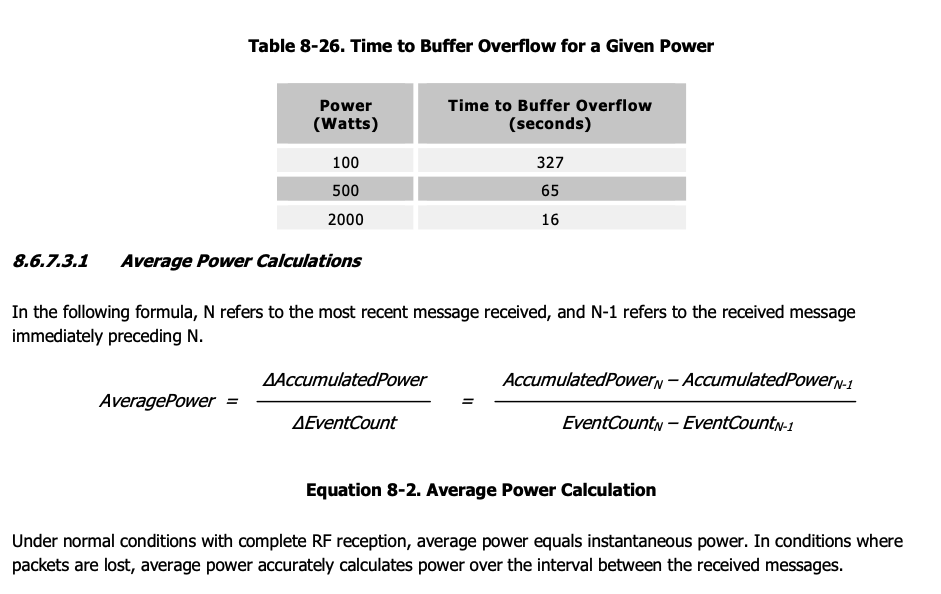

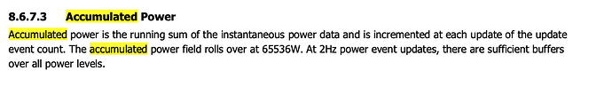

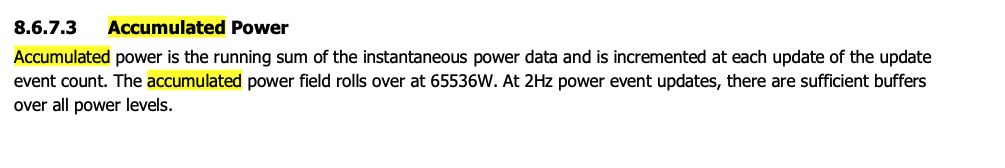

Is that Garmin or PM specific? I don’t see accumulated power in my fit file recorded with Wahoo?
AFAIK , accumulated values basically tries to account for dropouts at the headunit level. Internally, the PM will keep a running total. And you’re also right that not all head units will have it.

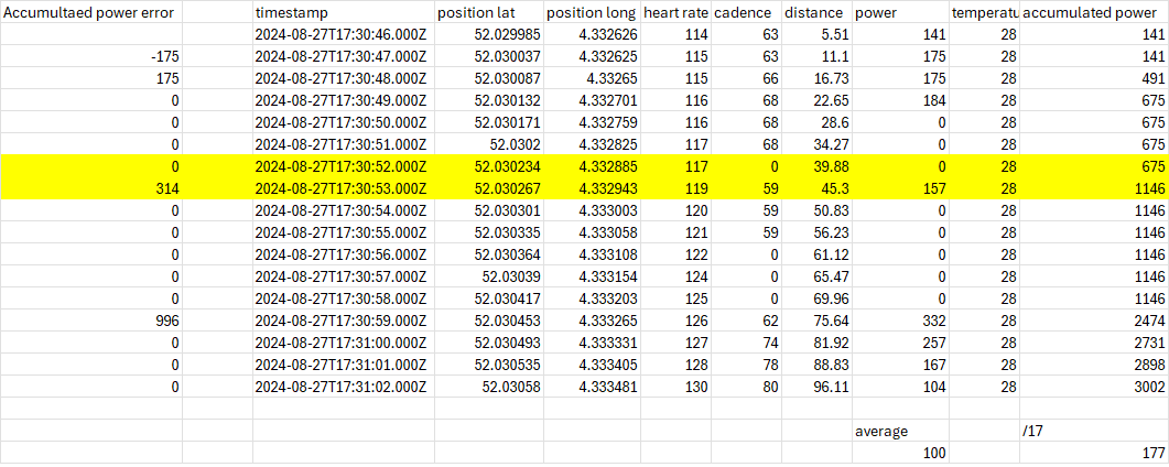

In the screenshot below (previously shared in the associated topic), you can see that when there is an error between power and accumulated power, the cadence data is also not transmitted and thus shows as zero.
My suggestion would be to smear out the error over the previous rows where cadence is zero, and replace the power values accordingly.
These corrected power values can then be handled the same way as the power values are now processed by intervals.icu.
Cadence = 0 automatically implies Power = 0.
So not sure if this is the correct way to go…
