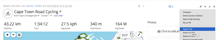

Garmin heavily restricts historical searches, so you will need to download that missed activity from Garmin Connect and upload it on the calendar page.

The number of activities created from Garmin on Intervals.icu looks normal so I don’t think many people are having issues. You need to download a fit file (comes in a zip) from Garmin Connect and upload that:
