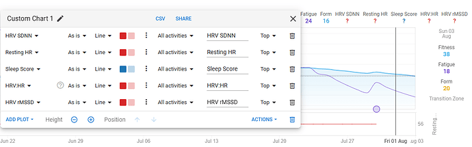

Hi. So I am trying to import my HRV and sleep data from Samsung health into Intervals.icu, but I cant get it to sync up.
I have tried both “FitnessSyncer” and “Health Sync”, they both say sync has gone fine, but the data doesn’t show up anywhere in Intervals.icu. The only thing I seem to get is Steps.
I’ve added a picture of how it’s set up in the chart, but as you can see I only get “?”.

Samsung Health doesn’t allow partner apps (such as Health Sync) to read HRV data. But sleep data should sync to Intervals.icu. If this doesn’t happen, please contact us at info@appyhapps.nl then we can look into it.
