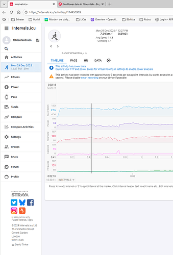

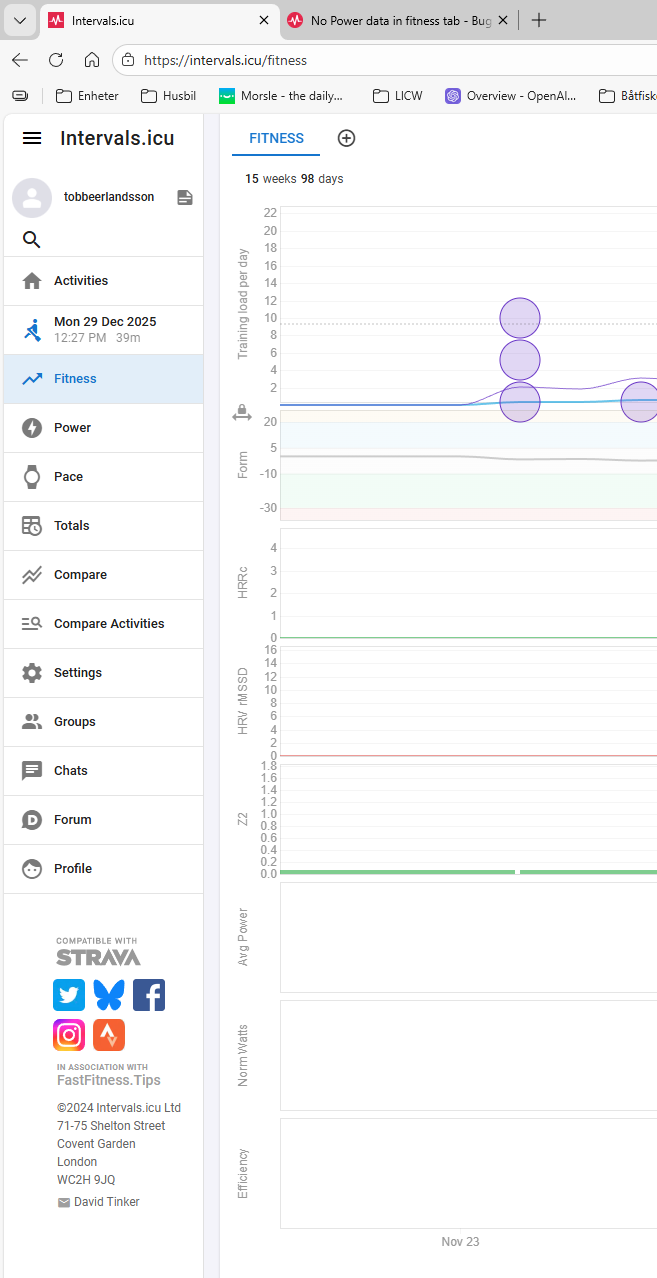

I have power data (in watt) for all my activities but I can not use that data in custom chart in the fitness tab. I can not trend a single thing related to power. Bit I can see the power trends in the “timeline” for each activity.
Is it a bug?

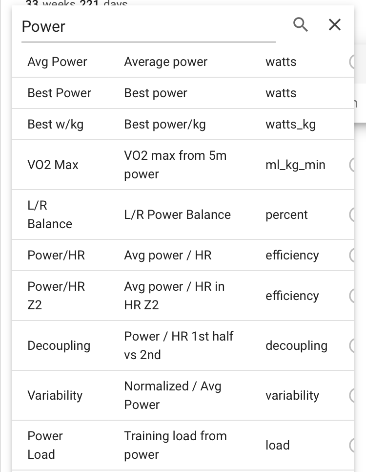

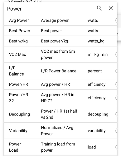

What do you want to show and what is not working? Please show screenshots if possible.
There are several metrics you can plot for power (not the full list)
Thank you for your reply!
Yes here are some examples.

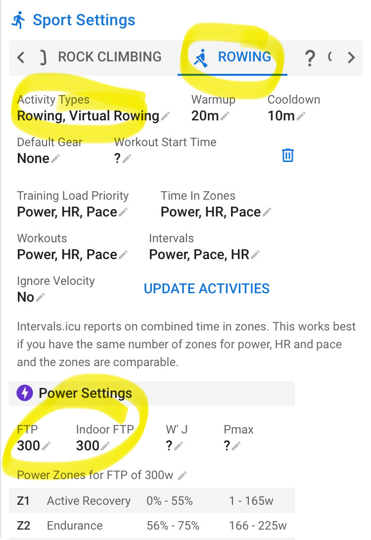

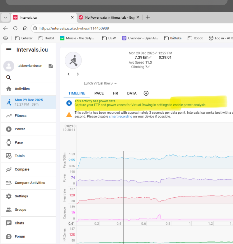

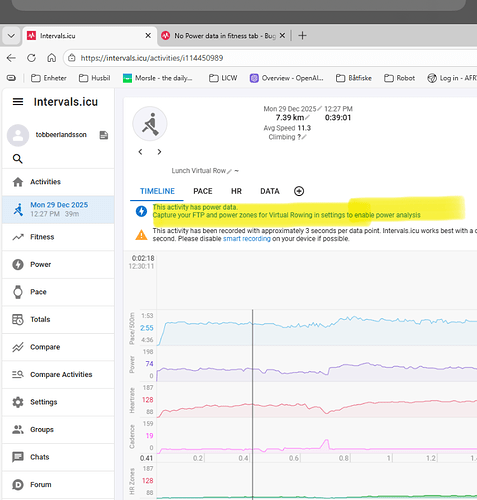

You have to set power zones in your settings.
I think you have to re analyse your activity afterwards (Actions > Analyze)
Hi! Thanks for your reply! I’ll test it, but will FTP affect any calculations in fitness or fatigue? Because it’s really just a pure guess. I can’t sustain anywhere near 300 W for an hour. I’m thinking that if you enter that data, it will affect the calculations, right?
I’m thinking that all power data is already in the activity, so it should be possible to calculate averages, normalization against HR, and so on, without using FTP values?
Or am I thinking about this the wrong way?
In any case, I’m very impressed by intervals.icu—what a great job you’ve done with this site, all of you who are involved!!
Yes it does. Just enter any value which might be your FTP. It doesn’t have to be an exact value. You also could change it afterwards, if it’s completely wrong.
Maybe it could. But it doesn’t. Time in zones, intensity and some others can’t be calculated. If no FTP value is saved, it will skip the power analysis, that’s why you don’t get any values on your fitness page.
Thank you for you help! I will try to set the FTP! :grinning_face:
