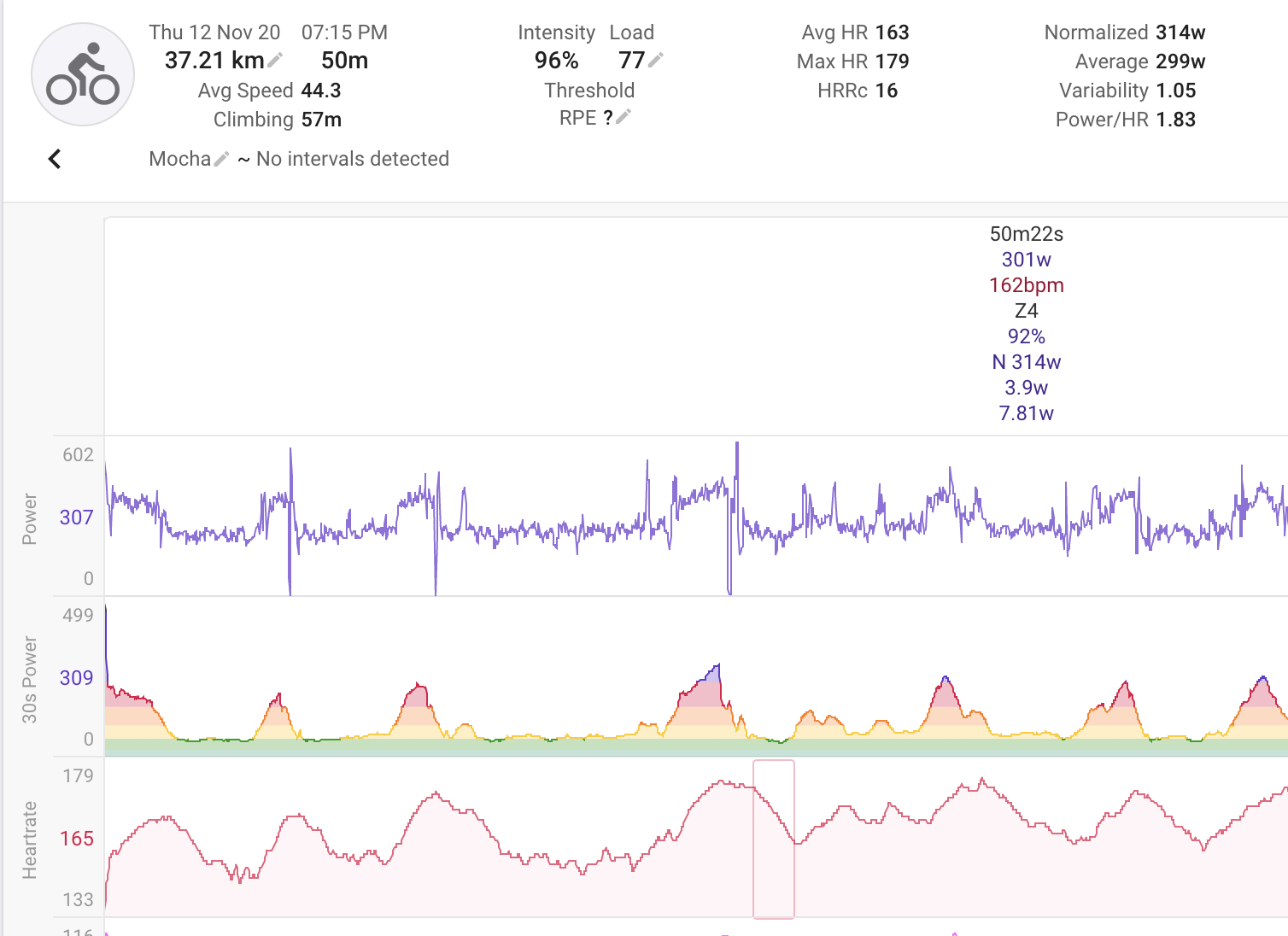

Since a week i dont get any intervals detected on my rides. See photo for example.
Not sure i it’s a bug or i did something wrong in the settings.
What to do?

Hmm. I am looking into this. Some ride just don’t have anything interesting in them but that one looks like it should have had intervals.
All the intervals in that ride are bumps with a ramp on either side and the detector just picks out the peak. These are then discarded because the power isn’t high enough for such a short interval. These are all heuristics to avoid finding all kinds of random efforts in a ride.
thanks for the clear explanation david. Too bad these wont show up as intervals, but i understand it.
