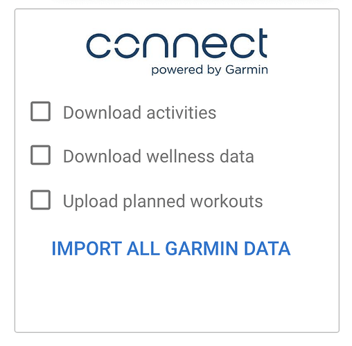

For Old activities - There is an option to BULK import. I believe this is option #3 below
But once you’re done w/ that, for normal day-to-day after that:

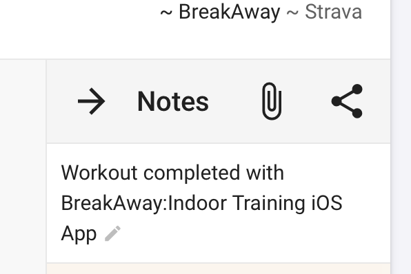

Intervals.icu also has dup checking mechanism and some of the duplicate checking mech as well. (Here’s a screenshot of a workout synced from Strava → Intervals and BreakAway → Intervals. They are “lumped” together) Note: I also have my Garmin recording as well (and data is sent to Strava also. Strava filters that activity out since I believe it flags that as a duplicate from my BreakAway App)

  • 1 Activity in Intervals.icu (it merges the activity pulled from Strava and directly uploaded from BreakAway)

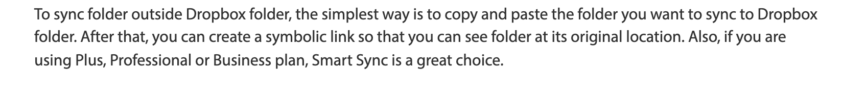

Depending on which virtual Ride apps you’re using, some of them has the option to sync the workouts to Dropbox? (For My BreakAway App, workouts are also uploaded to DropBox if you have it connected)
If on Zwift, (at least for the desktop version) the FIT files are stored somewhere in the computer and I guess you could always do an “alias” or “symlink” of sorts and have that folder linked to Dropbox. Then, you can just connect Dropbox To Intervals and you will bypass (of sorts) Strava.

One thing I noticed is that after doing the full history import from Garmin, none of the Garmin links back to original work. I’m guessing that’s because those activities came in via the archive import rather than direct sync with the website. So if that’s true, my next new ride should be able to sync to Garmin. Will drop a note if not.
Yes unfortunately that data is not present in the export so I can’t link back :frowning:
